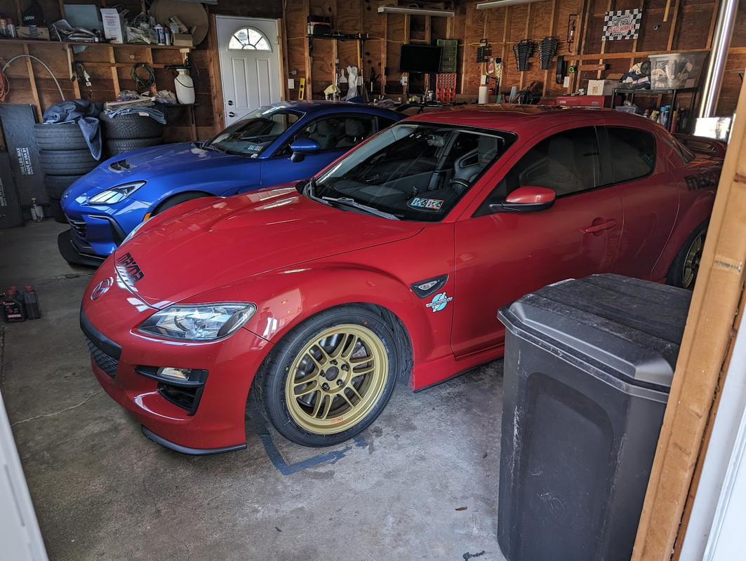

My wife bought my old RX-8 back, so my time will be a bit divided between two cars
