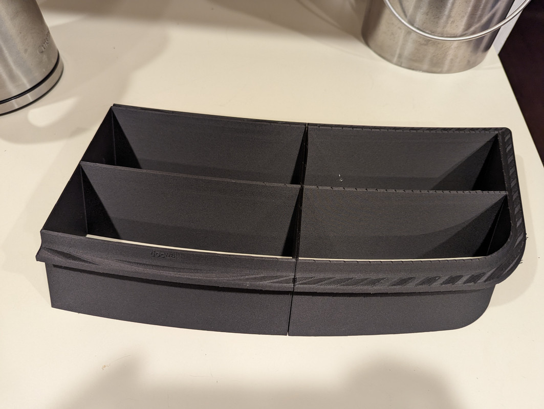

Finally got around to setting up my Ender 3 for Nylon 12 CF, first two thirds of the hood vent printed successfully so far.

Finished up printing my hood vent design in Nylon 12 CF, came out great! I need to bond the three pieces together and cut a hole in my hood now, haha. Chief inspector, Shelby, approved.

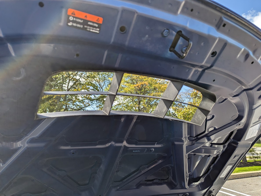

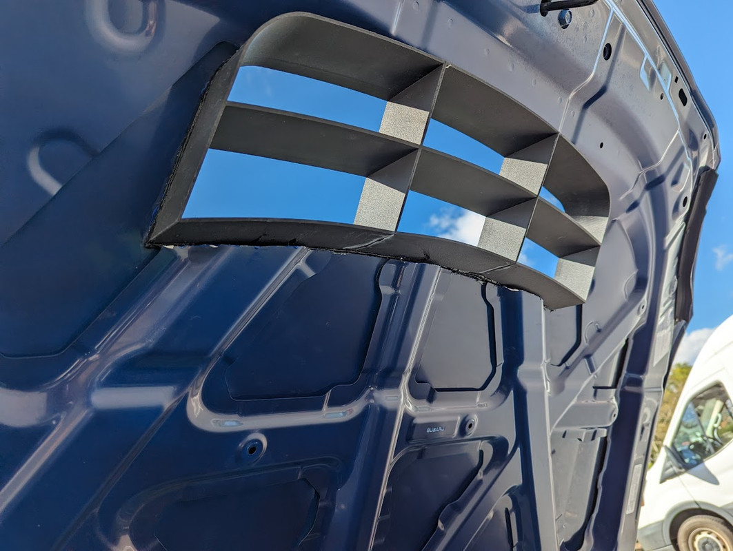

Installed my hood vent, I'll link the STLs below. I'm going to update to make sure they're NASA legal (3/8" proud of the hood is their limit) and fix the slight modeling error that lifted the rear corners ~1mm from the hood surface. Feel free to grab them whenever, I'll make an "OLD" folder when I update so it will be obvious.
If folks are interested in purchasing, I'll probably make a few in ASA and I'm going to work on a rain guard design too now that I have it on the car and know it's about perfect.

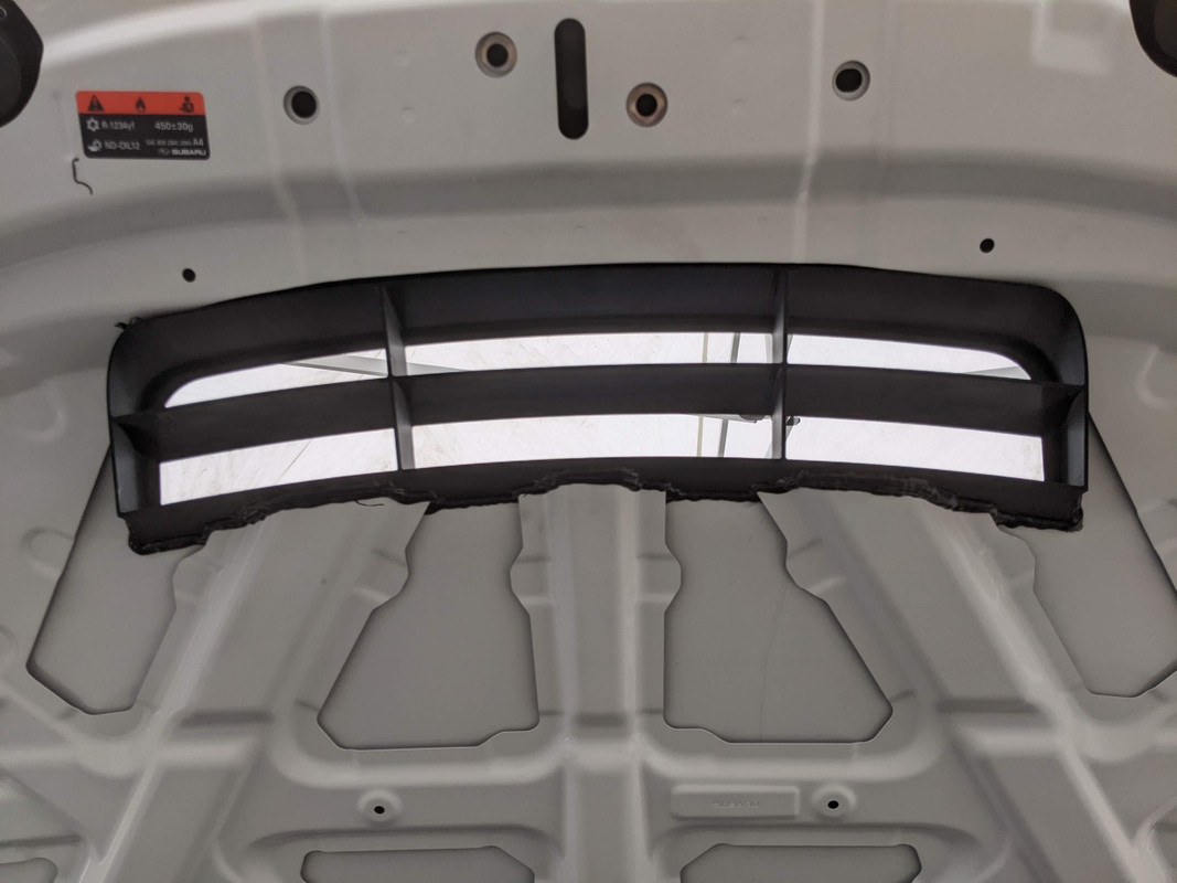

Originally Posted by dragoontwo View Post
Any pic of the underside surgery?
I'll grab one. Not 100% "done" there, I want to glue it up like Toyota did:
edit: added my own terrible pictures

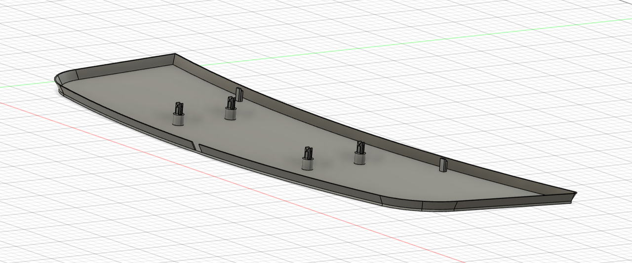

I do not own a 3d printer, but had a friend print something out of TPU for me.
We went with 0.033" thickness.
Been in and driven in coming since Monday.

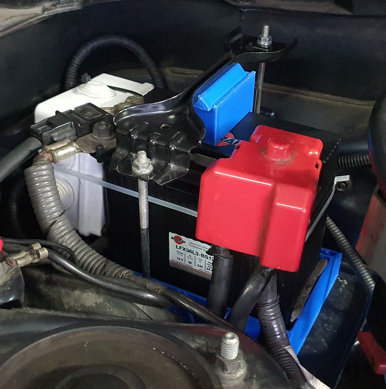

A battery adapter for Shorai LFX36L3-BS12.
https://www.thingiverse.com/thing:6266287
