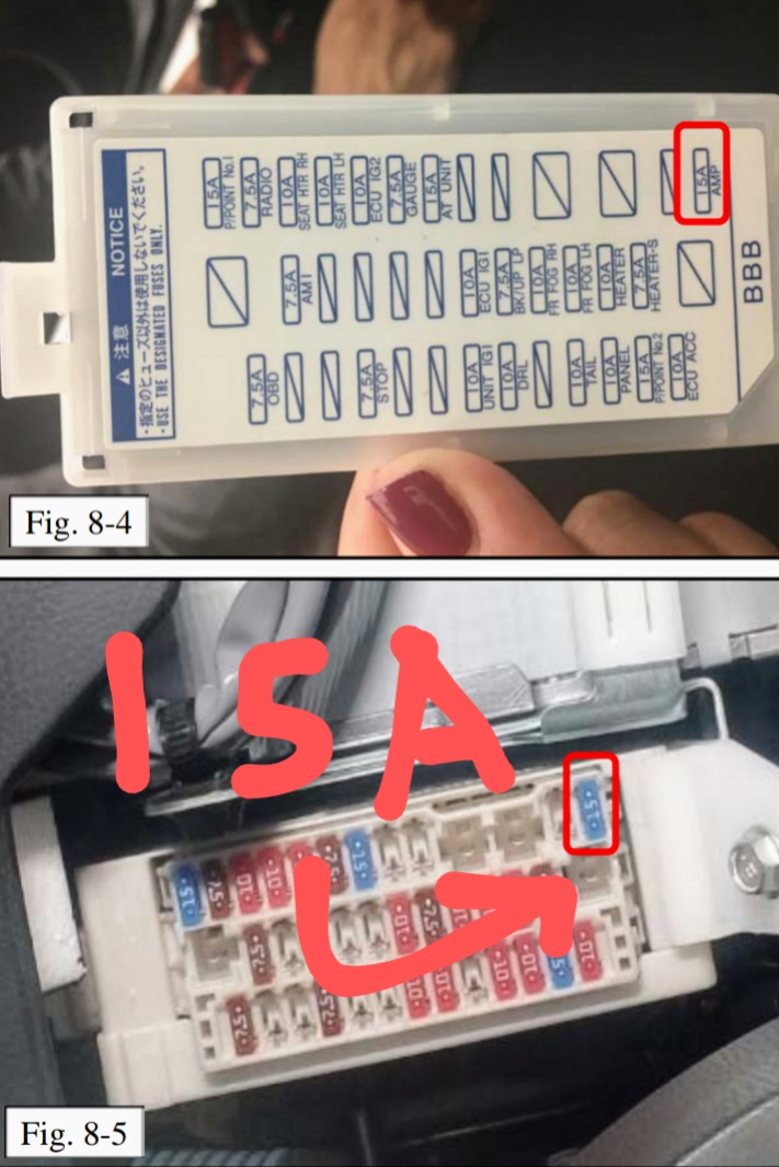

The stock power circuit for the OEM door speaker amp is only good for 15 amps of current, so you'll have to run a new heavier gauge fused (at the battery) power wire and equivalent ground wire to the cars' chassis for any other amplifier that you would want to install that has a fuse rating that is greater than 15 amps. This picture shows the fuse position in the cabin fuse panel under your dash:

I think you're confusing slaving with powering amplifiers in parallel. Slaving means using one speaker output terminal from one amp, wired to the positive terminal of a subwoofer (or combination of multiple voice coils, or multiple subwoofers depending on the desired configuration) then from the negative terminal of the subwoofer and back to one speaker output terminal on the second slave amp. The two amps must be of the same model and (normally) have their controls set exactly the same, depending on specific brands and specific models. Again, you need to consult the owner's manual for your specific amp. And ideally, you would want to make sure the power and grounding wires are of the same length and gauge so to avoid differences in voltage drops to each amplifier.
I think what you mean is wiring up your power, ground and turn-on leads in parallel for two different amplifiers. And that's fine, you can do that, but you must make sure your power and ground wires are of sufficient gauge and your fuses (the one(s) at the battery to protect the wire(s)) are of a sufficient amperage rating to safely allow the expected current flow through the circuit(s). 95% of the time, this means running new power circuits. It's just something you're going to have to do in order to achieve your goals here.
You don't have to upgrade the turn-on lead wire as the existing wire would be sufficient for several amps. Turn-on circuits for amplifiers normally draw only milliamps.

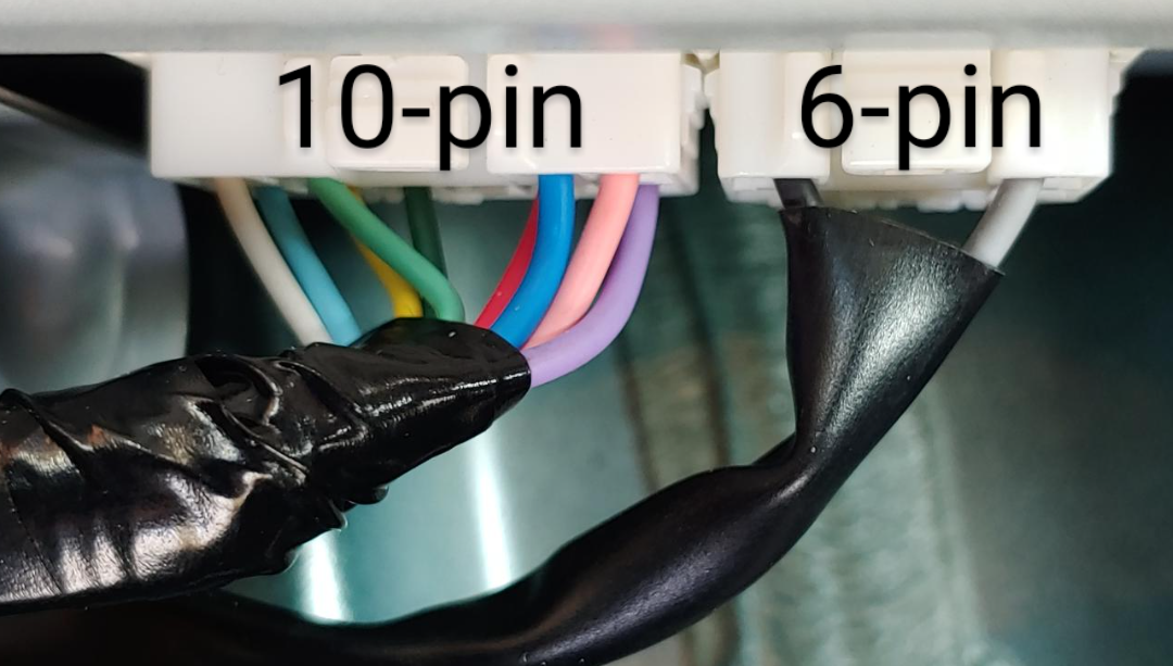

What you see here is a mock up of the FEMALE RECEPTACLE that the ten-pin MALE PLUG would plug into at the OEM door speaker amplifier. To further clarify, this harness would allow you to access the OEM wires, without having to cut or tap into the OEM wiring. These "reverse harnesses" are available from Metra, Scosche, and other suppliers. This particular harness has been altered by re-pinning and re-wiring in a way that matches the speaker inputs and outputs to how I am personally familiar with. You don't have to use a reverse harness, but it makes it a lot easier to keep track of what you're doing and keeps you from having to cut your stock wiring. The green and violet wires on the left side of this harness, you can ignore as those are the speaker outputs from the head unit acting as signal inputs to the OEM amp. For the best sound quality, you should be running RCA leads from the back of the Pioneer head unit to any aftermarket amplifiers you plan to install, which will carry the signal you're amplifying. The white and grey wires on the right side of this harness are the leads running to each door speaker from the output of the OEM amplifier. Using an ohmmeter, measuring from the positive lead of the white to the negative lead of the white, you should read about 2 ohms, that is your left side door speaker. You should get the same result measuring the grey leads, that should be your right side door speaker. You can use these leads to connect to your aftermarket amplifier outputs. The blue lead of the harness is the amplifier turn-on lead coming from the back of your Pioneer head unit and would normally turn on the OEM amifier. You can connect that blue lead to the turn-on terminal of any aftermarket amplifier. Note that your OEM ten-pin harness wiring colors will be different, but the pin positions will match what I describe above.
There is also a six-pin harness that plugs into the OEM door speaker amplifier. See here:
The six-pin harness has the constant power and ground wires for the OEM amp, but unless you're installing an aftermarket amplifier that has a fuse rating equal to or less than that of the OEM amplifier, you will not be able to use either of those two wires. If you do, you will most likely end up blowing that 15-amp fuse in the picture I showed you further up.
I hope I haven't further confused you. I did some searching the other day and found a four-channel amplifier that looks like it would be a pretty good match for your door speakers and looks to be within your price range. You could even connect your dash speakers to it on the second set of outputs if you want to fully amplify your entire front stage. Here it is:
