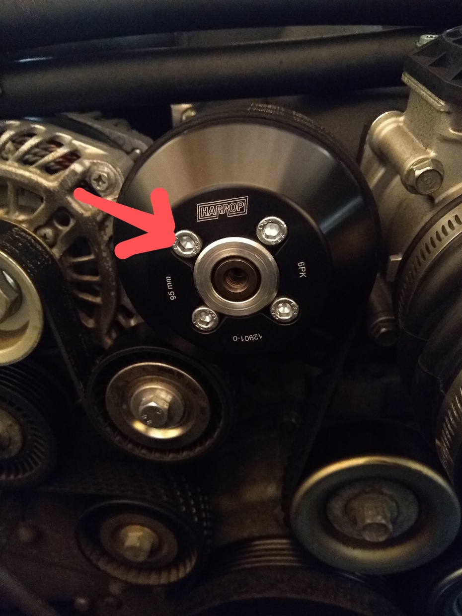

Anybody ever have issues trying to loosen the 5mm Allen head screws from the pulley hub? Mine don't seem to want to budge. Maybe Harrop used some LocTite on the threads? I'm afraid I might break an Allen key or worse, strip the hex head out on the screw. I'm thinking I might have to upgrade from an Allen key to a hex socket to get more torque on it, but I wanted to get some advice here first from someone that has changed one out already.

Follow-up from previous post:
Yes, I needed to step up to a 5mm hex bit socket, 3/8" drive, and yes, Harrop uses the blue LocTite on the threads. Had to run to the local hardware store to pick up both but the pulley change-out job is now complete.
Did you go down in pulley size?
Yes, swapped to the 85mm pulley. Currently logging and getting calibrations sent back to me by my tuner.
