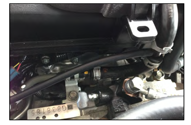

block the pressure source of the bypass valve so that inside remains closed (should be).. pinch it with your fingers
does it still whine?
also i d be curious for a video of engine bay while revving stationary

try to pinch the vacuum hose and see if it disappear when bypass valve is forced closed.. Name:  Screenshot 2023-03-28 092908.png

try to pinch the vacuum hose and see if it disappear when bypass valve is forced closed.. Attachment 219591
ok let me try that today, fingers crossed!
