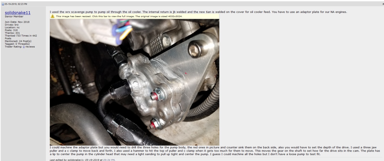

I found the AVO one, but they wanted $500 for the pump and plate when the pump is only $200. Reached out to PTuning and they're not willing to sell the parts separately.
DarkPira7e, Are you able to see what they did to modify the pump? I wonder it their plate is thin enough that it still engages, but it's obviously been chucked in a mill at some point bc the subaru logo as been taken off.

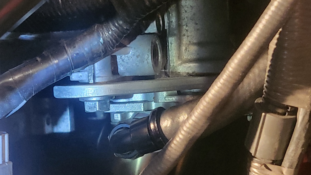

I'll hit it with the calipers and see. I just installed it Sunday, should've taken more photos of it turn apart. It didn't really look like much, if anything, had been done so I didn't consider it
EDIT: Also, I found SS11's post. I screenshotted in case he tries to yeet it
Thanks for finding that! I remember coming across that at some point, too. I enjoyed going through your build thread, I'm glad I'm trying to go this direction first instead of making an electric pump work. I feel like a mechanical OE pump is going to be more reliable, as well as not having to dump into the pan.

Plate is 6mm thick

Ahhh perfect! I was starting to wonder if that's what was machined when I was looking at one of the pics, thanks for verifying that!
I even asked PTuning if they'd sell me just those two parts, they said no. They also said "by the way, you'll need to modify the pump" and wouldn't go into any further detail So that's what started me down this rabbit hole. Now to find a machinist!
