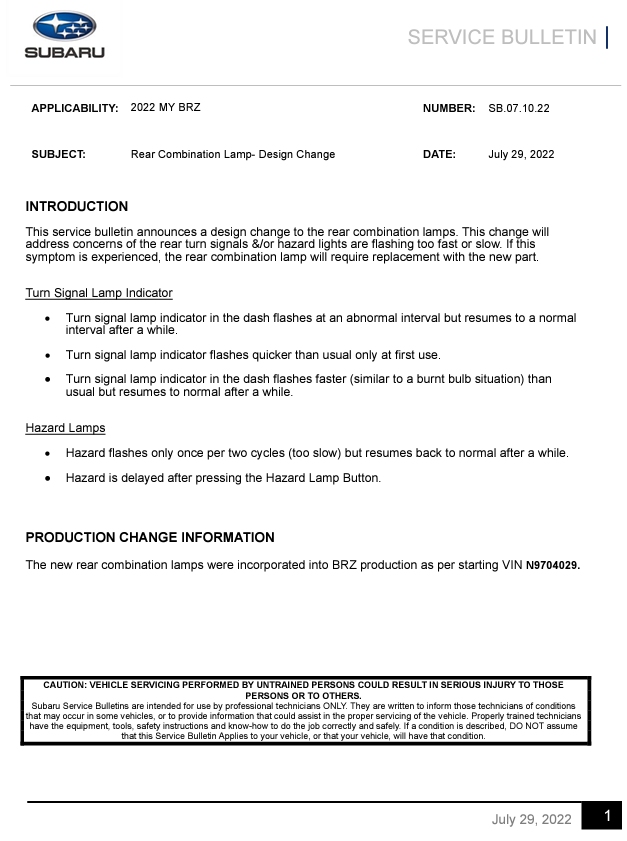

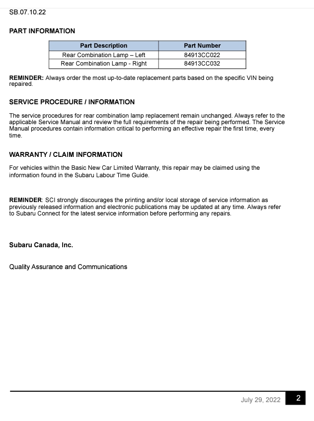

Well, someone says this exists. New part numbers for the rear lights.
Xed32 is offline   Reply With Quote
