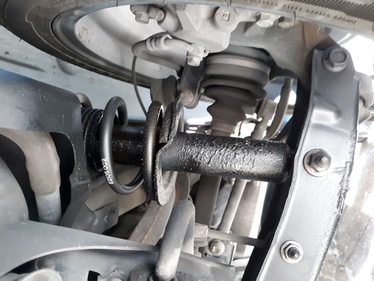

I recently had my FR-S on jackstands waiting for clutch parts and had to drive the old GTI. I noticed the right rear wheel making a banging noise when I hit bumps. The car's old and I didn't want to deal with it so I just ignored it.
Got the FR-S fixed and started driving it again and it had the same noise as the GTI. WTF? Am I imagining it? Took a look under the car and saw this:
What a coincidence! At least it should be an easy fix.

Bought some almost new 2019 brz dampers, much better damping than the 2013, but after 6 months one of them at the back looks like yours :/

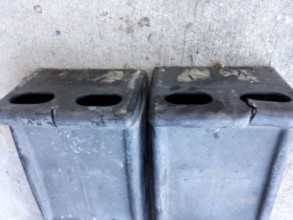

Here's what my ramps look like after the fall. The pinch welds cut through them like butter.

Yeah I have the Eibach Pro-Kit. Made changing the shock a lot easier because the spring doesn't need to be compressed. The job was easy but it could have been easier if I had half a brain and degreased the strut first. But if I had half a brain I wouldn't have blown the shock in the first place.
I just removed the two nuts inside the car, then removed these two bolts and the other one to the left that holds the suspension arm to the car. I also removed the bolt holding the shock to the arm but you don't need to. Then remove the whole assembly.
