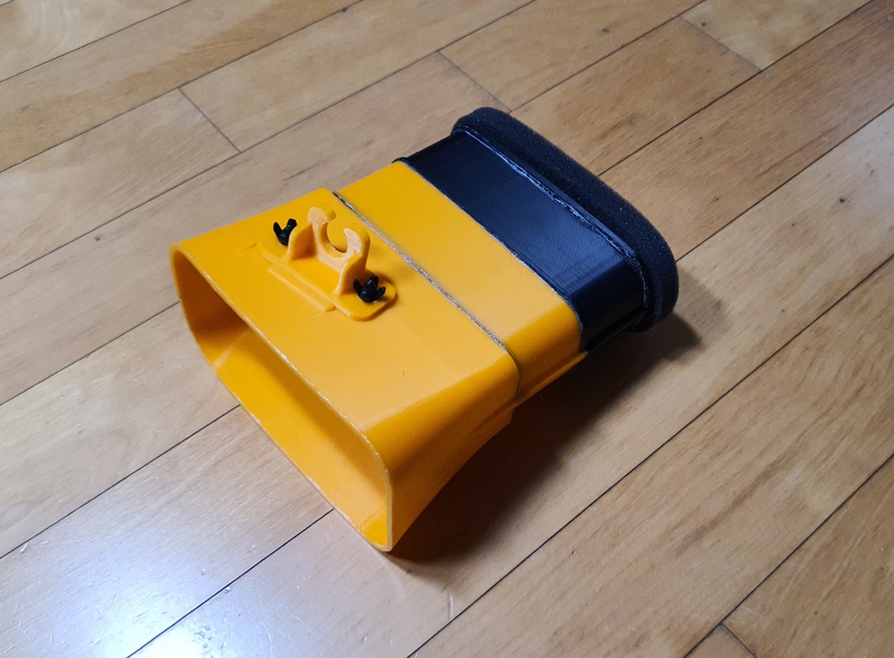

Nowadays I use this printed snorkel that is similar to the HKS one. But snorkels are before the resonator in the intake path.

I just would like to emphasize that a major tuning parts company like Apexi did try the same thing.
Attachment 218029
https://www.apexi-usa.com/products/i...-86-subaru-brz
Where i can find that one?
Attachment 218029
I saw your post in the other forum where you were seeing increased load from midrange RPMs onwards without any loss on the low end; that technically proves the snorkels can present gains without any drawbacks. Was that graph before or after AVCS tuning?
I have someone who is also trying out a new snorkel - similar to the HKS intake duct V2 to test as a prototype.
It's after AVCS tuning for the non-bellmouth snorkel. But it is not the stock vs short one comparison.
