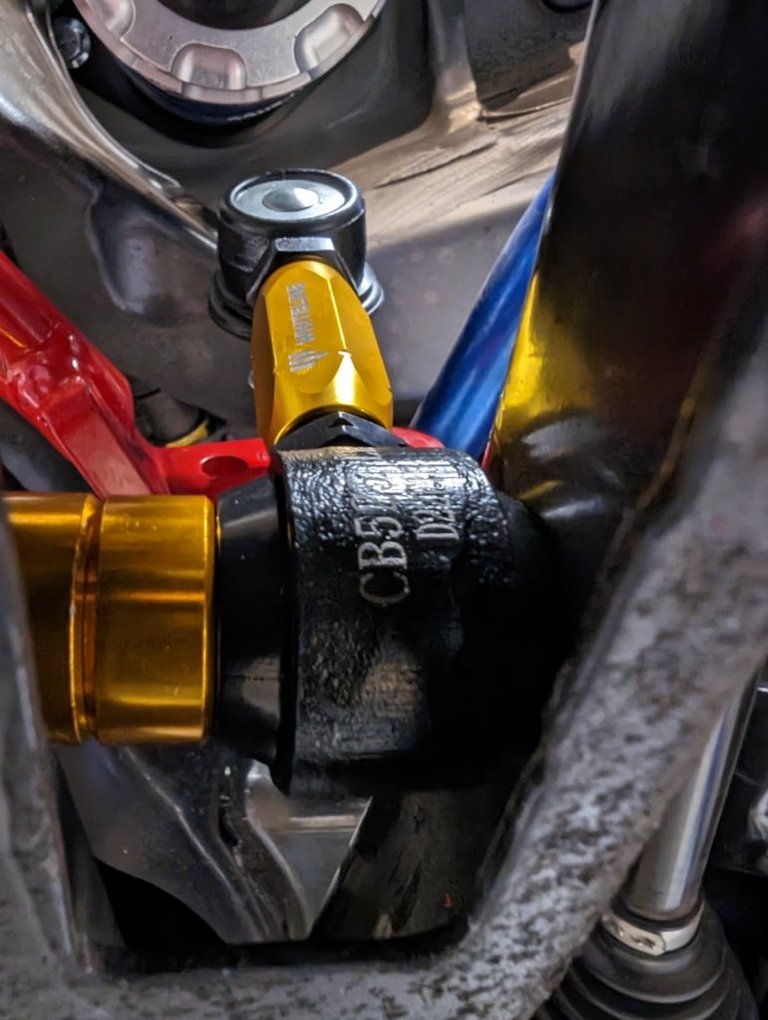

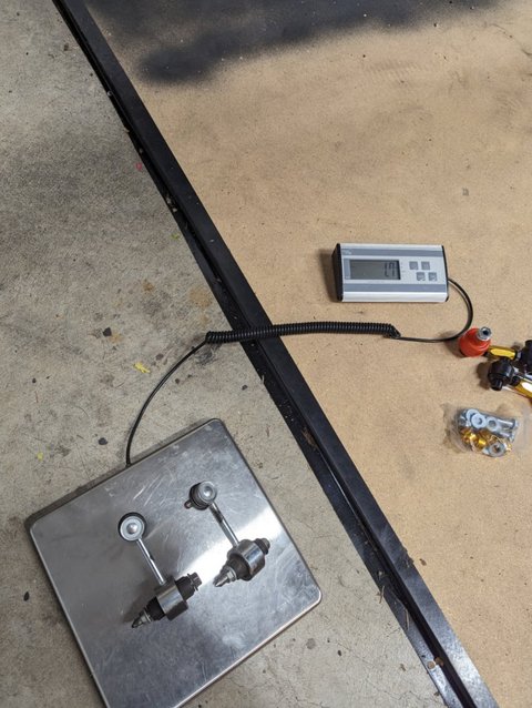

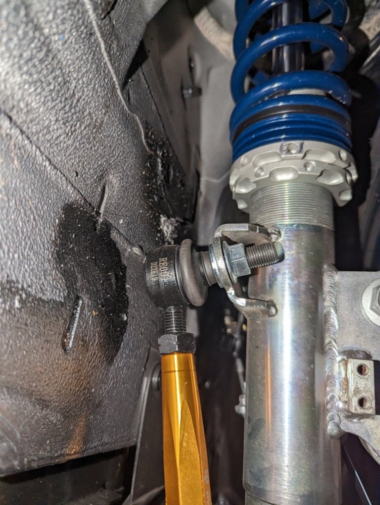

The aftermarket sway bar holes are way off what the OEM endlink is designed for, and I'd have to severely load up the endlink in order for it to just fit. I obviously didn't like the idea, and ordered whiteline end links for $114 shipped; not bad. They arrived today!

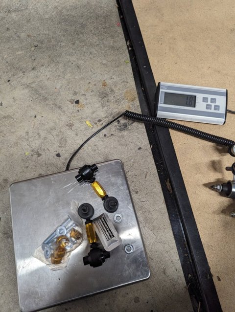

The adjustable whitelines are about same weight as OEM; 1.8 lb vs 1.7 lb.
Whiteline end links allow you to offset the link to the left, center, or right; great! Even so, Perrin's third (softest) hole was way off the endlink. I'd have to far extend the endlink to make it not pre-loaded, which would like be beyond its intended adjustment range. Alas, I've decided to use the second hole on the bar.
With endlink offset right most, the mid hole aligns nicely.
I was feeling a bit of resistance in T2 over the weekend. The rear sway bar should also help with this a little bit, but we'll see. If I still have this issue, I might consider upping the spring rates from 450/550 to 500/600 or 550/650 lb/in.

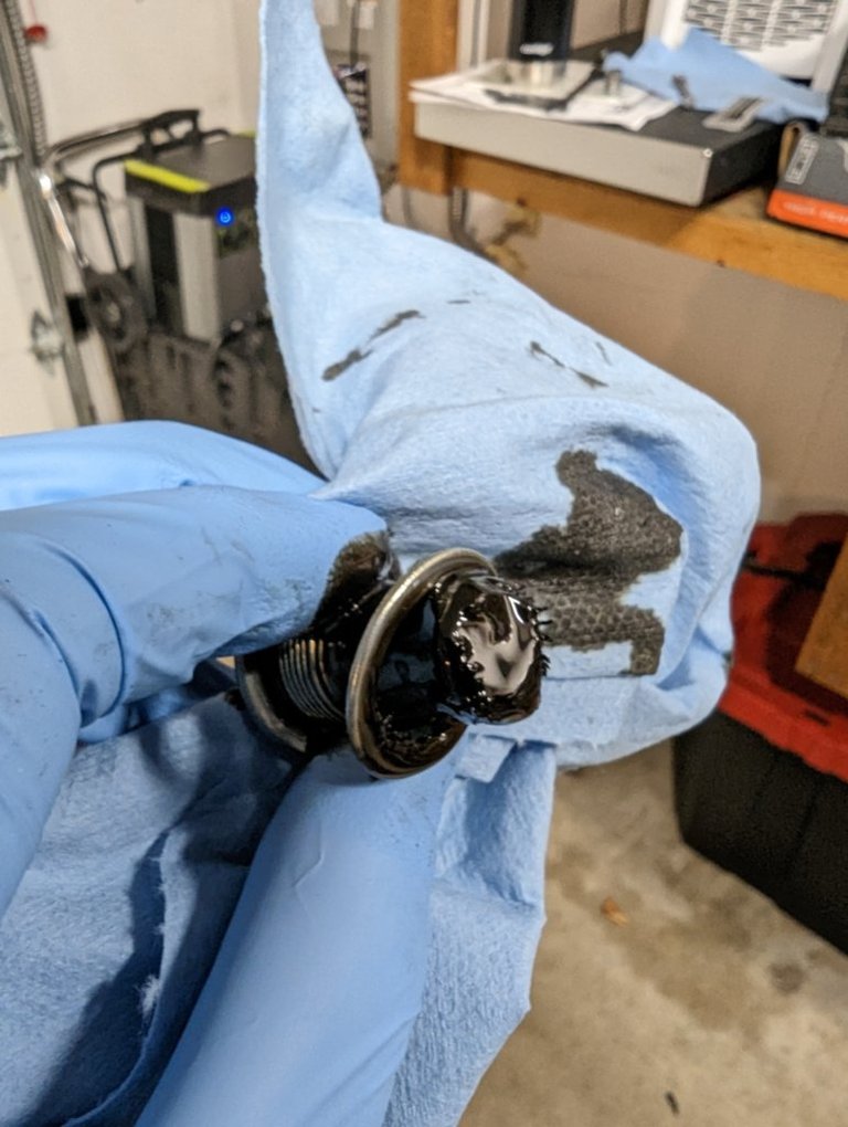

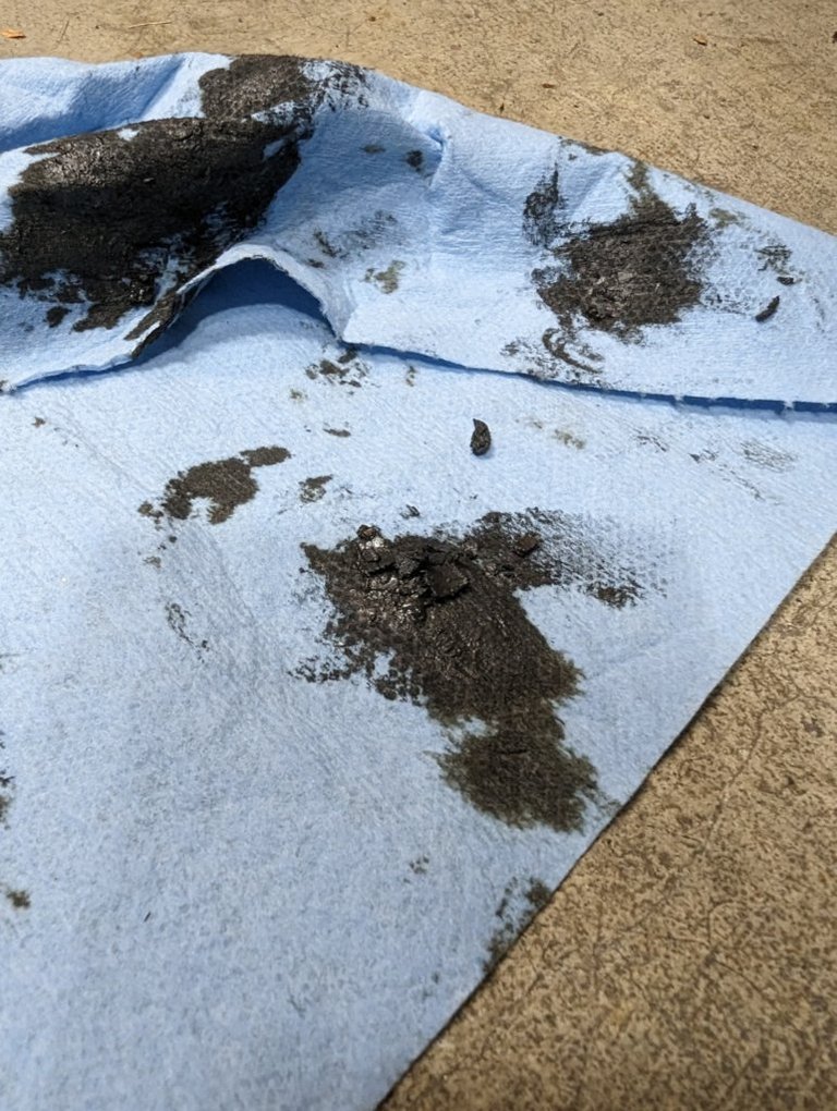

The differential fluid was very stinky, and the plug had so much stuff on it. It was so stinky that my wife asked me to open garage doors since it "stinks the house".
It was pretty hardened sludge. I'm thinking about replacing diff fluid again in a short interval for cleaning up the rest of the sludge that I probably couldn't remove. I've used Amsoil 75W-110 Severe gear LSD, which should also work better in high temps.

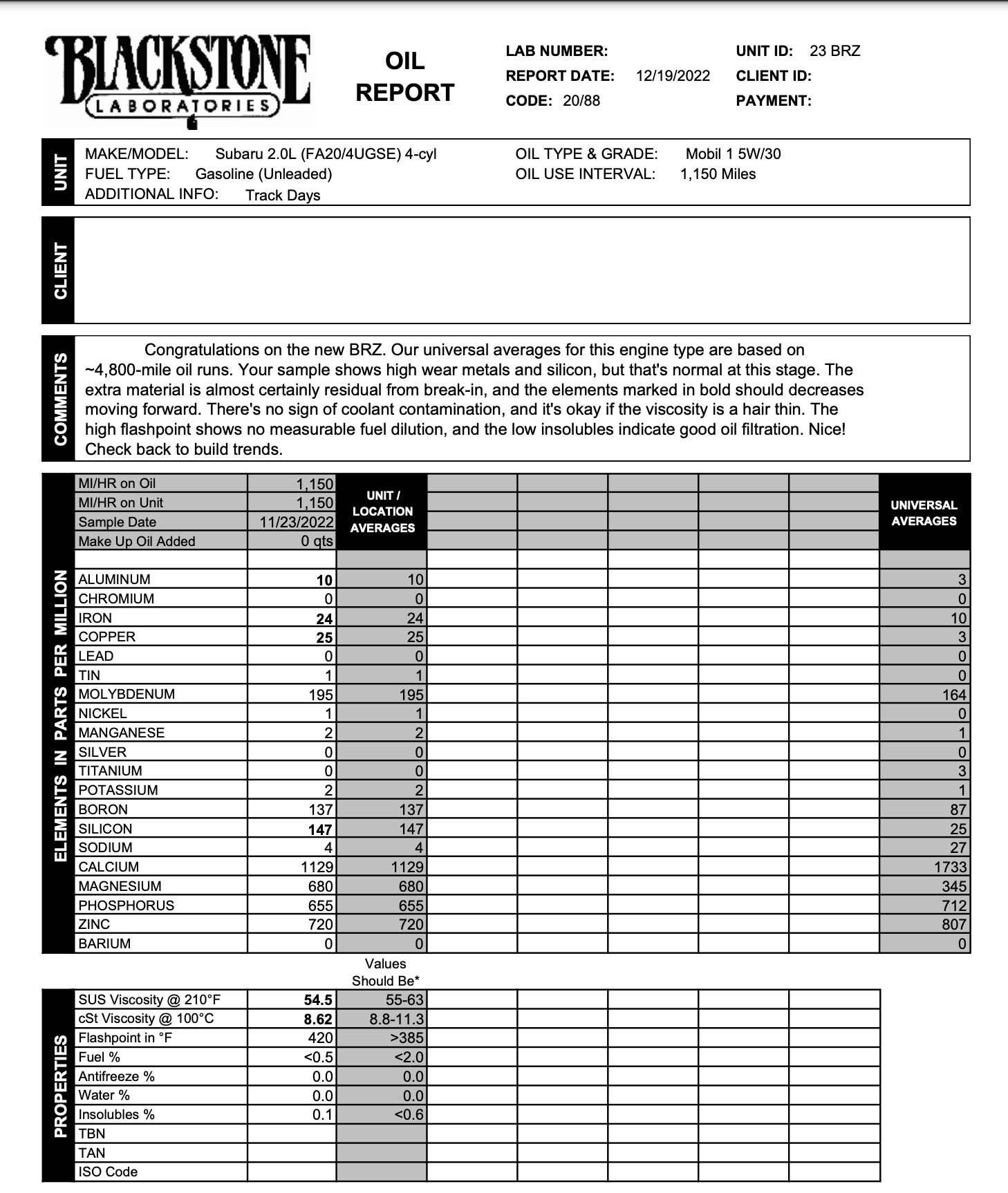

Got my first oil report. It's actually the last 1150 miles of 1500 miles total, but oh well, I suppose they mis-wrote it. Anyhow:
I'll send another sample after a few thousand miles.

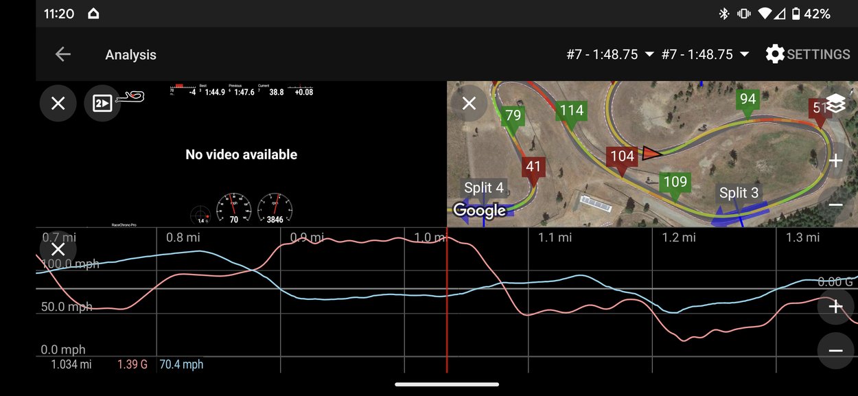

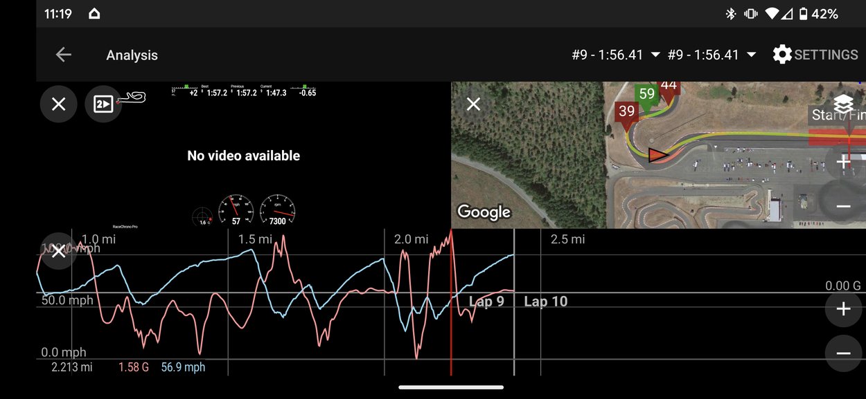

Originally Posted by nissanfanatic View Post
Nice build and thank for posting all the info! I will probably follow a similar path with the Brey-Krause bar. Did you order direct from them?
Would you happen to know what sustained gee's are on your fast laps? Or have an export (vbo if possible) of the data? Not sure if you've come across this thread where we have been discussing oil pressure drops during cornering, but your car would be a great candidate since it's on much higher grip tires than other cars that have posted data. Even more so since you are doing and plan to continue to do UOA.

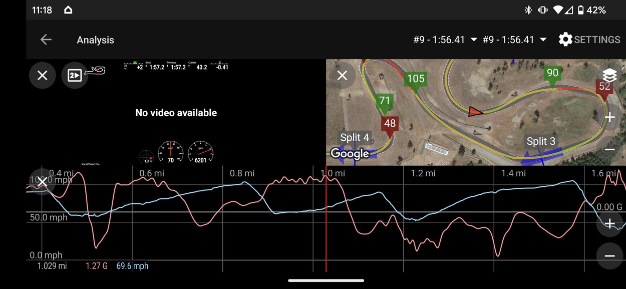

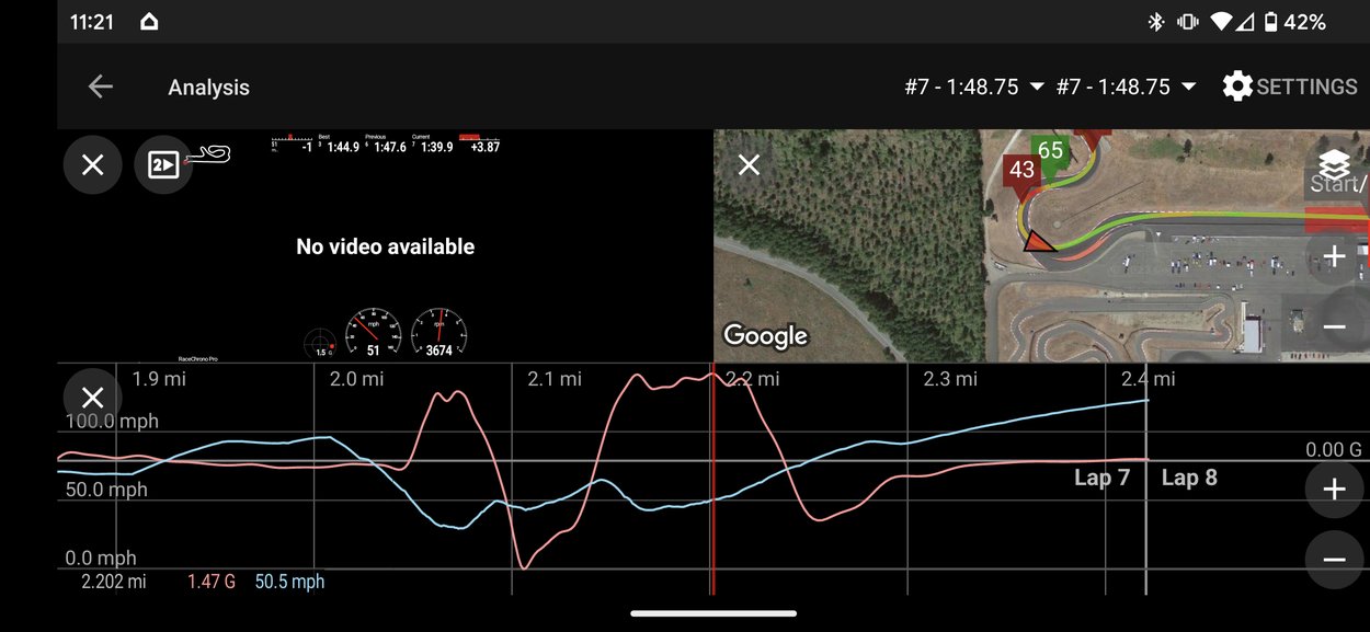

FYI, I use 818GT BT GPS transponder - the only one I've used that doesn't mess up this data.
Took a look at data on BRZ and C7 Z06.
Top is BRZ, bottom is Z06. I presume the most important corners where you might have this issue is long sweepers where the engine doesn't get to recover from it in a long time, so that would be the carousel at this local track. Corvette is pretty consistent, topping around 1.39G, while BRZ is a bit more wavy (when graph is at same scale), topping at 1.27G or so.
Top is BRZ, bottom is Z06. This is where BRZ peaked at around 1.6G. C7 also peaks at around 1.60-1.65G actually, but it was at a different corner. I think I probably slided the rear of the BRZ, and it generated that high G for a short instance when the rear finally 'settled' : ) The average Gs look similar.
Going back to your question, I think the Gs that we should care about is at 1.4G or so in my experience, at least at this track. Focus on long sweepers, and the engines are usually more vulnerable in one direction as well (left sweeper like GM V8s, or right sweepers, or both?). EDIT: just checked on that thread, and looks like there were issues at quick sweepers? Himm perhaps we should put in a baffle (if pickup is having hard time sucking oil). That's probably oil sloshing around in the pan, and not necessarily tied as much to high Gs in a way..
Thanks for grabbing that data!
This post has some follow on testing and a side by side video of a car with a baffle. tldr - baffle didn't seem to help much, and it isn't necessarily transition causing slosh. It is pretty consistent in hard right hand corners.
The lateral acceleration your car is seeing _should_ be causing orders of magnitude more starvation if it is, in fact, starvation related to lateral acceleration. I still have my doubts on that, but nothing that I could back up with a rational explanation.
A logging setup on your car would be amazing, but even that never happens my original thought with getting some data on your car is if your car is surviving, then I personally am not too worried that the drop is anything other than an observation at this point. If the car survives well enough and always returns good UOA, then w/e with the drop lol. It probably happens way more often than people are aware, but most of us don't have a sensor/gauge, or a gauge that is sampling frequently enough to spot it.
