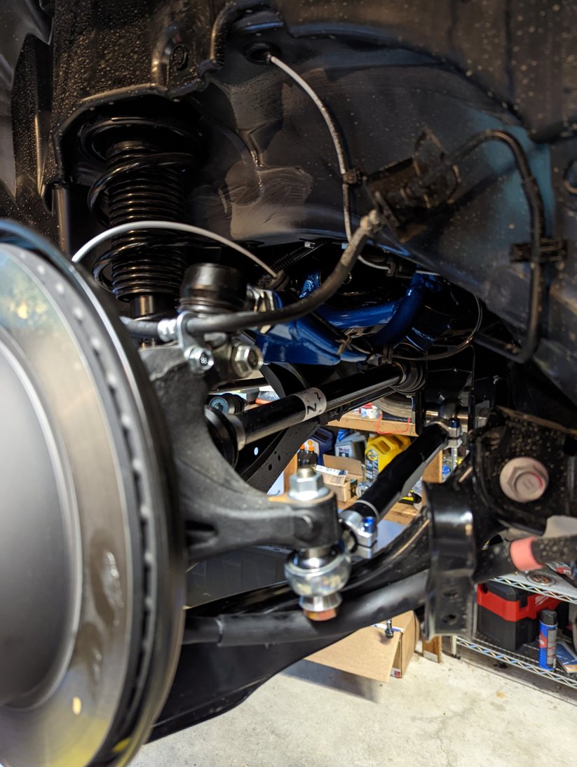

10/13/2022; post coilover install + alignment (12.875" front, 13.125" rear). Stock is about 14.5" front, 14.75" rear.

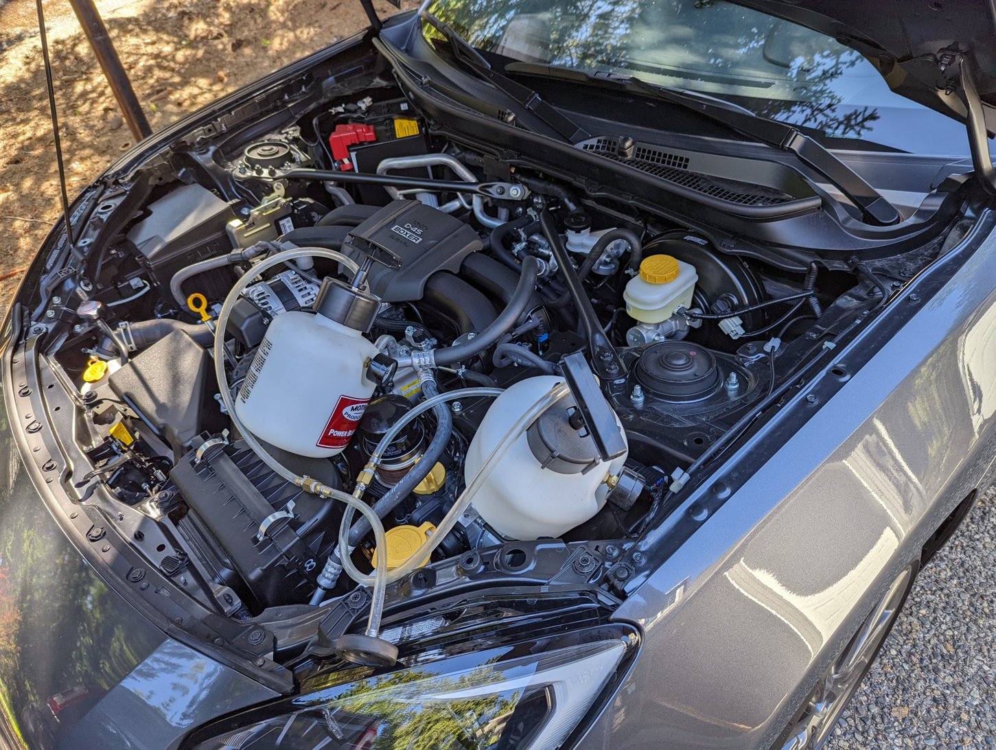

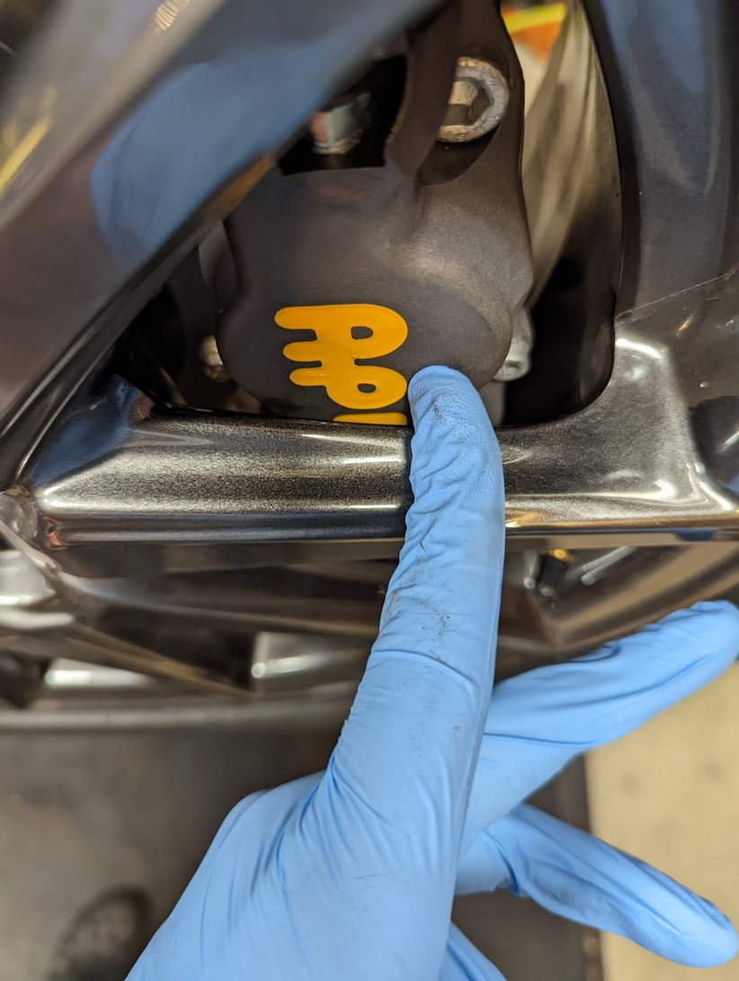

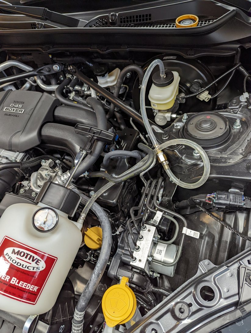

Realized on Saturday that none of my Motive bleeders work.
https://thumbnails-photos.amazon.com...Fh-iYJiH0THNlx
The correct one is 1107. It's a bit finicky, though. Once it starts going down, you should not twist it more than 1/8 turn, or it gets stuck. I had to remove it using plyers during my first trial!

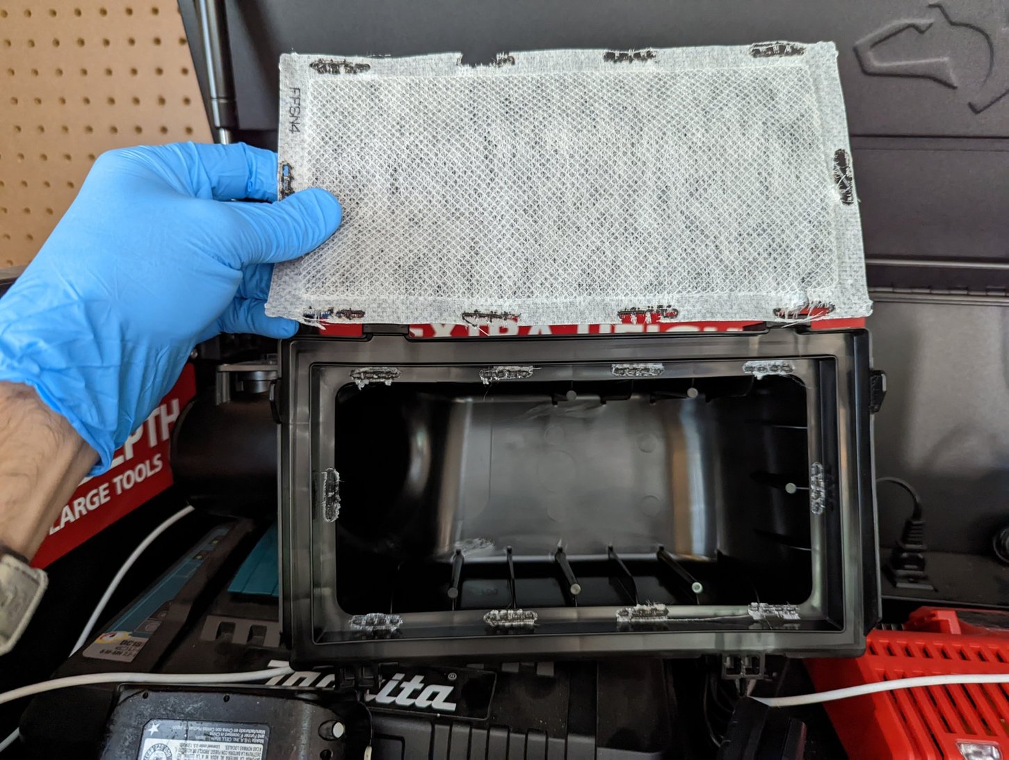

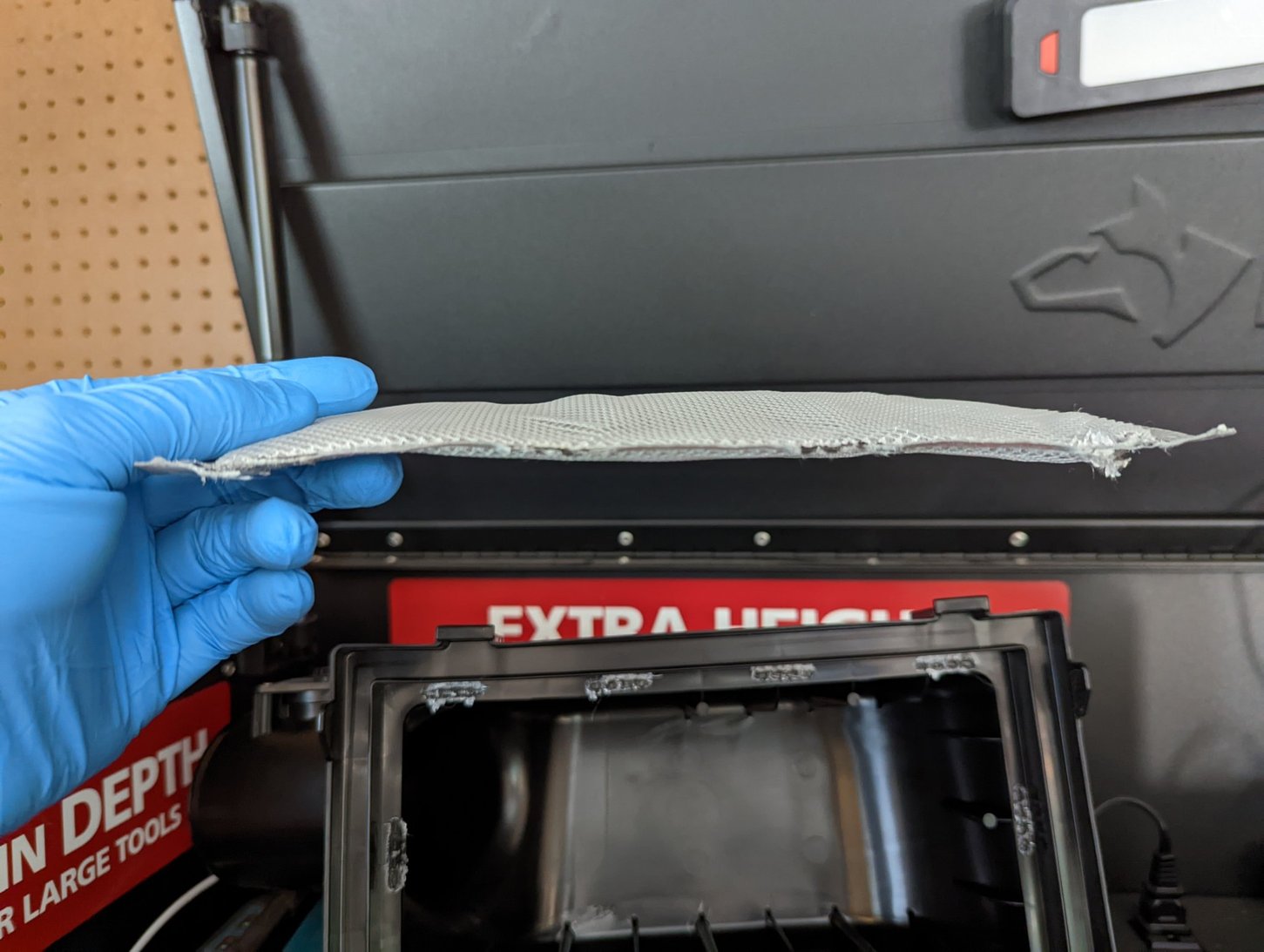

Removed the charcoal filter. It's thicker than I thought.

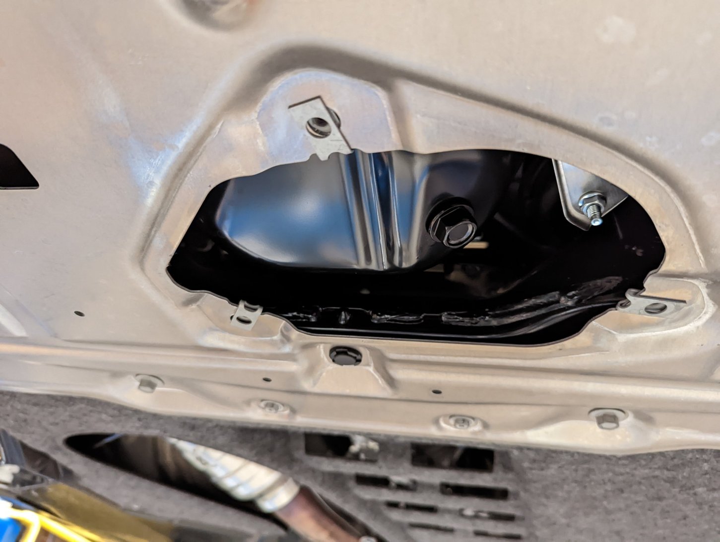

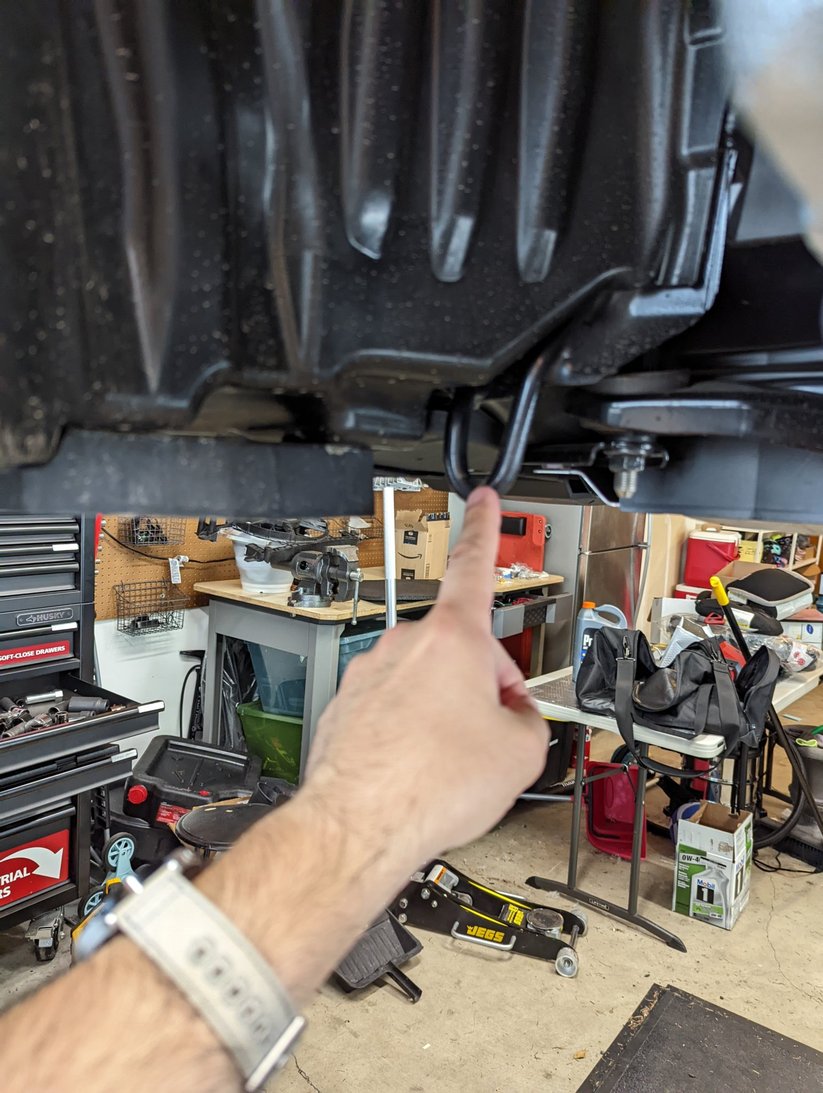

I'm guessing these are strap rings used during the transportation of the cars? Anyway, I wonder if I can use them as well on the trailer..

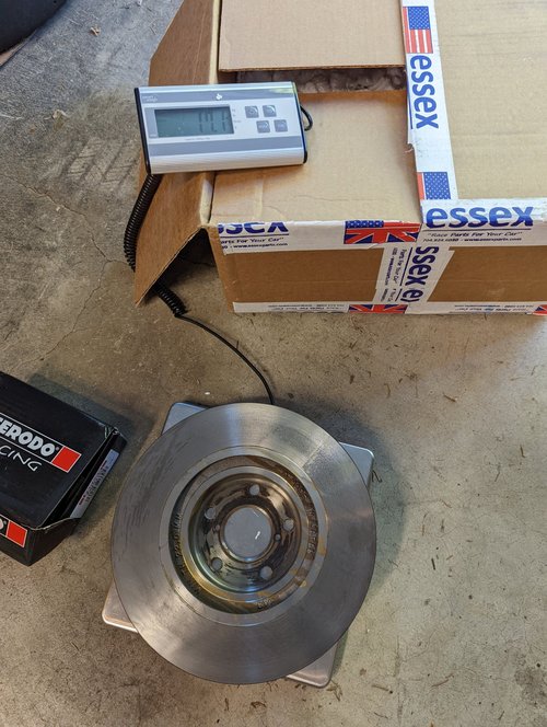

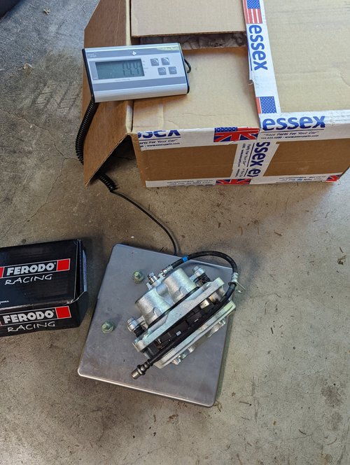

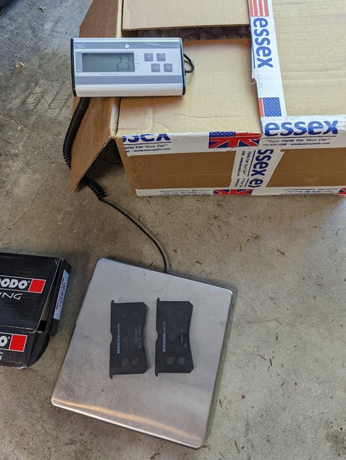

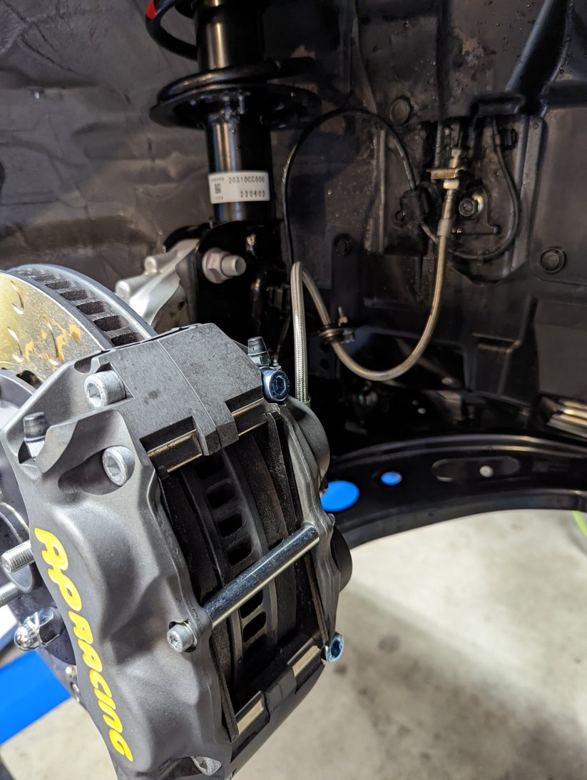

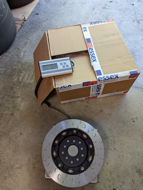

325mm 2-piece AP rotors are 16.4 lbs. OEM are 17.1 lbs.
https://thumbnails-photos.amazon.com...Fh-iYJiH0THNlxhttps://thumbnails-photos.amazon.com...Fh-iYJiH0THNlxhttps://thumbnails-photos.amazon.com...Fh-iYJiH0THNlxhttps://thumbnails-photos.amazon.com...Fh-iYJiH0THNlx

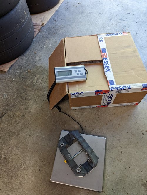

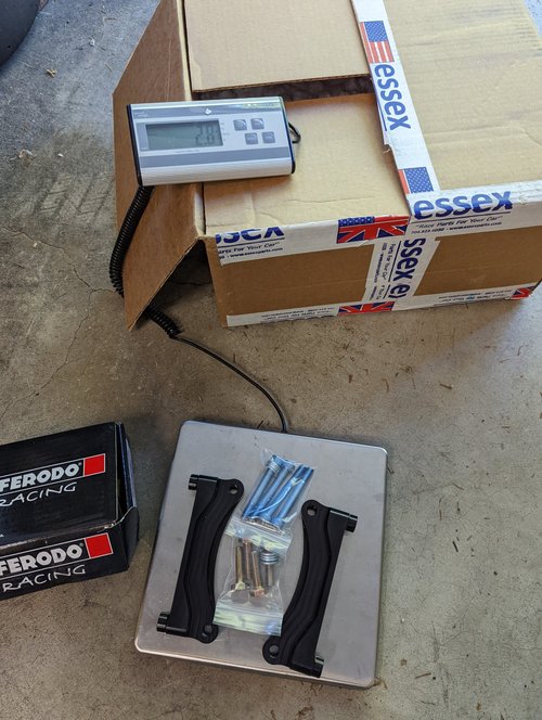

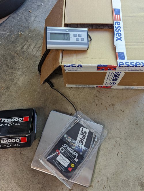

AP Caliper is 4.9 lbs, pads are 2.3 lbs, mounting hardware per side is 1.4 lbs, and SS lines are 0.2 lbs; 8.8 lbs.
OEM calipers with all hardware and lines are 14.4 lbs each.
TOTAL system:
OEM: 31.5 lbs
AP 325mm: 25.2 lbs (6.3 lbs lighter per side)

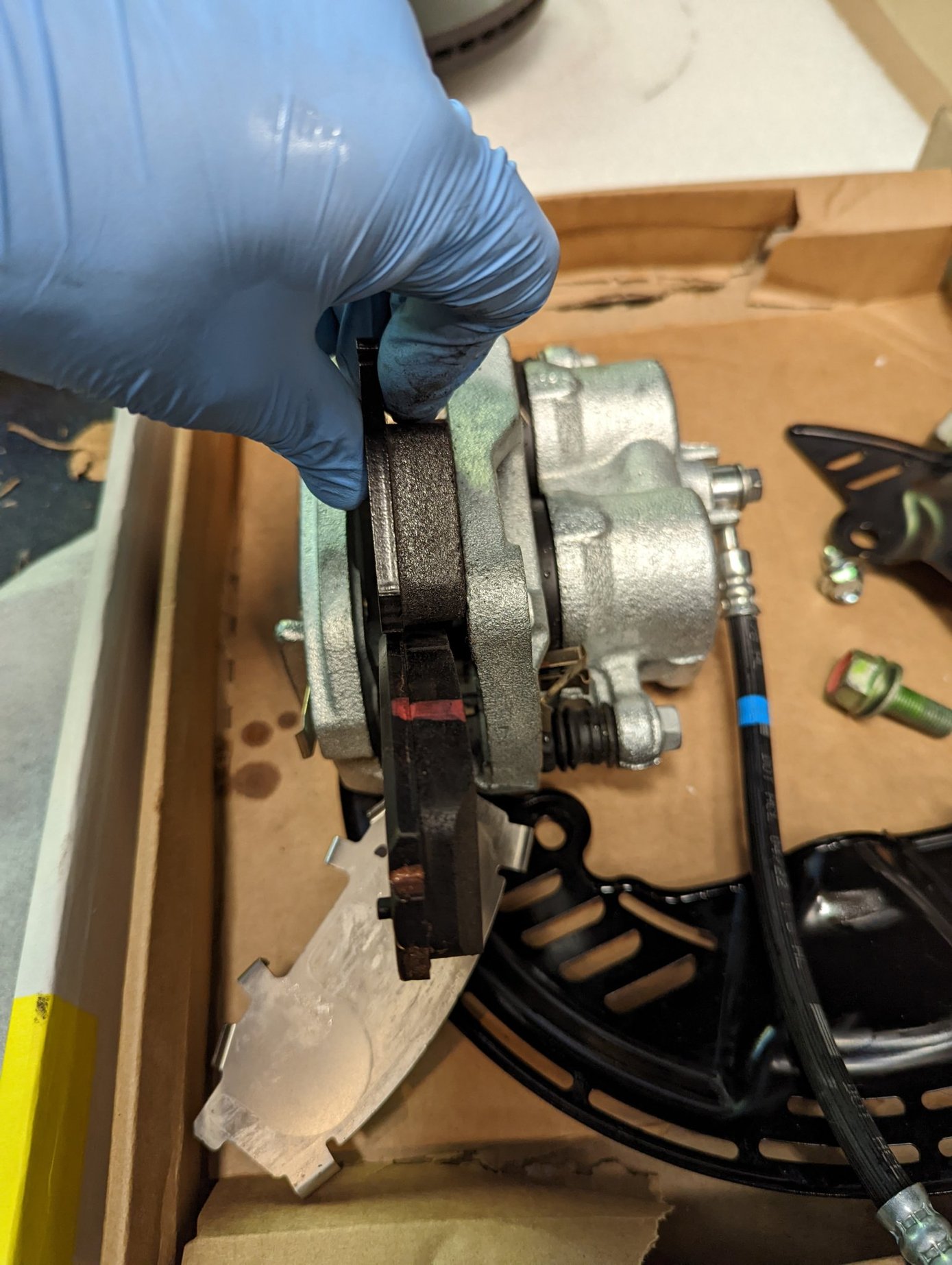

It's a bit hard to see, but Ferodo front pad is at the top, and the OEM pad is at the bottom.

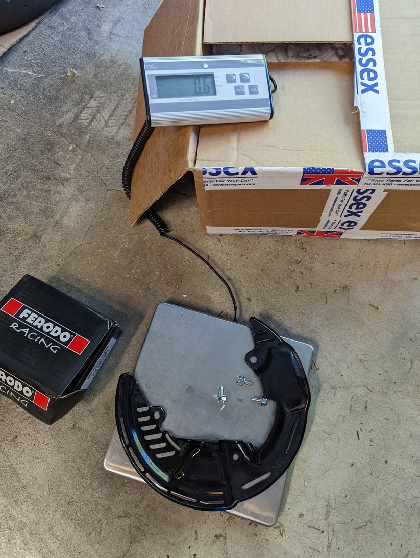

Dropping another 1.2 lbs unsprung weight with the dust shield delete (as recommended by AP racing instructions).
Finished!!

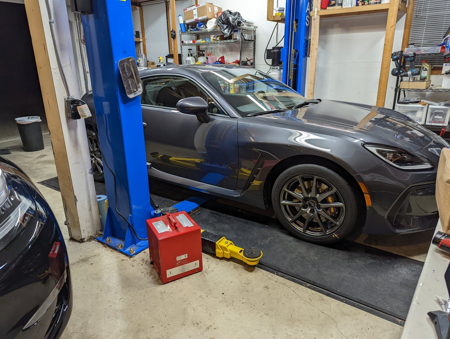

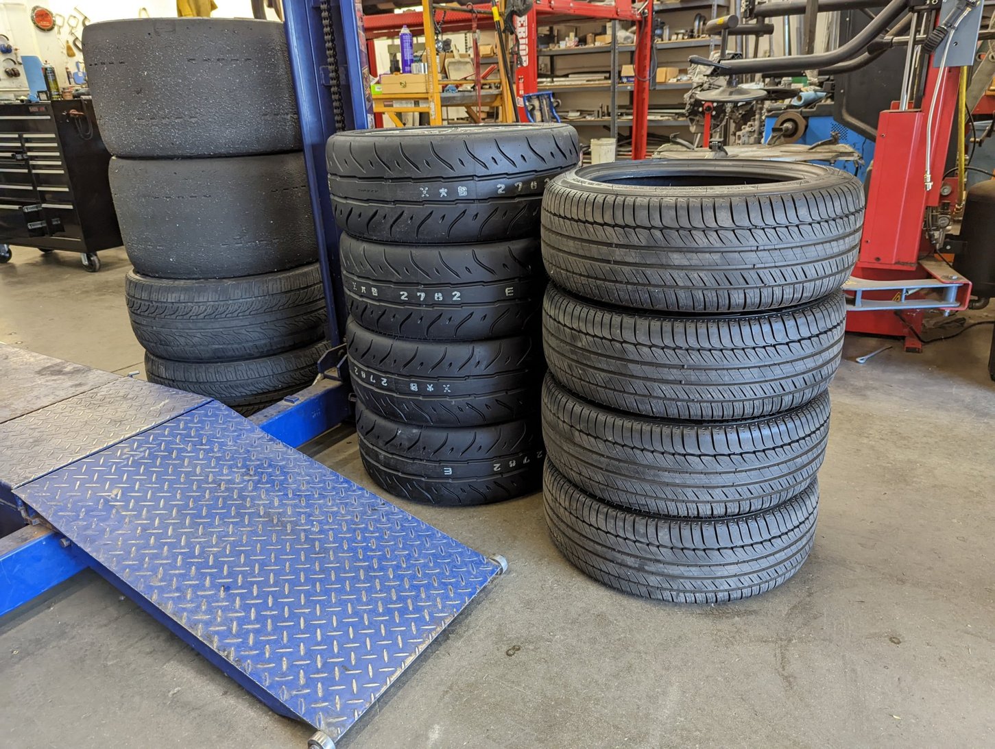

X25 08-02-2022 04:31 AM
... and I'm ready for the alignment, and first track day event!!

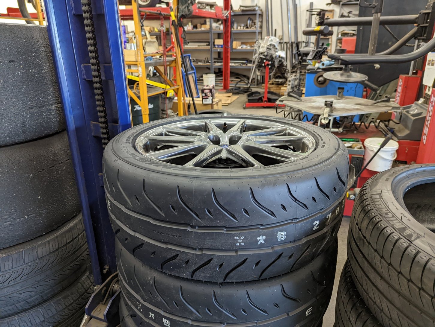

OEM unmounted tires on the right, and RT660 225/45/17 tires mounted on OEM wheels on the left.
It looks pretty flush with OEM wheels and Falken's 225s.

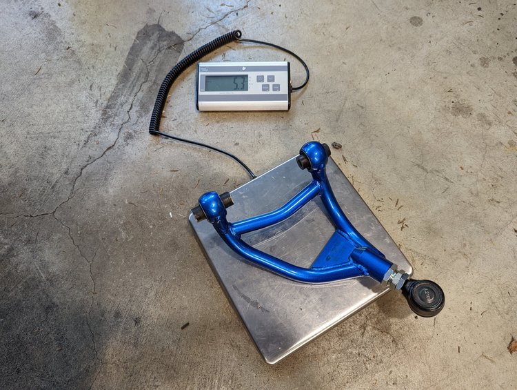

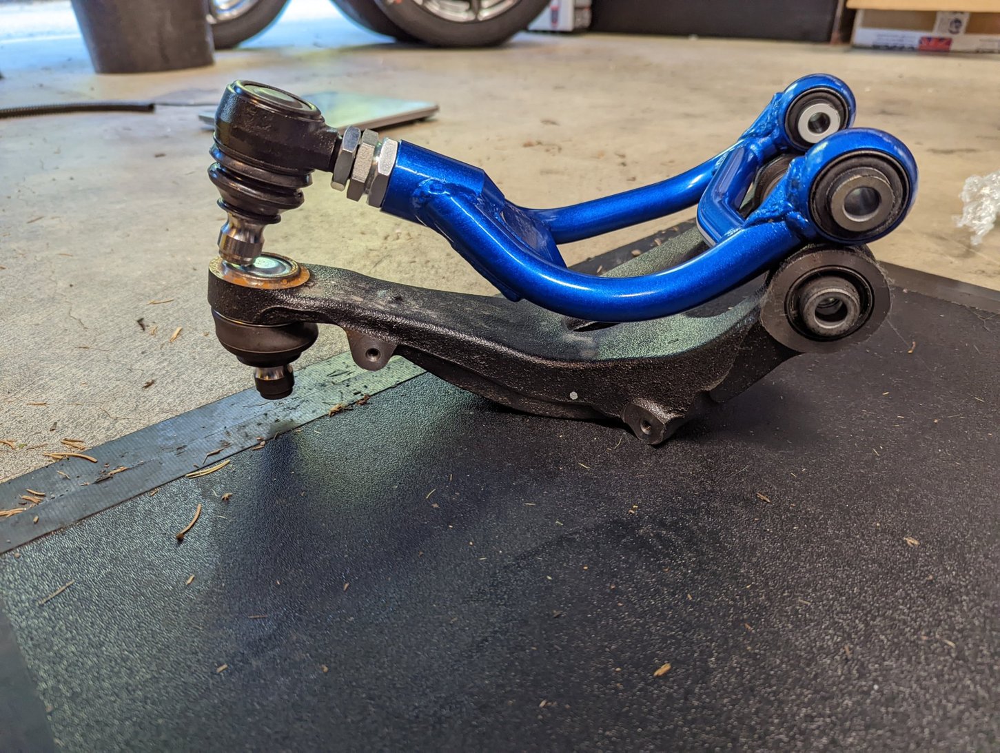

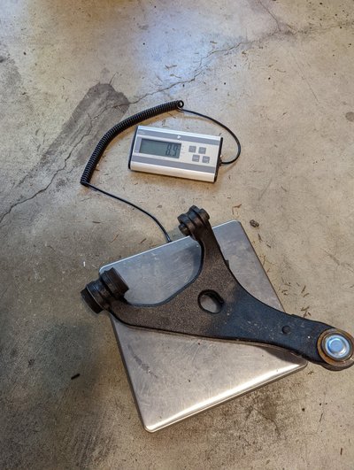

Cusco rear UCA on the top of OEM part.
5.3 lbs vs. 8.9 lbs OEM

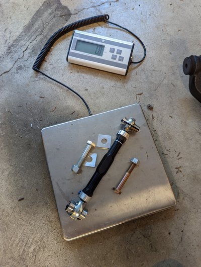

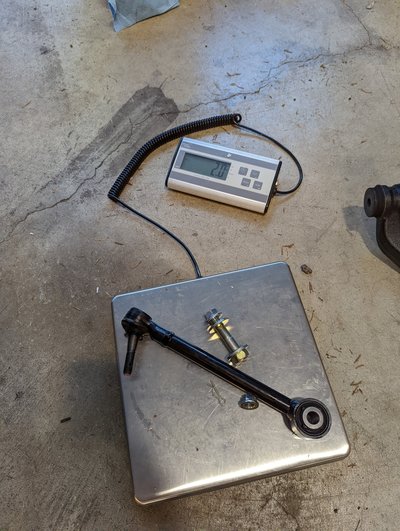

1.8 lbs vs 2.0 lbs OEM

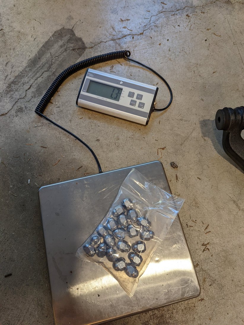

OEM lug nuts, though light, still weigh 1.3 lbs vs. Gorilla at 0.6 lbs.

Finished! It has zero camber right now, but has huge potential with the changes.
I'll be driving to track to add some more miles before the first event, and will be testing it out on Friday; looking forward to it!
