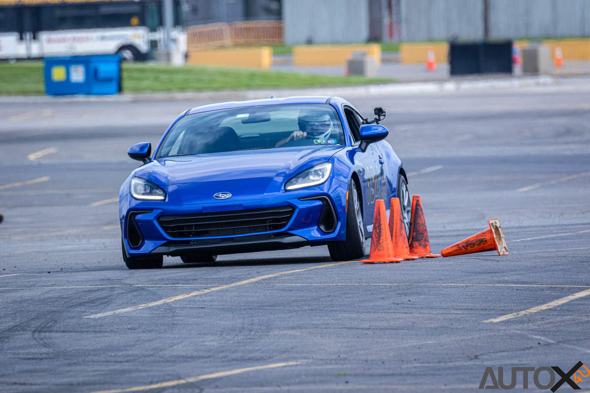

Car: 22 BRZ Premium
Wheels/tires: Enkei TS-V 17x9 ET45 (10mm spacer up front) / Yokohama Advan A052 245/40R17
Springs/shocks/coils: Shaftworks USA with 6k/9k Swift springs
Function?/Looks?: Function
DD/Canyon/Track: DD, Autocross, Occasional HPDE/TT
Driving experience: Advanced, lots of Solo Nats trophies & ProSolo championship, a few TTs and a bunch of HPDE
Other suspension mods: Karcepts front swaybar, Subaru crash bolts, Moog camber bolts in OEM RLCAs, Whiteline diff & subframe bushings
Camber/Toe: -4.5 Front -2.5 Rear Camber, 0.00 Front 0.30 Rear total toe-in
Thoughts/Opinions: I need -0.2 more camber at both ends of the car, I could use a little bit of front toe-in to keep the inside shoulders of my tires happier for DD.
Rides pretty well, handles great, looks great... when I'm not on my winter/stock setup.

I picked up a car that already had Karcepts MCS 2WNR w/ 400F/500R springs.
I've finally settled on this for sporty driving:
Front:
7 rebound / 4 compression
Rear:
9 rebound / 4 compression
Camber:
-3.5 F / -2.x R
Karcepts front bar on 2/2
This is with 17x9 Michelin PS4S in 245/40 @ 28psi. I still haven't made it to the track yet, but I doubt I will change it much there. Maybe a tad more rebound.
I really struggled to tame undulations with this setup. High speed shock movements like potholes and bumps are fine. Minor imperfections in the road can cause the car to jitter vertically. Letting a bunch of air out of the tires and bumping up compression helped.

From yesterday..
