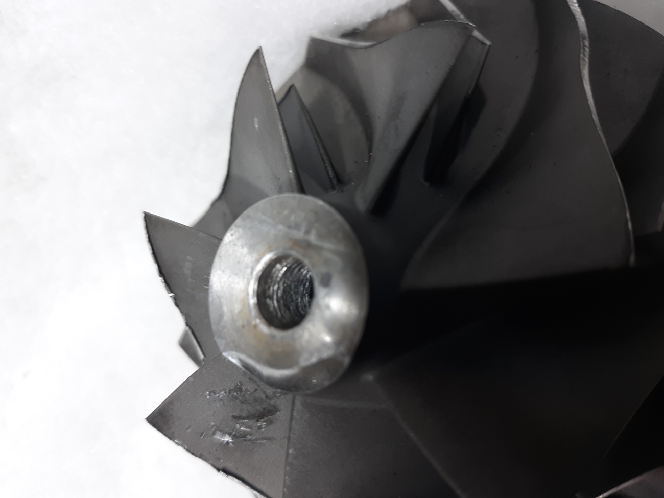

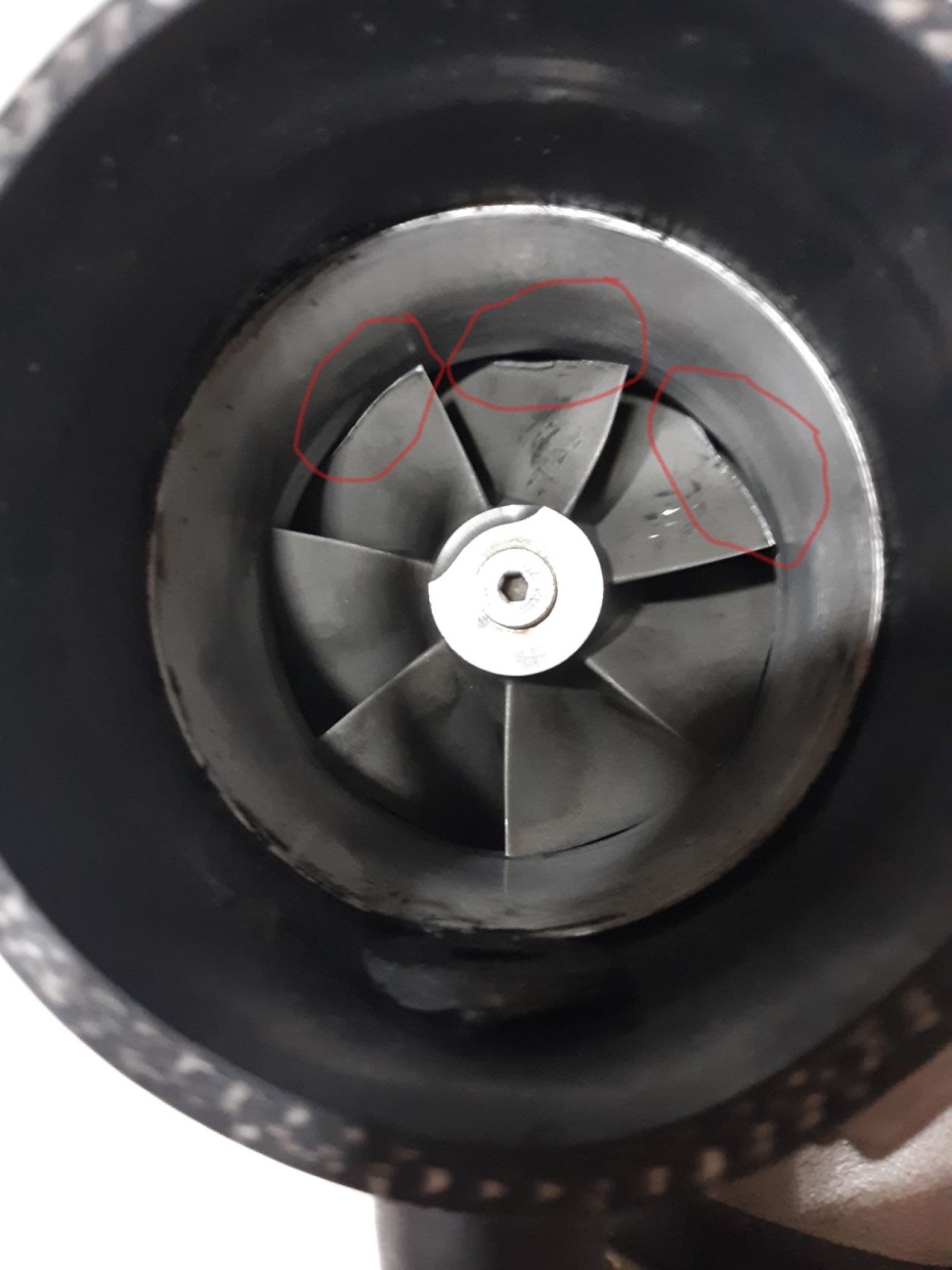

I can't use the damaged wheel. I put it back together and noticed 3 of the inducer vanes are damaged and create a large gap to the housing on the intake of the compressor. I'm sure it would leak at least a couple psi of boost. Not to mention surging and all sorts of bad things.
So I'm trying to find a replacement wheel but I'm losing hope. The exducer is 98mm and inducer is 65mm. That's huge in the turbo world. And it has to fit the housing perfectly. The only things I found that are even close is a Turbonectrics T-70 or maybe a Mitsubishi TD05/TD06. And if I went that route I think I would have to get the housing and the wheel and adapt it to the motor.
Or maybe have the original wheel 3d printed.

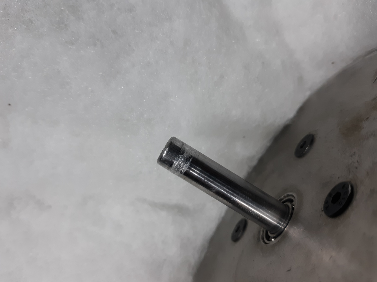

To make matters worse, the wheel is now stuck to the motor shaft. Whenever I tested the motor I had the wheel loosely fitted. There's a countersunk screw that holds the wheel to the shaft but it appears that the bore of the wheel is tapered. The torque of the motor pulled the wheel down
and closed the gap between the wheel and the mounting plate. The gap where my puller used to fit. This is turning into a major learning experience.

The more I research this thing, the more I'm impressed by it. I would really like to know the story of it's demise. As far as I can tell, virtually every part of this thing is custom made. It had to have taken years of R&D to perfect, and then it just disappeared.
I'm done trying to find a replacement compressor wheel. It doesn't exist. It looks like the compressor housing is a generic Chinese cast part that has been custom machined to fit the custom designed compressor wheel. The housing has "49179 520 0" cast into it. I've seen a few that look exactly the same on line but the dimensions are different. The compressor wheel is much larger than anything available. 98mm exducer and 65mm inducer, huge.
So now I'm researching 3D printing. I just need to learn how to make a STL file model of the wheel. I used to do Autocad at work, but it's been a while. Let's see if I can learn new tricks. Once I make the file I can try printing it in different materials and see what happens.
I got the wheel unstuck from the shaft. What a bitch! I let it soak in PB Blaster for a few days, then modified my puller to fit it but it wouldn't move.
Then I tried running the motor in reverse hoping it would unscrew. I even put a bucket over it in case it flew off like a flying saucer. It didn't. So I put the puller back on it and cranked like a mofo. Still wouldn't move. Pounded it with a hammer. Nothing. Finally pounding some chisels under did it. It's a little more bent up than it was, but I know how it's supposed to look.
You can see how it got galled to the shaft.
