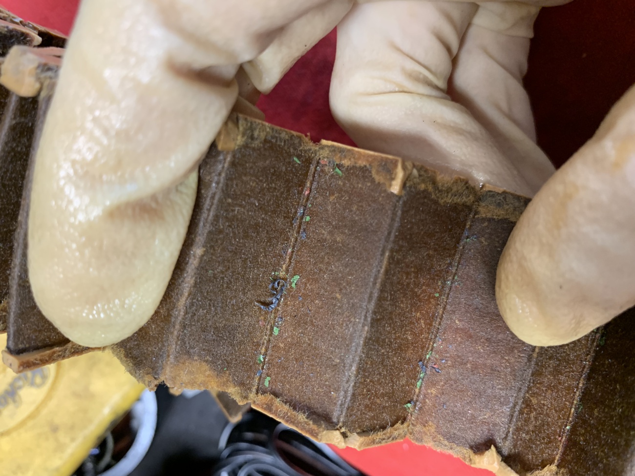

Thought I'd add mine to the mix. 22 BRZ. I found a little bit of debris on my dipstick before the oil change, unfortunately forgot to snap a pic of that.
Thanks for sharing. What is the build date on your unit?
Thanks.
Thanks.
Jan, 2022
As a datapoint, i changed my factory fill this past weekend @ 1k miles. I used a kitchen strainer as the oil drained but caught nothing. I still have the old oil filter and will perform surgery on it later this week and report back.
Sorry for the delay, i had family in town for the past couple weeks thus the delay in surgery of the oil filter. Below are pics of my factory oil filter that was changed out @ 1k miles.
- There are definitely silicon of all colors (green, red and grey) in there.
- The grey colored were rarer but larger in size.
- When i drained the oil, the kitchen strainer that i used was fine enough that it should have at least caught some of these pieces if there was any. But the strainer didn't catch anything.
- Was driven like a granny since break in. Maybe 20% throttle and no more than 4500 rpms.
so oil flow is related to engine rpm. if rpm's are so low, there's a question of whether there's enough flow to either break off chunks, circulate them to the filter, or get them to the places where they'd be visible, and also get them to the places that could cause damage...
Old 08-14-2022, 12:33 PM   #643
Petah78
Join Date: Dec 2019
Drives: 2022 BRZ sport-tech
Posts: 398
Thanks: 347
Thanked 186 Times in 117 Posts
This statement is true.
If this was the case, there is no need for an oil filter at all. I am sure there was enough flow to carry the debris/contaminates to the filter even at the "granny" aka, normal driving rpms. Plus, any higher pressure and the filter will go into bypass mode anyways. I will likely do the same with the oil filter of the 2nd change and the car will be opened up then. Can always report back then but it will likely be next year.

there's also the condition of the sealant-- temperature cycling, as well as conditions it was installed in
tldr: sealant is a horrible way to seal a motor
