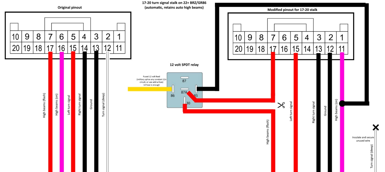

Originally Posted by removedonut View Post
The only part that is needed for this is a gen1 light switch assembly. When I bought mine it was marked as 17-20, but it appears it’s the same from 13-20 regardless. Part # is 83115FJ070, this is about $150 from subaru but i got mine for $40 off ebay.
With the proper repin of the headlight harness, all functions work exactly as expected (including 3-blink lane change), with one minor caveat when it comes to the high beams. There are 2 differences:
1. The gen2 switch sends a momentary pulse when you push the high beams into the on (forward) position, while the gen1 sends a constant output in this position
2. The gen1 stalk also sends output to the wire for the high beams flash (pulling the stalk towards you) while the stalk is in the forward/on position. The gen2 stalk only sends output to one wire or the other, and if there is output on both wires it won’t turn the high beams on at all.
We can solve this in 2 different ways, and i’ve made 2 different diagrams.
The easy way simply hijacks the high beam flash wire and will have the high beams function exactly how you expect them to, but this will break auto high beams if you have an automatic.
The less easy way requires the use of a relay to interrupt the high beams flash wire while the stalk is in the forward position. This should retain auto high beam functionality, but the downside is to use your high beams, you will have to push the stalk forward, and then pull it back to the center again (simulating the momentary pulse of the gen2 stalk). To turn them back off you would once again push them forward, then pull them back to center again.
Repin info:
Depin white pin 12, insulate. This wire will no longer be used. You could optionally move this pin to the pin position for the fog lights and use it to control something, but I haven’t looked into what pin that is yet.
Move pink pin 16 to pin 11. Pin 11 will already be empty.
Move pin 13 black to pin 12.
Move pin 14 black to pin 13.
Pin 14 and pin 16 will now be empty.
*there are other wires pinned in this harness. i have not illustrated them because there is nothing that needs to be done with these wires.
For 6MT, or 6AT if you don’t care about keeping automatic high beams:
Cut the pink wire that is now in pin 11, making sure you leave at least an inch and a half on the connector side of the wire. Insulate the loose wire on the vehicle side of the cut. Connect the connector side of the wire to the red wire in pin 17 via military splice.
For 6AT:
Cut the red wire in pin 17. Connect one side of the cut wire to terminal 30 of your relay, and the other side to 87a. It does not matter which goes where. Terminal 87 will not be connected to anything.
Military splice a wire into the pink wire in pin 11 and connect it to terminal 85 of your relay.
Connect a fused constant 12 volt feed from somewhere in the vehicle to terminal 86 of your relay. We only need <150mA here, so any circuit is fine and you can use the smallest fuse available to you.
Attachment 213679
Attachment 213680
