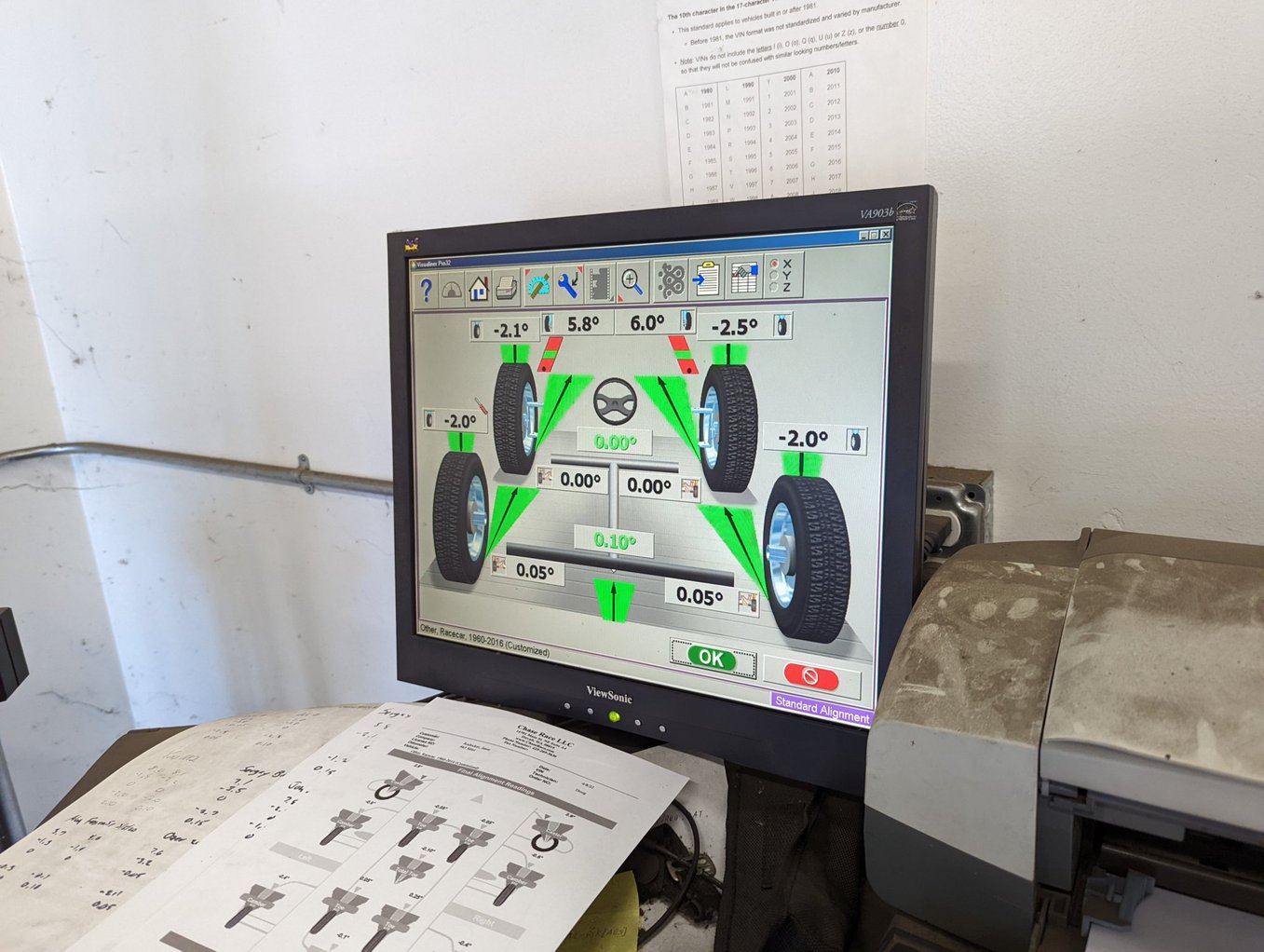

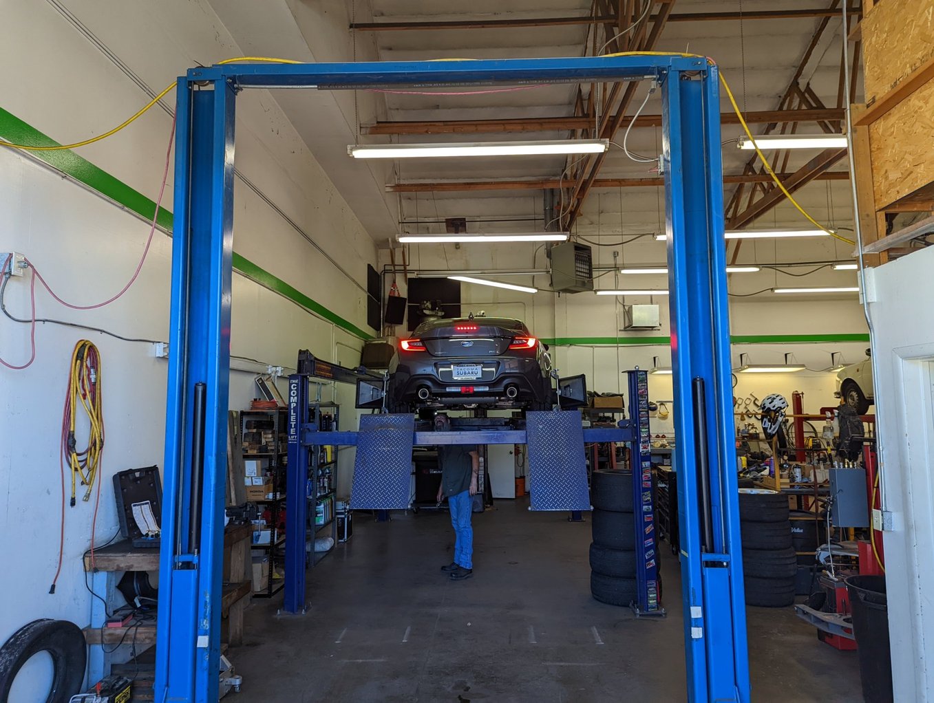

Got the first alignment done (@200 miles)
Finally got the first alignment done.
Rear UCAs complicate the alignment a little bit due to clearance issues, but it's not too bad.
At stock height, this is all we could get. Since the track I'll be at is CCW, I suppose -2.5 will be put to use : P

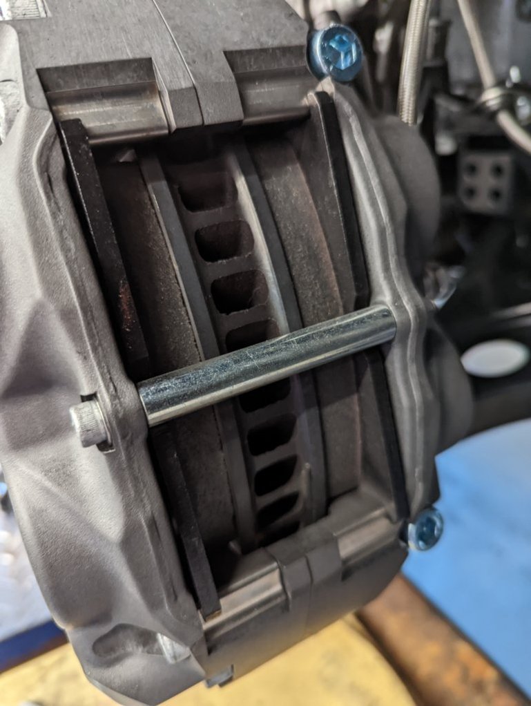

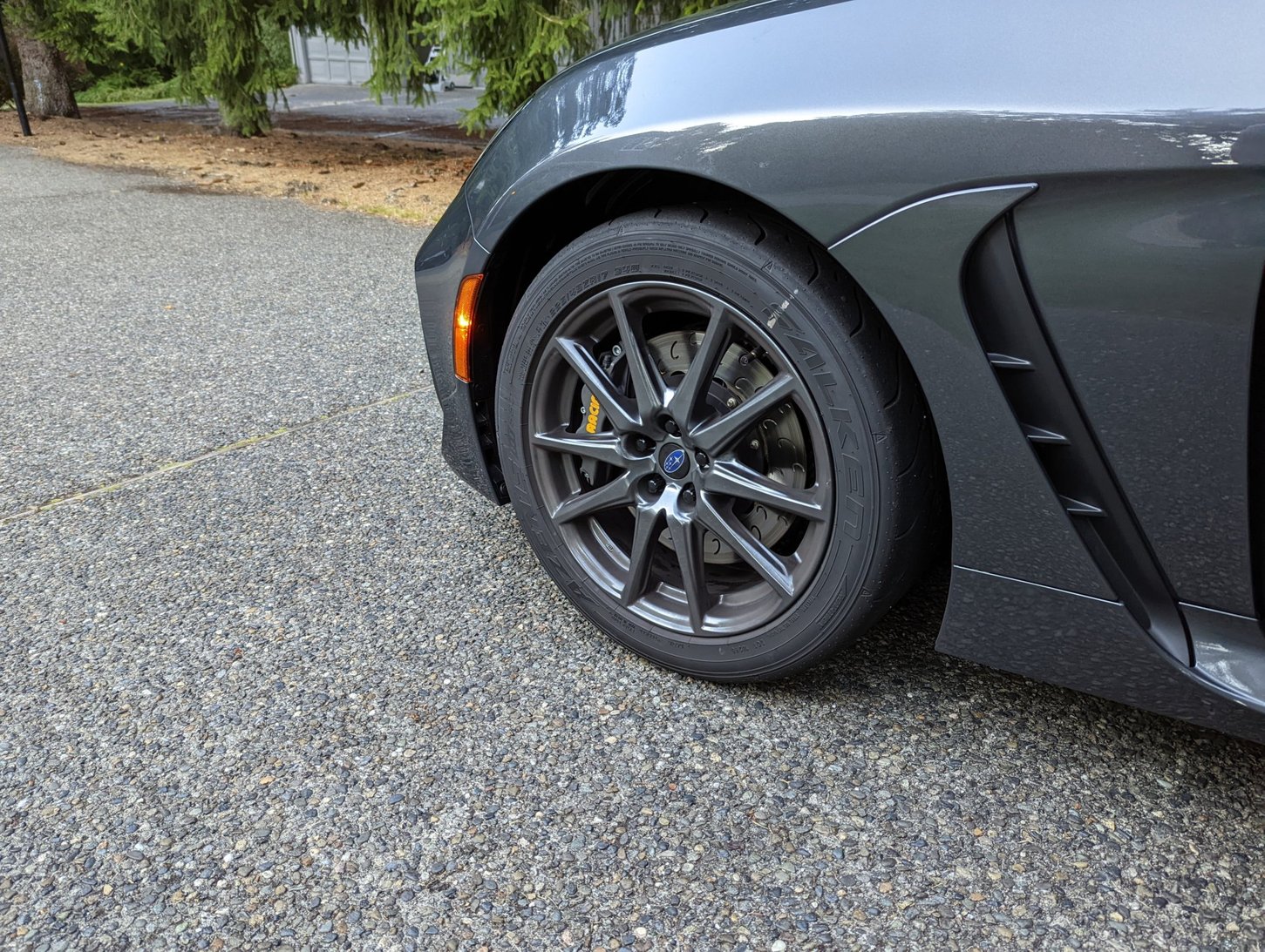

Front pads look nice and thick. The bite does not feel high at all, but I have not bedded in pads anyway, so it might improve at the track.

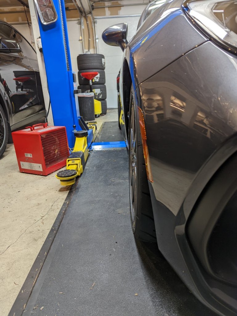

How -2.5 camber looks like. Looking forward to what we can do with the coilovers and camber plates...

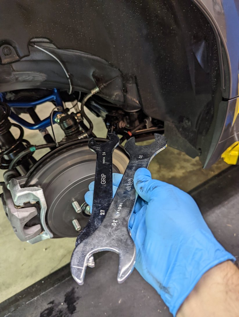

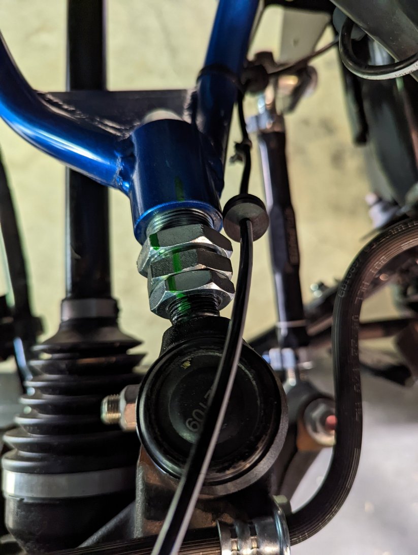

Back home, I realized one of the rear UCAs' adjustment has moved. I really don't like the luck nuts' design on this, since they are too close and thin, and make it hard to get them really tight.
I think these flat(thin) wrenches would help.

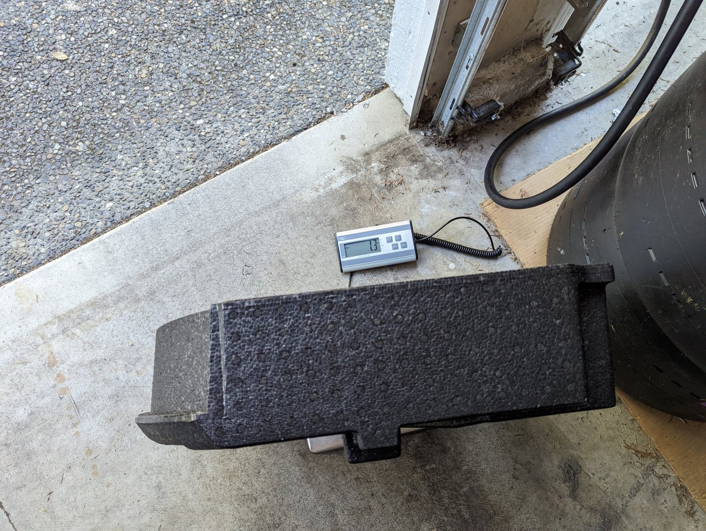

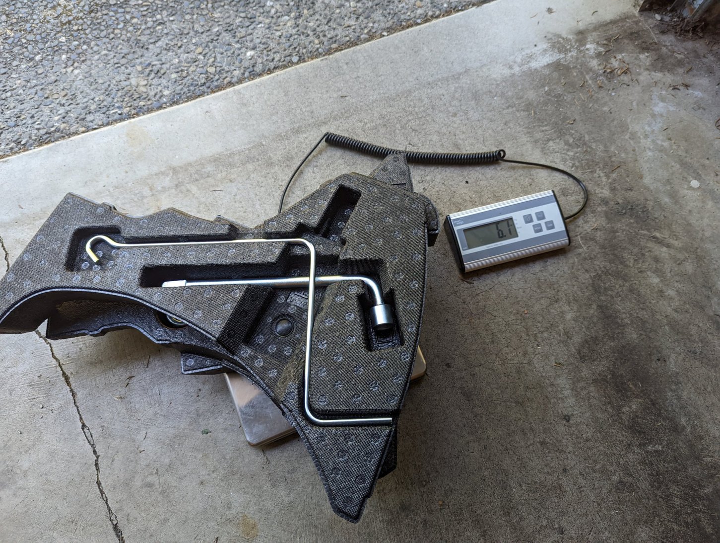

Ready for ORP (Oregon Raceway Park)!! Unlike the other events, I will be attending an ORP club day, which allows me to use the open track for as long as I want except for the lunch break. I'm hoping this would be a great opportunity to get used to the clutch, etc. as well, since I need to learn how much I should blip in downshifts on this car. During my play at the street (which is hard to do without heavy braking), it gets oddly satisfying when the blip is just right, and shift happens with zero resistance. Anyway..
Forgot these in the trunk... 2.7 lbs for compressor
6.1 lbs for prehistoric tire tools
1.3 lbs for the case. I like it, so I decided to keep this one..

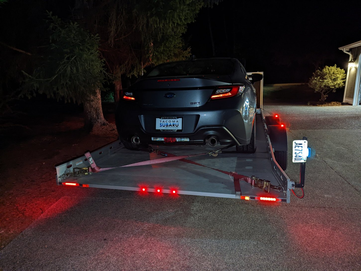

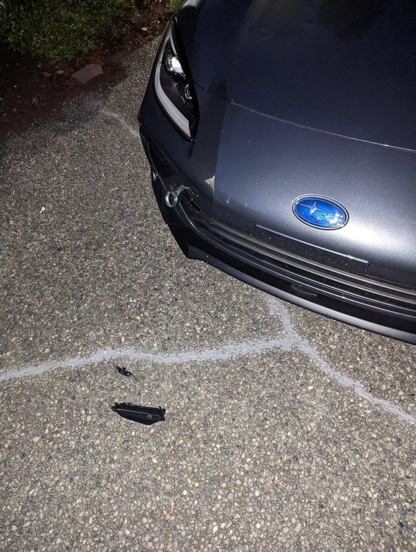

Also, just realized I needed a tow hook to winch the car onto the trailer. OEM unit is actually not very heavy. Nevertheless, I ordered Perrin's tow hook in black color. I'd really want to have cloth, but have not found something good for front fitment.
This thing is so tiny! Corvette has about an inch of clearance on both sides when loaded.

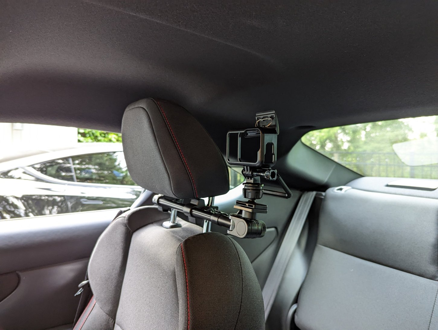

Until I figure out the roll/harness bar issue, I'll use this mount.

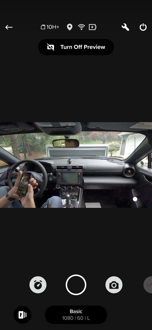

This is how it will hopefully look like. I will need to play with smoothness and EV settings since I just switched to GoPro 10, and not sure about optimal settings, yet. One bummer is that the spot metering (Exposure control) can only be done from the camera's screen, which is not easy to access from the mount's location.
Besides these, I'll also be camping in my hybrid truck, which I'll keep running (it provides HVAC and 7200 Watts of max power, and only runs the engine for a minute every 20+ minutes or so; amazing perks). Looking forward to watching videos/movies with 10+ speakers of the truck; better than my lviing room for sure : P
That mount, for me, over time became loose between the outer and inner tube and caused excess wobble. There's probably some hack I could do to help with that but I've changed mounts. For the Hero10 - I use the same - you can set the EV in the app or on the camera and use the profiles to save you preferred settings. I set mine to -0.7 EV and let it ride.
My issue with the Hero10, is it would like to freeze when charging while the camera is 'off' and would refuse to turn on unless I pulled the battery.

My other cam is DJI Action cam, which works great actually, but its app, which I need for spot metering, needs to be side loaded on Android. Since it forces you to skip app store, it could have a malware, and you'd never know. This is even a violation of my company policies, since I'm not supposed to side load stuff on a phone where I have Corp access as well, so I removed it.
Back to GoPro, freezing is not good. Here's hoping this one doesn't do it. Did you try updating the firmware in case that fixes it for you? It also doesn't let me control the camera when I want charge using car's USB since it establishes data connection.
I prefer exposure control (spot metering), but perhaps I might as well settle with EV, since it'd also make it more consistent. Another issue I've had with GoPro cameras was that the video frame pans towards the outside direction of long turns. I searched up, and they say it's a normal side effect of image stabilization, yet DJI is smart enough to not do that(!). I'm planning to play between stabilization settings as well. In the worst case, I can always stabilize it on my PC during processing.
