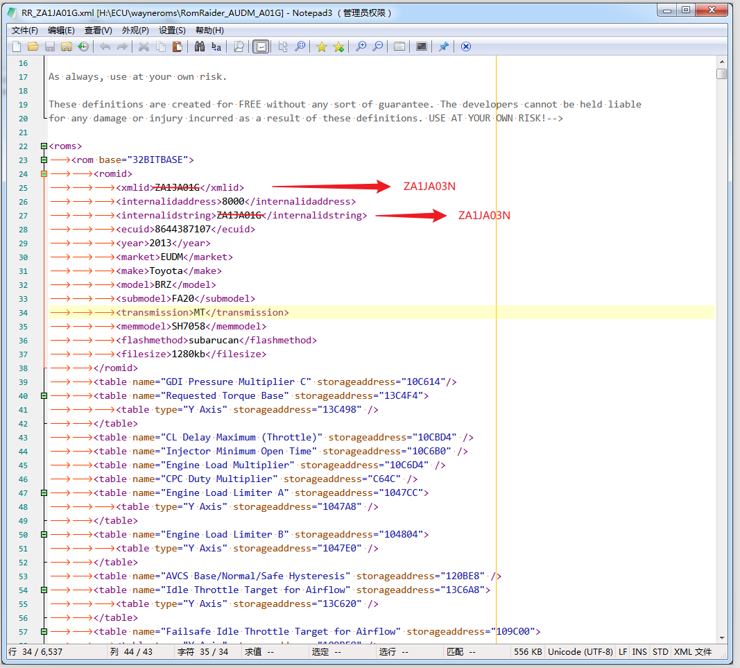

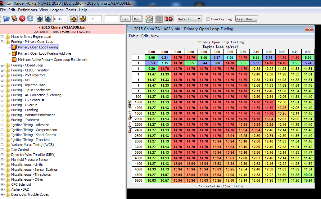

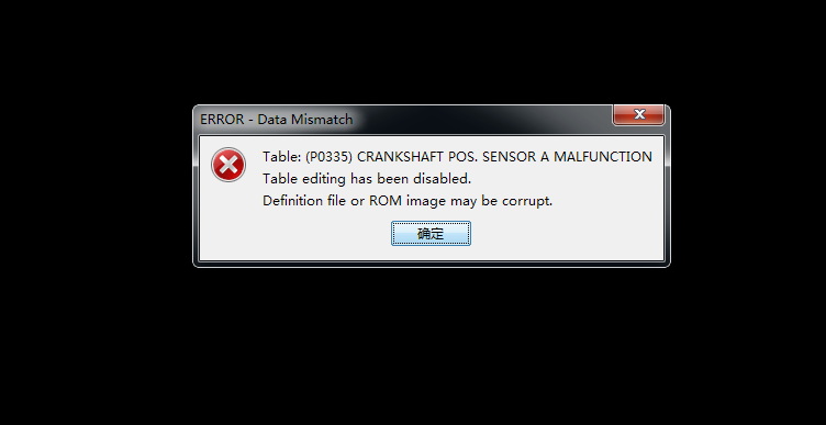

After modifying RR_ZA1JA01G.xml, an error is displayed.

OK my trick with definitions only works with OFT roms as their A03N tunes are actually based on A01G roms
you could just use A01G in your car as a substitute for the A03N rom.
There are no romraider definitions for genuine A03N roms
however easier to just use ecutek if you have it
Ecutek has all the tables you need in the A03N they are just called different names
The idle overun tables you want are called
"Ignition Timing Idle" there is about 6 tables defined more than romraider in A01G they are under Ignition timing folder in ecutek they are fully defined so just edit your A03N rom in ecutek
