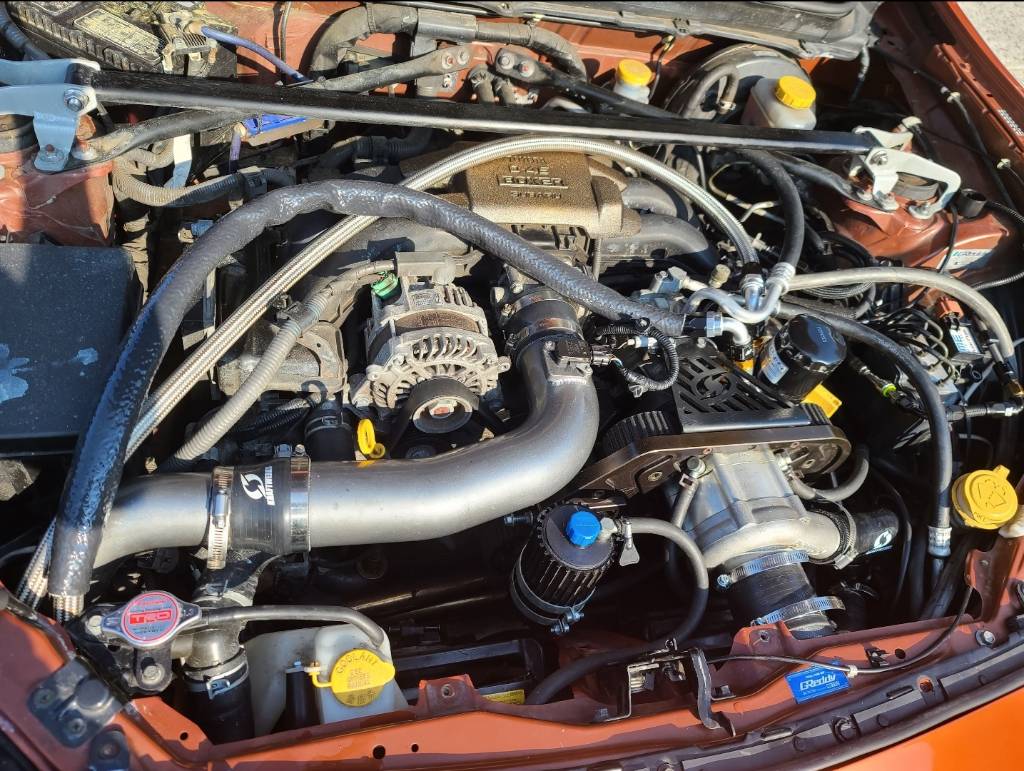

Idler Bolt
Supercharger and belt still running good. But having an issue with the Idler pulley backing out. The Idler pulley bolt snapped. I replaced it with a longer Bolt, Placed white out on the tip of the bolt and test drove it for about 5 mins. I noticed that the bolt again backed it self out slightly. How tight is tight with this idler bolt and and tips on keeping it tight? Like everyone else, this would be the perfect kit if the tensioner was automatic lmao
2015 Hot Lava FR-S IAG 800 FBM Turbo Kit

^not sure if you already fixed it but the threads on that part look pretty messed up. That might be the reason why it backs out under load. The longer bolt might be bottoming out and not holding the idler pully tightly.
1. check the threads.
2. get the correct bolt length.
Like most people, I ruined my first C30 due to the improper belt tension instructions and also had the pulley fall off because I didn't use lock-tite. After leaving the belt on the looser side of things, I have had no issues in hot or cold weather. Easy $2000 mistake.
