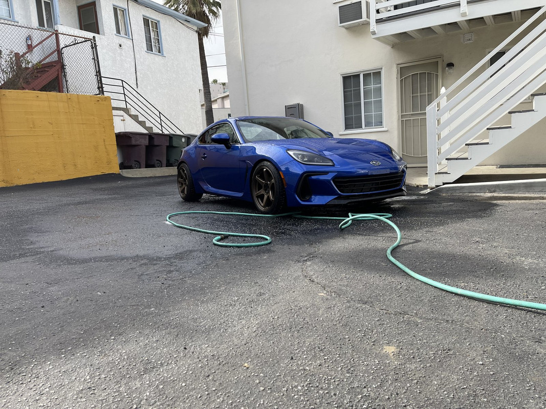

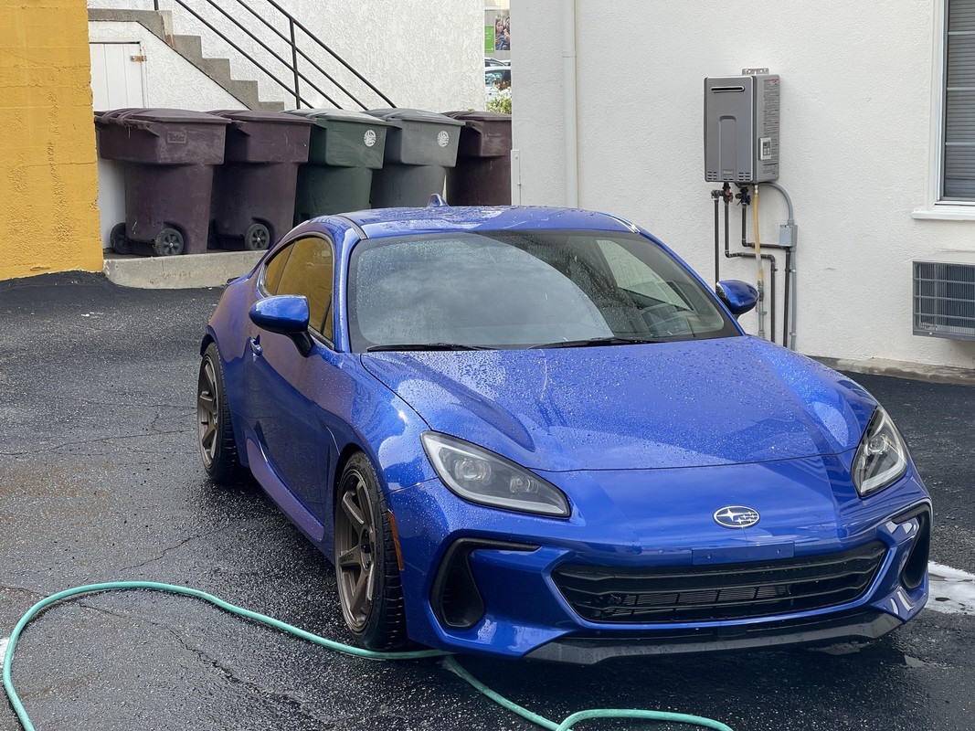

Installed kw V3
White line rear lower control arms
Vorshlog top hats
Enkei wheels 18 9.5 +45
PS4S 255 35 18
Alignment/corner balance (for those in southern cali pls check out West End alignment shop awesome super detailed professional)
Ridiculous!

Front looks good but the rear looks like it pokes? Any fender work?

At my height it doesn’t rub one bit even on three wheel motion.
Folks seem to have issues with +35 offsets on the back
+45 seems to be the way for a flush performance oriented stance.

What's your rear camber?

2.2 back and front
