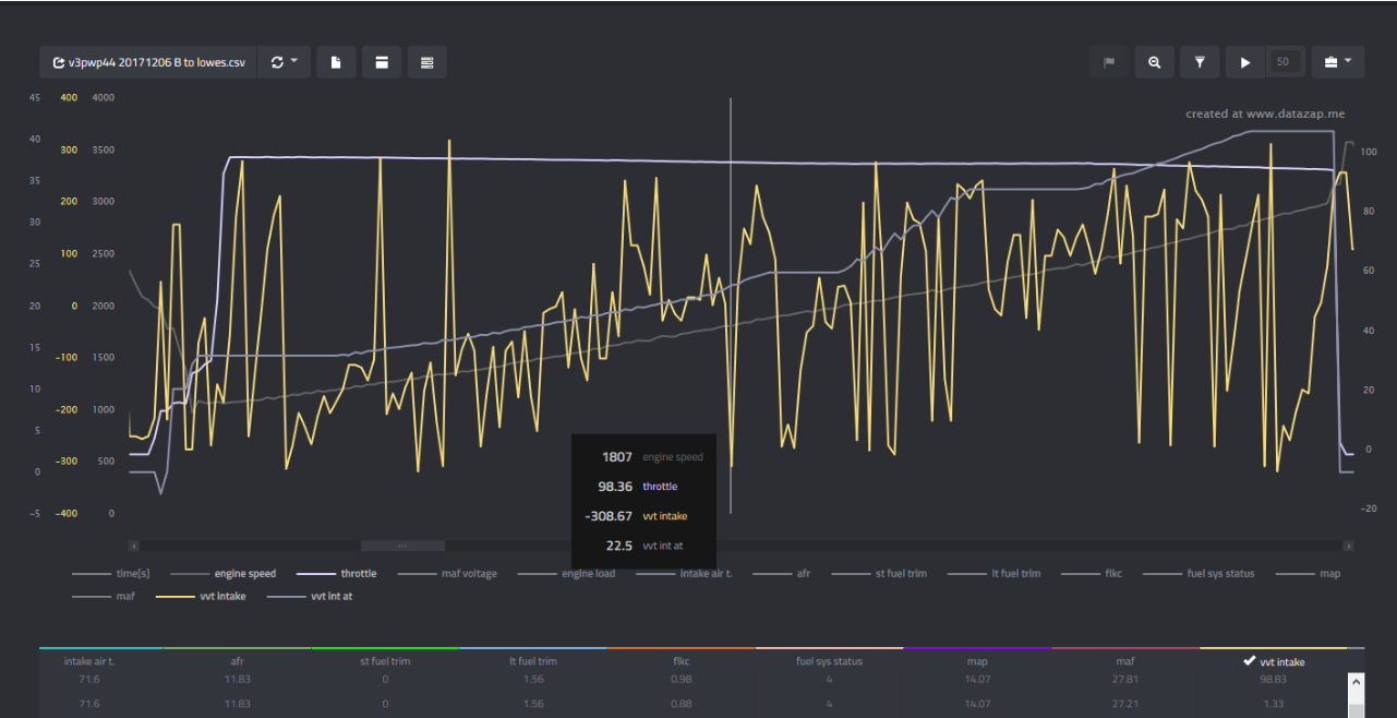

I'm trying to experiment a bit with the AVCS system (at lower RPMs), intending to use it with the MAF Scaling Tool's VVT tool, and have run into a puzzle with my Open Flash Tablet: "vvt intake" seems to be super noisy, though "vvt int at" seems to be fine. In contrast, "vvt exhaust" seems to be fine.
Any suggestions? Should I just use "vvt int at" as the current intake angle and ignore whatever "vvt intake" is trying to present?

Did you compare it with VASC tables?

Yes. "vvt int at" compares very well with my Intake Cam Advance Angle (both my "normal" and "safe" are the same currently). So closely that this could be the computer requested angle as opposed to the current observed angle. Just comparing numbers, it looks like "vvt int at" is what I should use for Kodename47's tool.
I'm mostly just curious about "vvt intake" because "vvt exhaust" seems to be fine. So is "vvt intake" just logging some junk value, or is my cam angle sensor messed up?

Looks like that vvt intake log parameter is logging rubbish
If your 2012-2016 you need to go to a bo1c or d rom to get correct logging in mamy cases
