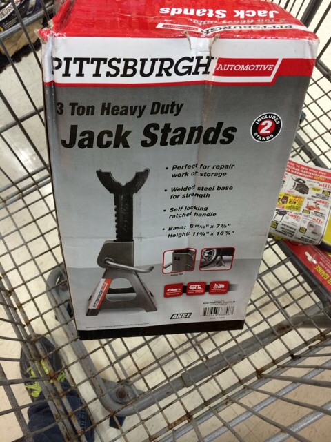

Will this Work?
Thanks!!
Only 7 years late but that trolley jack is garbage. It will do fine with tire rotations and oil changes but it doesn't elevate the car much to do comfortable work under the car as it's raised. I'm so happy with my Arcan 2 Ton Low Profile Steel Floor Jack XL20
