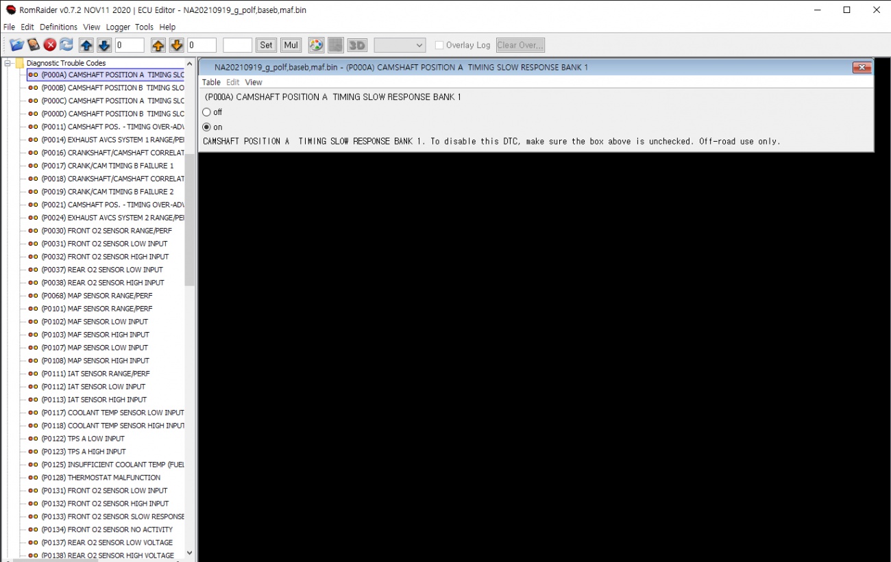

Does anybody know A01G hex addresses for codes that come before P0011?
The list in Romraider -> Diagnostic Trouble Codes seems to start with P0011. Codes like P000A, P000B, P000B, P000B and P0010 are nowhere to be found.
On GitHub I've found a definition file that says A01G but it's totally different from my A01G definition file I got from Wayno's website and this definition file just throws bunch of errors when I try to open my ROM.

Below lines do the trick for A01G.
HTML Code:
    <table name="(P000A) CAMSHAFT POSITION A  TIMING SLOW RESPONSE BANK 1" storageaddress="11C7C4" />
    <table name="(P000B) CAMSHAFT POSITION B  TIMING SLOW RESPONSE BANK 1" storageaddress="11C7D0" />
    <table name="(P000C) CAMSHAFT POSITION A  TIMING SLOW RESPONSE BANK 2" storageaddress="11C7DC" />
    <table name="(P000D) CAMSHAFT POSITION B  TIMING SLOW RESPONSE BANK 2" storageaddress="11C7E8" />
Name:  RomRaider v0.7.2 NOV11 2020 _ ECU Editor - NA20210919_g_polf,baseb,maf.bin 2021-09-20 오&#.jpg
And the definition file in the link you've mentioned has weird DTC addresses. I don't know why td-d left those values incorrect, but suggest to use the definition file included in the OFT distributions. Keep in mind that since OFT v4, all definitions for manuals are based on A01G.

Now the P000x codes show up in Romraider, thanks a lot!
