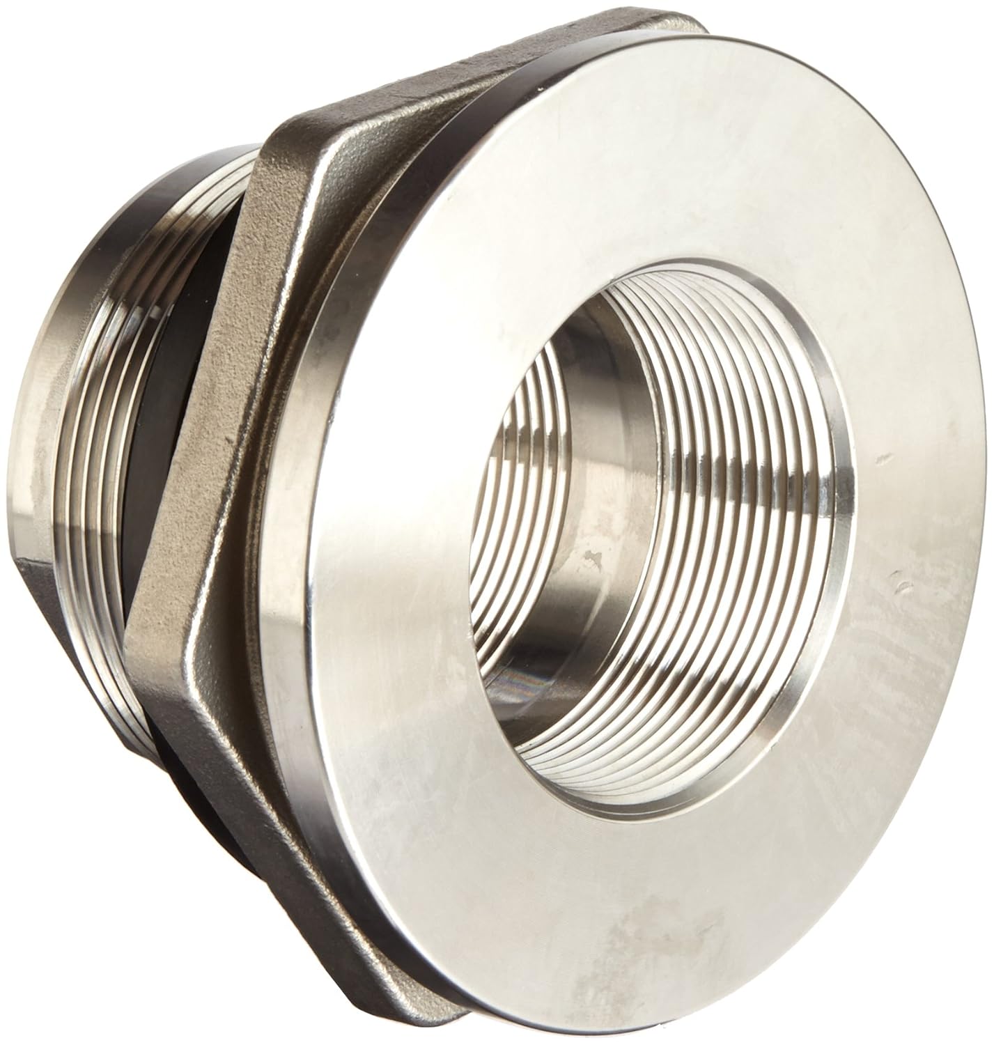

I noticed in this picture that they welded in a bung to the back after pulling the breather. K-Motor makes a -10AN fitting that presses into the breather once it is pulled, so welding isn’t necessary, but that appears to have been short lived. There isn’t much room back there. In the more finalized shot, they are using a banjo bolt to what appears to be a bulkhead adapter. These are simply installed by drilling a hole and sandwiching a bolt with a screw, and then the banjo bolt bolts in to the female bung. No welding required. I’m assuming the rear breather would get capped, cut shorter and capped, or it would be replaced by a plug.

I saw Taylor Ray use these on this k24 swap and plug the stock port.
https://www.motionraceworks.com/prod...er-pair-32-120
