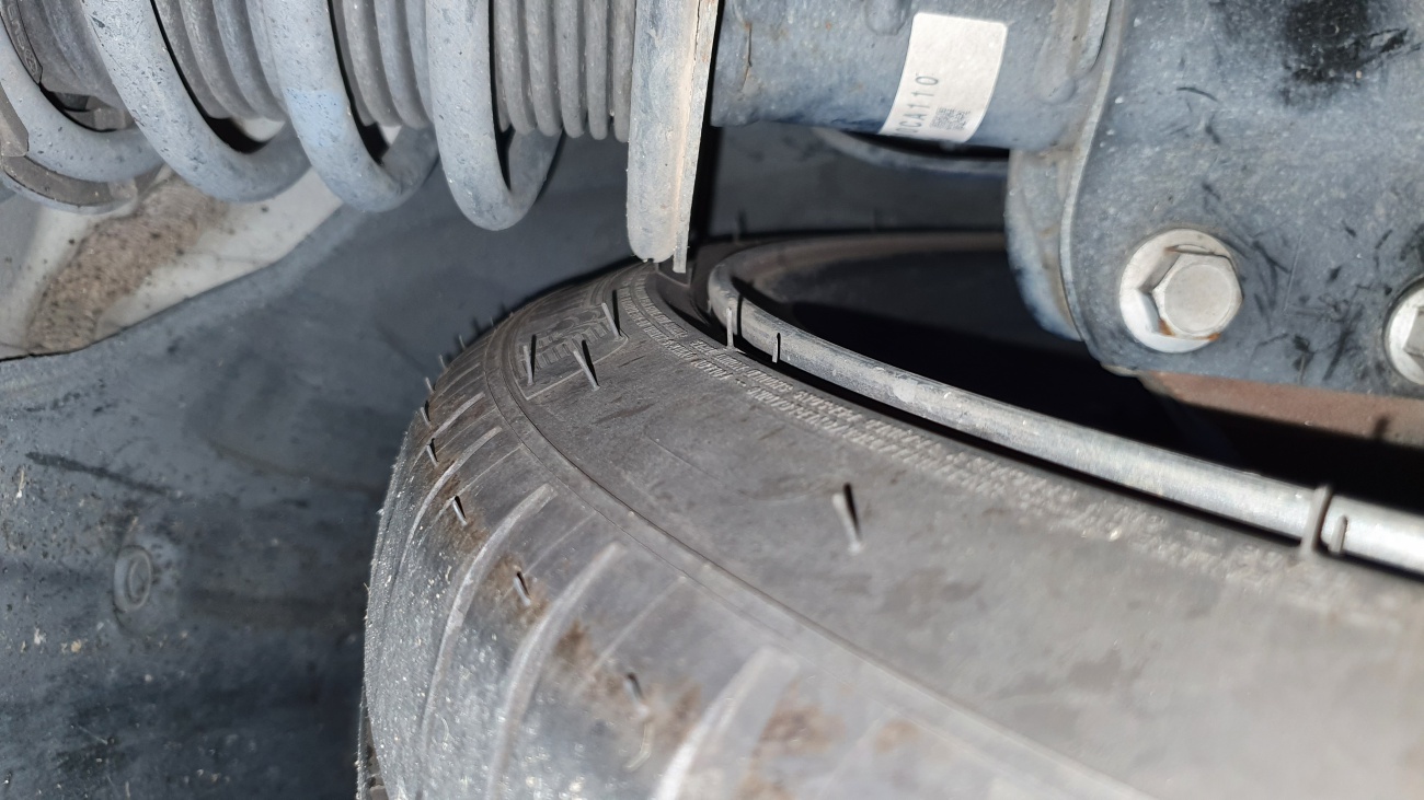

I've got the same wheel with all stock suspension on 235/40/18 Michelin Pilot Sport 4 tires. This is the clearance you will have with -0°45' camber, which is the limit from factory. Should have no issues if your alignment is within factory spec. I have camber bolts installed but had no luck gaining any additional negative camber past factory values without rubbing on the spring. Hope this helps

here's some fitment pictures. Pluse has a good idea of the clearance in his picture
