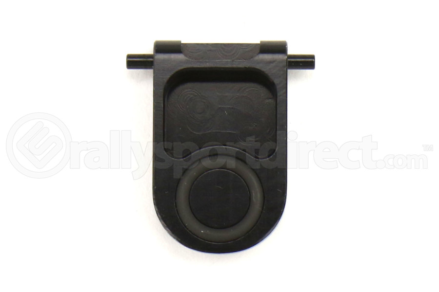

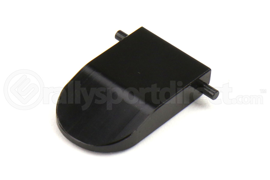

I think I might go in and inspect my Verus fuel door installation. I'll probably remove it, at *best* it didn't improve things at all between New Hampshire and Palmer1. At *worst* that little 3d-printed plastic door (NOT the advertised and illustrated aluminum door with steel pins!) is f-ing things up due to either being broken or possibly too lightweight to work properly.
UPDATE: the part is indeed cnc'd aluminum, NOT 3d-printed plastic! So lightweight (due to being massively hogged-out) and painted shiny black plastic with integral pins rather than previous version (?) pressed steel pin, really gave me the impression of being plastic when I installed it! Just removed it and can confirm it's aluminum
Wait what? I'm 99.9% sure mine was CNC'd aluminum with steel pins. Purchased within the last 3 months.
They changed over at some point. Here's the plastic part:
The density of PLA plastic is less than half that of aluminum, and it's only 65% more dense than gasoline. Pretty sure I'm gonna remove it and ask for my $$ back.
They show the anodized aluminum one on the Verus website and here's their description:
SPECIFICATIONS
CNC Machined
6061-T6 Aluminum Construction
Anodized Bright-Dip Black
Viton O-Ring for Ethanol and Gasoline Compatibility
Yeah, that is not what I got...
ZDan is offline   Reply With Quote

Dan, you got hosed! I would definitely get my money back, that is way too much money for a PLA printed part!
Talked to some of the GTA guys and they said only starvation at half, and one of them tried the fuel door and it didn't fix it either.
I'd be fine with it if it *worked*. But no way I would have even bothered with it, whatever the price, had I known it was plastic.
PLA is only 1.65x denser/heavier than gasoline.
Aluminum is 3.6x denser/heavier than gasoline.
Stainless steel is ~3x denser/heavier than aluminum and IMO would have been the way to go...
Plastic is a stupid material choice for this application for anything other than making the part cheap.
I think I have an aluminum one on the way to me now. On the fence whether I'll install that when I remove the plastic one or just revert to stock with no door.
