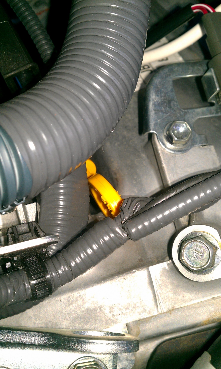

The manual tranny has a dipstick like the subaru wrx's underneath all the cabling in an awkward position on the side, hard to find but it was found.. eventually.. its where the transmission filler plug is on the side.. . if not you'll have to either jack up your car and remove the underneath cover or try bend in from the top and remove the filler plug on the side of the transmission and insert a dipstick to check if there is any :
hope this helps
