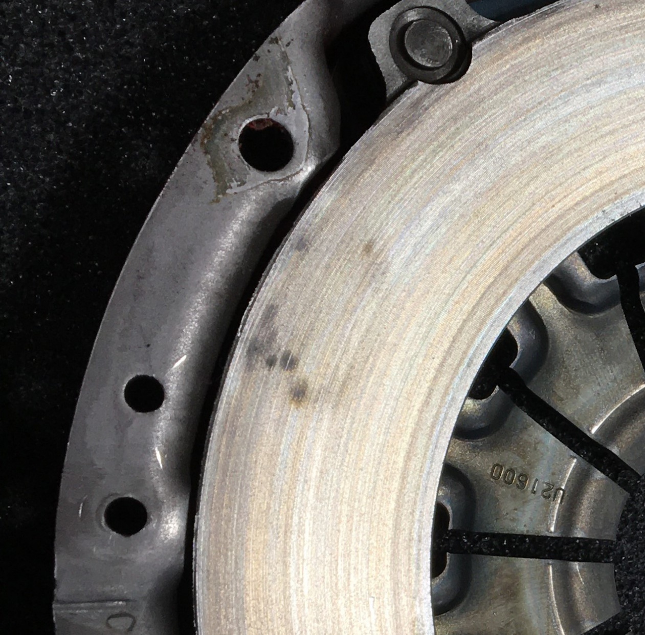

Very torn about next steps
Ok, so I removed the transmission and I can't see any visible signs of damage. When inspecting the clutch disk, I used a straight edge to check both side in four orientations 90 degrees apart by simply placing it flush across the clutch disk material. I also measured the thickness in about 8 to 10 different spots around the clutch disk and all measurements came up to 0.32 in with a variance of about plus/minus 0.002.
Something did catch my eye on the pressure plate as shown below in the picture. The pressure plate surface look uniform except for one spot that maybe showed some slight discoloration. I'm kicking myself because I have zero pics of the pressure plate surface before the install and ~100 miles I already put on the clutch, so I don't know if it was pre-existing. Perhaps it came about as a result of the vibrations I was experiencing, but I guess I'll never know. Anyway, otherwise the pressure plate and clutch cover looked to be in original condition.
As far as the flywheel is concerned, I could see no discoloration in the surface material and otherwise no visible signs that there was a hotspot. Below is a pic of it on the engine.
So anyway, I'm quite torn.
On the one hand, it seems a safe bet to just remove the flywheel and have it balanced at a machine shop, which will cost me $100 bucks.
On the other hand, I'm wondering if I should just bit the bullet and get a new flywheel (I can pick up an Exedy OEM flywheel from Subispeed.com for about $140), which presumably will be neutrally balanced, and so that both the flywheel and clutch are new. But that assumes the engine is also neutrally balanced. I tend to lean toward this option, especially since I'm already $75 in for the resurfacing of the OEM flywheel.
I'm also just wondering if I should just reinstall the clutch and transmission and see how it goes now that I have a forged metal clutch alignment tool. The metal alignment tool is certainly more precise than the goofy plastic one that comes with the clutch; however I didn't see that much difference in the play of the clutch disk between the two when installed on the flywheel, but perhaps that small difference is really all it takes.
Anyway, happy 4th of July. I hope people are having more fun than I am

As already stated, the alignment tool is only used to get everything to align just enough to get the shaft through. As soon as you press and release the clutch it all moves freely. It isn’t like you align the clutch with the tool and it’s locked in that spot forever. It’s solely for installation. This isn’t the source of your vibrations. A machined alignment tool is totally worth having though. It’s annoying when you align with a sloppy plastic one and then can’t get the shaft through and then have to loosen all those damn PP bolts all over again.

IMO. It's not the flywheel or the "alignment". I'd replace the pressure pate and disc. It's new. see if your supplier will give you an exchange.
