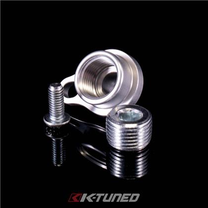

I took a trip to the local Pick-N-Pull and had a fairly successful day. My motor was missing an AC compressor, so that was my number one priority, but I had a few other ideas too.* I found a few k24s in some Accords and a K20Z3 that was in less than stellar shape. I pulled a water pump and housing from a K24, along with a starter and alternator, and I also got a clean pulley tensioner and AC compressor from another motor. I also found a water pump and housing from the K20Z3. Set me back $200, but now I have extra parts. I don't think the starter will be utilized on this swap like it is on the Miata swap, but it was only like $12. I also don't think it is necessary to swap to the USDM accessories, but I like having extras just in case, and I can always sell them on eBay later.
The K20Z3 water pump and housing will be used to supply the coolant feed line for the turbo. The coolant pipe running off the water pump normally has a hose end, but I want to make everything with -6AN fittings. I thought about welding in a bung, so I can run a -6AN adapter, but K-tuned already has a few solutions. One is a plug with a 3/8 NPT plug, and the other is a fitting with a 3/8 nipple and likely a 3/8 NPT plug. I like the first one pictured below. If someone wanted to just use rubber hoses then the stock hose barb would be fine.
https://k-tuned.3dcartstores.com/Oil...NPT_p_501.html
For the return side, I think I have decided to use the same fitting mentioned above with a 90 degree 3/8 NPT to -6AN flare, which will then join with a -6AN line. The K24A2 motor has a hole bored and another hole that is tapped to accept a stock oil cooler fitting, which looks like this first picture. On some K24s there is a plug in the block heater on the inside (M18x1.0 I believe), and there is likely a hole and tap on the front, and some K24s have a plug on the outside (M28x1.0 I believe), and they don't have a hole on the front (see pics).
*On a side note: I feel like the stock AC lines might mount up to the k24's AC compressor without modification. They might plug into the slots in a universal type of way, but the rear line might not be long enough. I believe Kpower is working on an AC kit, but it would be great if that wasn't necessary.
