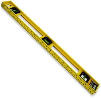

Originally Posted by ka-t_240 View Post
For all of you talking ride heights, how are you accurately/constantly measuring but to fender distances?
Seems there is no "good way" to do it with a tape measure as you can't always start in the same place.
I thought the same thing. I assume something like this might make things easier.
For all of you talking ride heights, how are you accurately/constantly measuring but to fender distances? Seems there is no "good way" to do it with a tape measure as you can't always start in the same place.
I have always used the bottom of the rim to put my tape measure on. its a repeatable spot for the tape measure
I do this. On the scales when everything is level and all. Not perfect but seems consistent over time. I do check that the tape is plumb too since it can look so and add 1/4" so easily.
