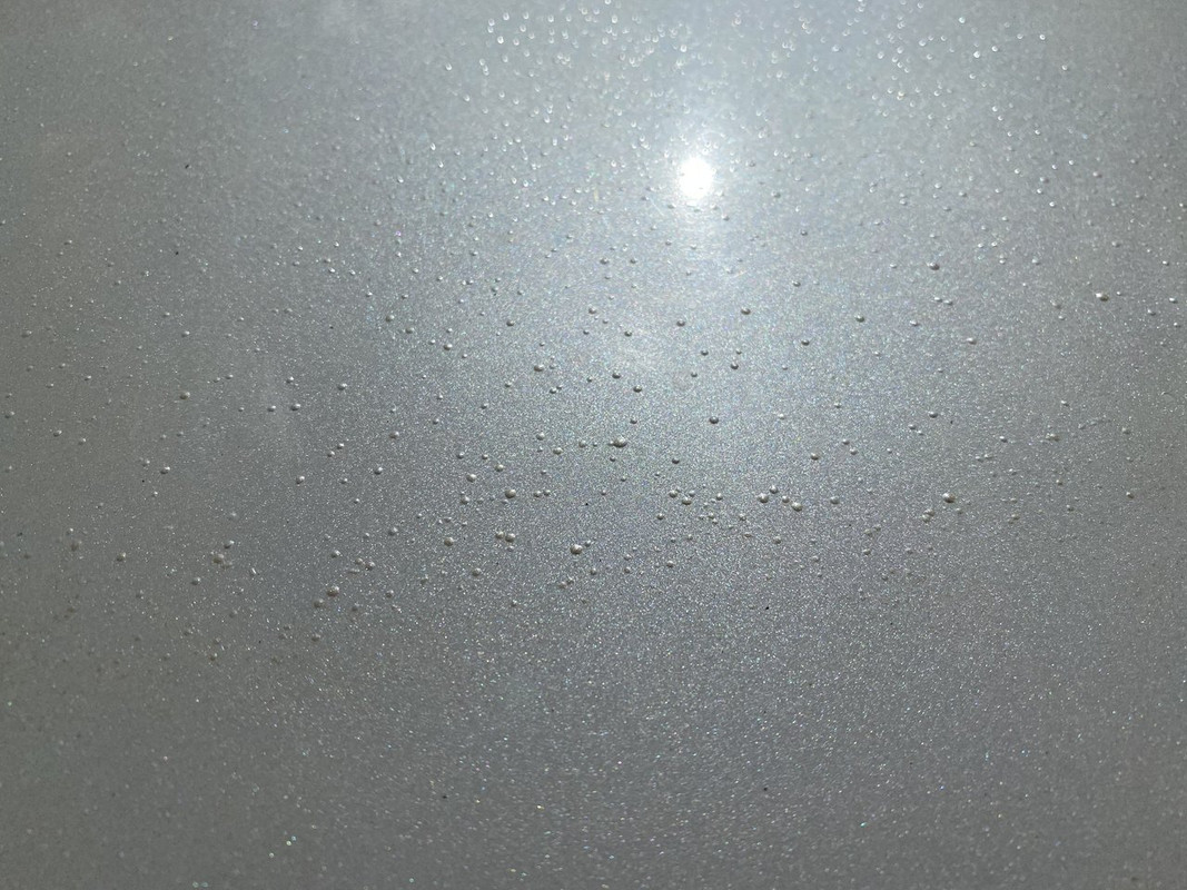

Update #2. In the past week or less, the roof went from perfect to having a bumpy, acne paint outbreak that would make a teenage put a bag on their head.
Paint guy is saying that they’ve never seen this before with OEM paint. But it’ll be about $700 to sand it down and respray it.
Industrial pollution? The professionals can’t explain how/why it could be perfect for over two months then suddenly tiny paint bubbles everywhere.

Sounds like it would be cheaper to sand it and rewrap it. The roof is pretty easy to do. I can ask my paint/body guy if you post a picture if he has seen it before.

Old 10-02-2021, 07:49 PM   #13
Four_wheel_drifts
Join Date: Apr 2016
Drives: Whiteout track car; lava donor
Location: Portland, OR
Posts: 245
Thanks: 87
Thanked 64 Times in 40 Posts
[IMG][/IMG]
Four_wheel_drifts is offline   Reply With Quote

My paint guy said there was either water in the sprayer or something else causing rust to form under the paint. He does not believe moisture trapped under the wrap would cause this and is likely a flaw in the factory paint.
Looking at my car when I wrapped it, the trunk where the factory spoiler did the same thing, though not to the extent yours did.
