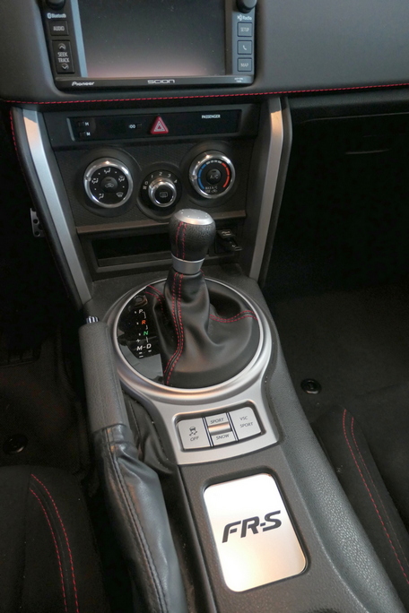

Originally Posted by Ernest72 View Post
Can't see paying for a new knob you never really touch.
Agree. Thought about replacing the OEM one, but I like the silver/red stitching look so it matches; and it fits my hand perfectly. But if you want something different go for it.
