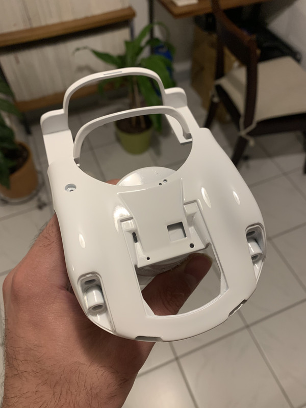

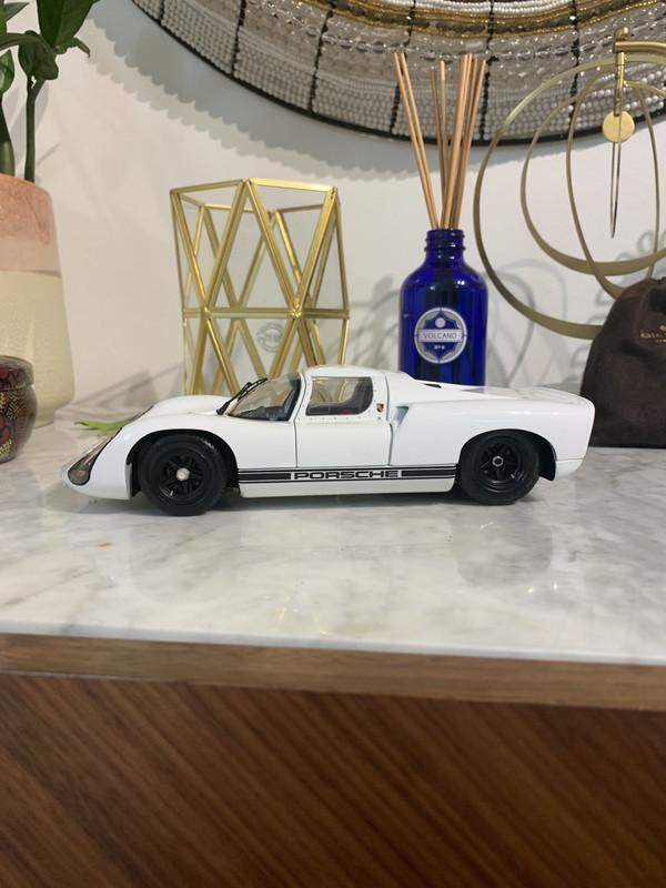

Here are some pics.
First use any paint stripper you can find at your local hardware store. You can use a metal bristle brush by hand or use a similar dremel attachment to get the few stubborn flakes of paint off. Then scuff with sandpaper to create a good binding surface for the primer.
Scuff the primer, making sure not to go through it. Then it's time for base coat. This particular one was painted with Tamiya TS spray cans. Multiple mist coats over a course of 10 mins or so, until the desired depth was reached.
Then clear. I used 2K automotive clear from splash-paints.com
It's even safe to use over decals. Can't say the same for Tamiya clear
