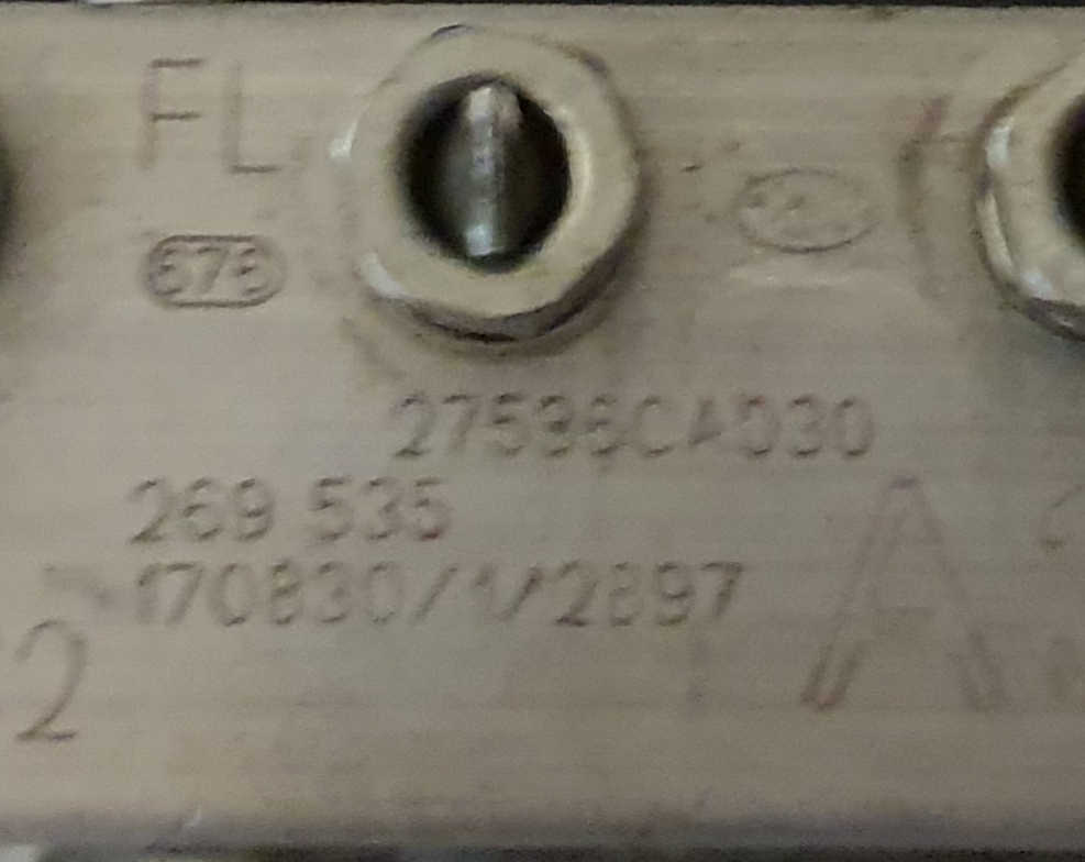

2017 abs module on 16 down
Originally Posted by makinen View Post
Hi,
I've installed a 2017 ABS module from 27536CA030 to 13MY Toyota 86. Now the VSC sport switch should be pressed over 1 second to lit the VSC sport indicator of the cluster. Wow!
Thanks.
Attachment 182860
So weird discovery here.
My unit is a CA040, suggesting it came after your CA030.
Except it wasn’t, it’s 4 months older:

I just ordered a module from a 2019 TRD, let’s hope that does it.
A friend of mine got a good result with a 040 unit on 14MY. 040 is not a problem I guess.
