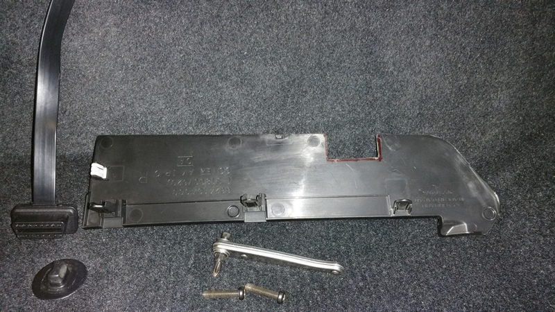

Custom holder with magnet
This is my solution for older FRS/BRZ with split front pannel.
I wanted to use magnet mount but without any glue.
I used Beat-Sonic QBF13 idea. It was simple to make.
I bought magnet mount $21 CAN: https://www.amazon.ca/Magnetic-Phone...017KXRLSS?th=1
I have removed 3M sticking pad from it and it exposed screw so you can disconnect metal ball and plastic base.
I also bough Staples® Stainless Steel/Cork Base Rulers 15 cm for $1.35CAN
https://www.staples.ca/en/Staples-St...6_1-CA_1_20001
I also got 2 metal bars (8mm) from homedepot to do my bent which I have returned after.
Steps to do:
1) bent around 8mm steel bar to create proper shape.
2) Use dremel to round short side to much magnet base
3) Drill hole for to screw in magnet. Carefull make sure that mounting hole small enough for screw to hold. Second hole I made bigger to pass screwdriver trough.
4) First I spray painted it, but it did not look good. (have not waited enough). So I used blackout tape. looked much better.
5) Screw base with ball to bent ruler.
Ruller has cork inside, so it protects panel finish.
Attach as Beat-Sonic QBF13https://www.youtube.com/watch?v=TDiRa--o_5o
This is final result and few steps in between. Took about 45 minutes if you remove failed painting steps and time to plan it.
Works very well, holds my Note 4. Phone rotates a bit, so bottom of the phone touching panel, but it is in perfect position.

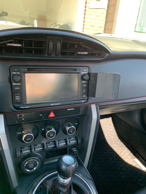

I did it too! Thanks for the help
Originally Posted by extrashaky View Post
No, but that's why there's a tiny turn in it to get around the edge of the head unit. You have to make absolutely sure that the metal sits flush against the side of the head unit before the bezel goes back on, or it won't fit. It's tight.
If you're planning to try this yourself, here are a few more notes:
As long as you're at Harbor Freight, pick up a set of plastic trim tools. They will keep you from marring your dash, and you can slip the corner of one of them under the bezel on the driver's side to get the trim to come up.
The aluminum sheet came from Home Depot. I think it was 18 ga, but it may have been 22 ga. To be honest I can't remember and don't know the gauges by sight. HD also had a three-pack of right, left and center tin snips for $11 that worked fine to cut it.
I cut a long strip first in the width (height) I wanted, bent the end 90 degrees and drilled a hole so that I could mount it in place to mark the tiny bend with a Sharpie. Getting that tiny bend right was the most critical and most difficult part of the project.
Once I had the bend, I test fit it again and used a level to mark a vertical line on the metal as a reference point for the front bend (because the slope of the dash makes it difficult to estimate). Once I had the vertical line for reference, I made another line at a backward angle, because you want your last bend to make the mount tilt back a little bit so that the phone is facing your head and not your chest. Once I had that last bend, I cut it to the right size for the cradle and dressed the edges with a grinding stone on a Dremel.
You will notice that the bracket has a big hole in it. That's because, once it's bent in the way, you can't reach the bolt! Imagine my irritation when I realized I couldn't actually mount it. I cut that hole so I could fit a socket on an extension through there.
As you can see from the pic of the bracket, paint does not want to stick to aluminum. I used self-etching primer and flat black Rustoleum. At some point I might pull it off there and try again.
I used "industrial-strength" velcro to attach the iOttie cradle. I would prefer to mount it a little more securely, but I had to be able to remove the cradle to get to my socket hole if I ever want to remove it. If you come up with a good alternative, please post!
Here are links to the less-common tools I used:
Harbor Freight seamer
HF trim tools
Tin snips (were $11 when I bought them)
[ame="http://www.amazon.com/iOttie-Windshield-Dashboard-One-Retail-Packaging-Black/dp/B007FHX9OK/ref=sr_1_2?ie=UTF8&qid=1426687749&sr=8-2"]iOttie One Touch[/ame] - the cradle I used. The unused suction mount is sitting on my desk, waiting for me to repurpose it for something else.
By the time it was all over, I had more money in the project than I would have spent on a commercial mount. But no commercial mounts put the phone where I wanted it, so it was 100% worth it. Plus I now have a few more tools in my tool box that I needed anyway.
I also wanted to share that is doable and worth it. You get to add some new tools to your collection while making a nice mount. Some notes from my experience:
1. My primary goal was to make something that can hold the phone during any track day, when oil temps and coolant temps are most necessary to view. Any suction or vent clip holder will not work, the iPhone XR + case is too heavy.
2. I also used the seamer from HF (Thank you!!) but a found a vice grip and a hammer helped too. If you have a drill attachment that lets you tighten the bolt from an angle (i forgot the name of it) then you don't need to drill an extra hole on the phone holder surface.
3. For this to work, the phone holder has to have a flat back. I found the MPow brand makes a perfectly flat back, minus the middle piece. i used a dremel and file to sand that flat. then i used 3M double sided tape.
4. The store I went to only has 22 gauge metal. After completing it, I would've liked to use 18 gauge. It's slightly bendy n hard bumps, but not a problem.
5. I used a truck bed paint to give it one coat for a texted finish. I found flat black showed too much of my sanding and dremel work.
6. I would recommend using the edge of a hard surface, and a hammer to enunciate any metal bends you make.
Looks good. Nice job!
