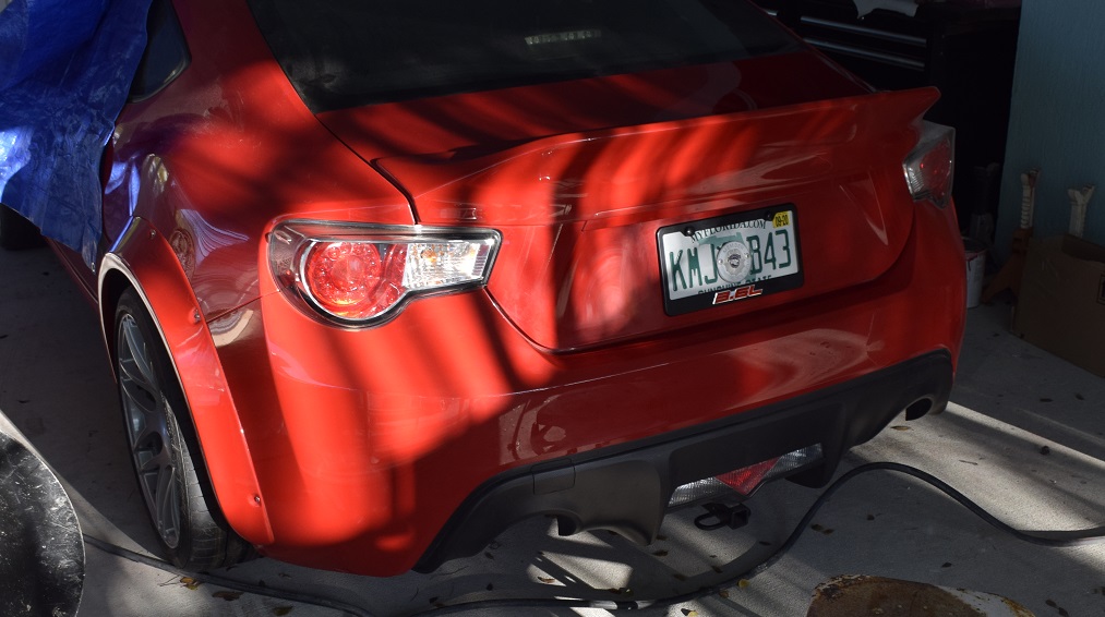

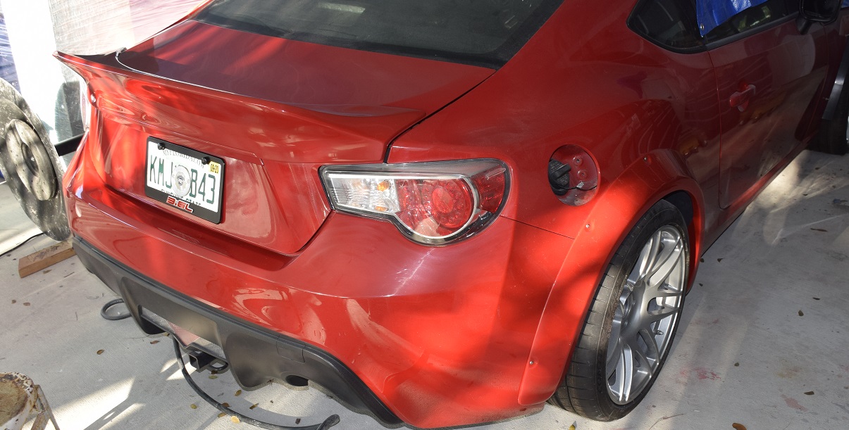

Sanded with 1500,, buffed and installed. Fronts aren't done as the bumper isn't installed.

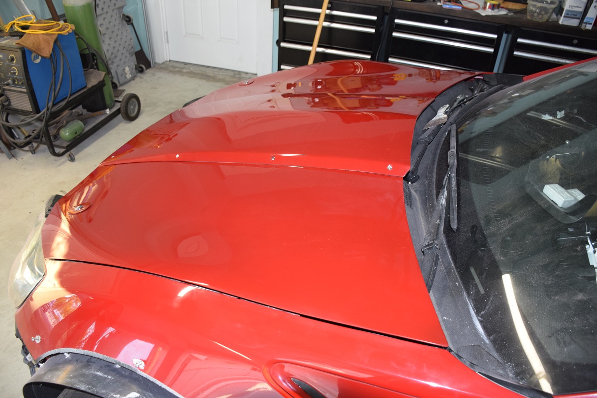

Paint is complete. Still need to sand and buff hood and scoop. Hoods got a lot of crap in the paint for some reason. We'll see what tomorrow brings with sanding and buffing. I also painted an aftermarket emblem for the front bumper. Wanted to shave it all together but the shape of the bumper really needs an emblem. Filled in the SCION. Not 100% sure I like it.

A few final shots of the paint work......

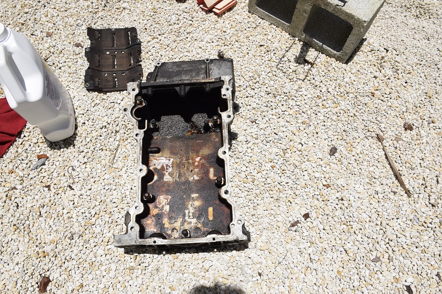

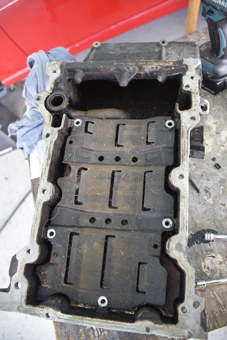

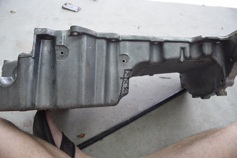

I've also come to the conclusion the oil pan is a bit too close (for comfort) to the sway bar. I had bought an additional Oil Pan some time back so spent some time working on it this weekend. First problem the pan was nasty,, and I do mean nasty. Opted to clean it up myself. Made a redneck hot tank and cooked it for 3-4 hours. Did pretty well but should of put more degreaser in it. Hit it with brake cleaner, small wire brush then pressure cleaned. All in all came out OK.
OK for the modification. The back of the sump is just too close. You can see in the picture the area 'X'ed, just need 3/4" or so and I'll be happy. Like to have it cut up this week and sent out for welding.
