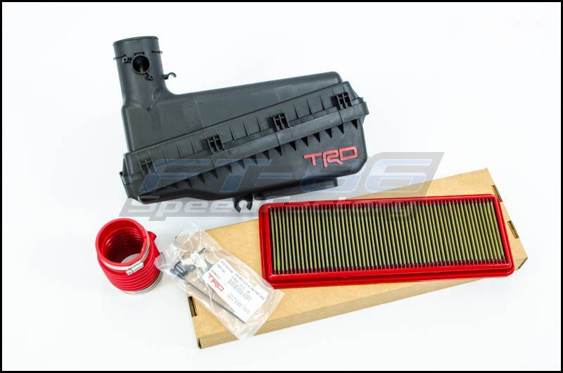

APPLE = TRD airfilter size?
The TRD media is a oil filter, but, is 4 ply.
Assumption: The TRD being a thicker media would be more restrictive than the K&N type.
Conclusion: could someone count the pleats and post up the dimensions of the TRD to compare against the m2 of all the other filters.
I acknowledge that the elephant in the room is the filter media, but, these comparisons are fun, and if a TRD intake filter is measurably better than a 17+ intake I might get a TRD intake.
As for the efficiency of the K&N, well it breaths effortlessly, but it only really stops rocks and leaves.
From my old eyes looking at a computer screen I counted 57 folds on that supersized TDR filter. If we assume its the same depth (27mm) then you are looking at lot of m2.
Which one?
Cotton has 15
K&N style has 34
Need dimensions of width, length and height to work out area.
Mute point as my 2017 OEM airbox with a K&N filter is not showing up as an restriction, even running a little AVO turvo.
It also wasn't showing as a restriction with the OEM paper filter when NA tuned, it did have a Mishimoto intake tube though, more to aid in a clean removal the noise tube than for performance.
For what it's worth, the TRD intake looks only slightly smaller than the OEM intake on a R33 GTR, which can flow 500hp all day.
And as the TRD intake on the twins is only ever going to flow around 200hp, I would say the size is overkill.
Yes there are variables, but in the end if there isn't a restriction, a bigger box or filter is not required.
A high flow filter in the OEM airbox is all that is required for unrestricted flow and ease of maintenance, as long as you are comfortable with the less efficient filtration of a high flow filter.

I think you're looking at the drop in filters for the stock 13+ and 17+ models.
The one we are talking about is from the TRD Intake pictured here.
Its huge.
Its huge.
Yeah, opps
That thing is huge
Massive bling overkill IMO
Meh, consumers will consume

I think the OP (@prandelia) was pleased with its increase over the typical cheapo set-up after tuning, and by the looks they have built as a proper NA trackcar.
Which is no surprise really - to have almost identical maf readings with significantly less airflow resistance, should mean that not only should tuning be a little easier, but the many stock ecu maps looked-up by its built in learning software will naturally make the car more likely to avoid knocks without pulling back too much power, making the tuner changes able to go a little higher.
In theory anyway - I'm no master tuner.

Bling? It looks like a factory airbox.
I got one for a good price and it definitely cleans up the look of the engine bay and deletes all the sound tubing. It wouldn't be my first suggestion for mods, but it's one of the few intakes with a good track record and it doesn't void any warranty.
