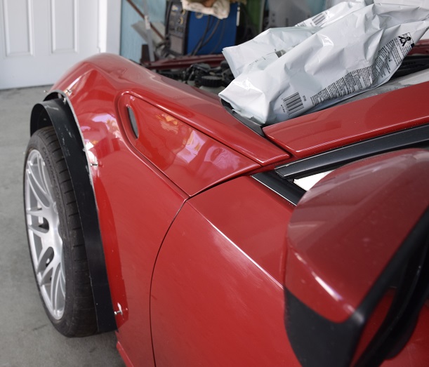

Did you have to paint over the textured black plastic inside the 'vent hole' here?

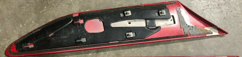

Originally Posted by Infinity View Post
I mean like remove the black plastic, cut out the embossed emblem and weld it back on, and then reattach the black plastic. It looks like it may make the whole process a bit easier.
Gotcha,,, you may have a point. Not sure how hard it'd be to pull the black plastic off though. I had to go find a picture of what the back looked like stock,, got one off ebay and it's below. I clearly had to cut some of the black plastic off to do the welding,, I think I used what I cut off as filler during the welding. Again I think I should of gotten the HF plastic welding kit for at least the filler rod.
It's covered so hopefully no paints getting on it.

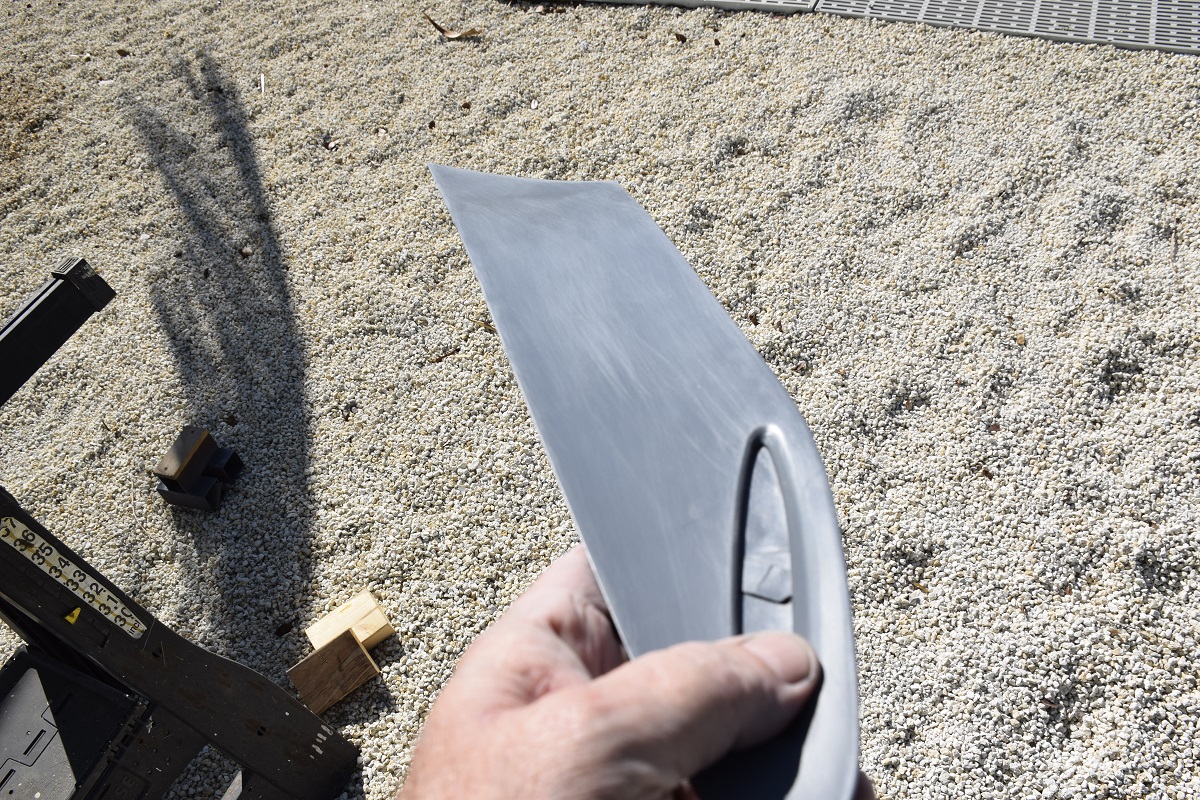

Body work continues.
I bought paint this week,, went with Axalta (Dupont) their mid tier Chromabase stuff,, it's base coat, clear coat. Have 1 gallon color and just over a gallon clear for right at $400,, should be way more than needed. I took the gas cap off to take to then and gave them color code so the color looks pretty good,,, going to shoot the fender garnishes and the backers for the hood locks to see if it's close. That'll happen later this week.

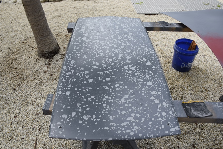

Hood scoop is done and ready for paint,,, work on hood continues. I've sanded both sides but I need a bit more glazing putty and primer in the corners that were bent. As the hood is kind of a cowl induction hood,, which I don't want or need,, I'll need to block off the high pressure air access at the base of the windshield. I'm thinking just cut and shape and some aluminum to bloc the flow.
As for the pictures.. first is when you put epoxy primer on outside and it rains,, looks like grey camo. Sands out fine,,, well at least I hope.. Next old schools hood locks,, painting the backing plates on both sides body color. Next are just a few of the hood,, it's been a lot of work between the scoop and the hood. Last shows the cowl induction area that needs to be closed.

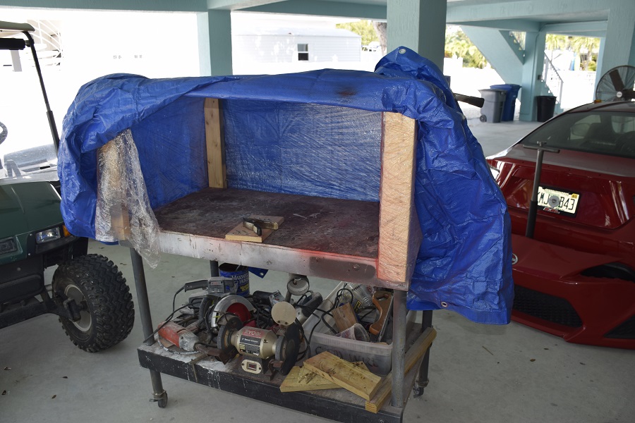

A few updates. I’ve been moving closer to paint but the amount of water I’m getting when shooting primer had become a problem. I opted to make a water separator out of ¾” copper pipes,, saw it on the internet so must work right?? It seems to help. Added a HF filter as well,,, what a piece of crap. On my 2nd one and this one leaks.

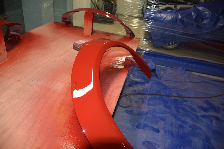

Good news is I got the paint on the garnishes last weekend. Color isn't perfect but close enough to move ahead. I painted them Saturday, on Sunday scuffed them with 1500 sandpaper to get the crap out of the paint. I was surprised how easily they sanded,, guess the clear was still soft,, buffed them out and they are as smooth as a babys butt. All in all they look pretty good. I reinstalled with some 3M VHB tape. I did get a very small crack where I welded it on the driver side while I was pushing on it to seat the tape. Not bad enough to do anything about it.

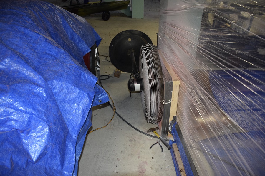

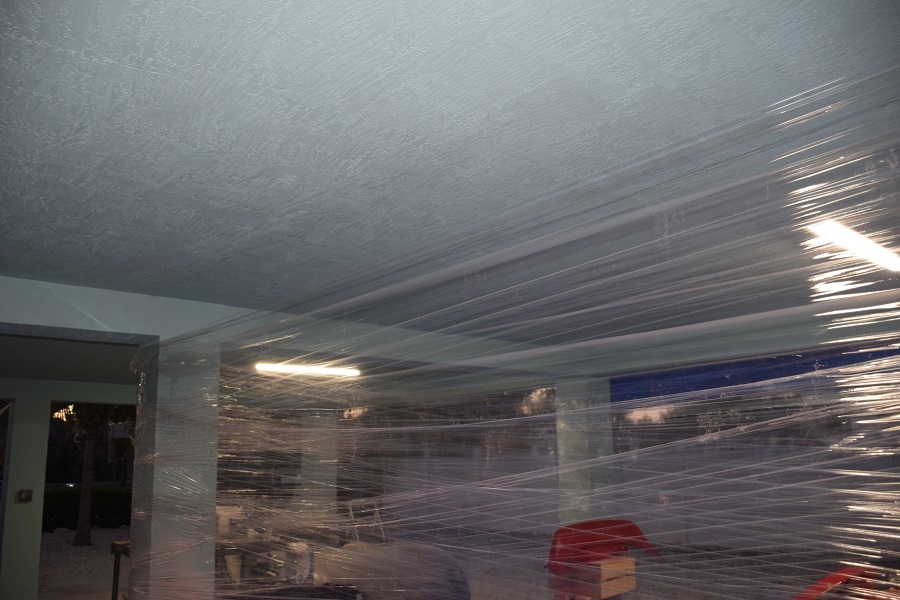

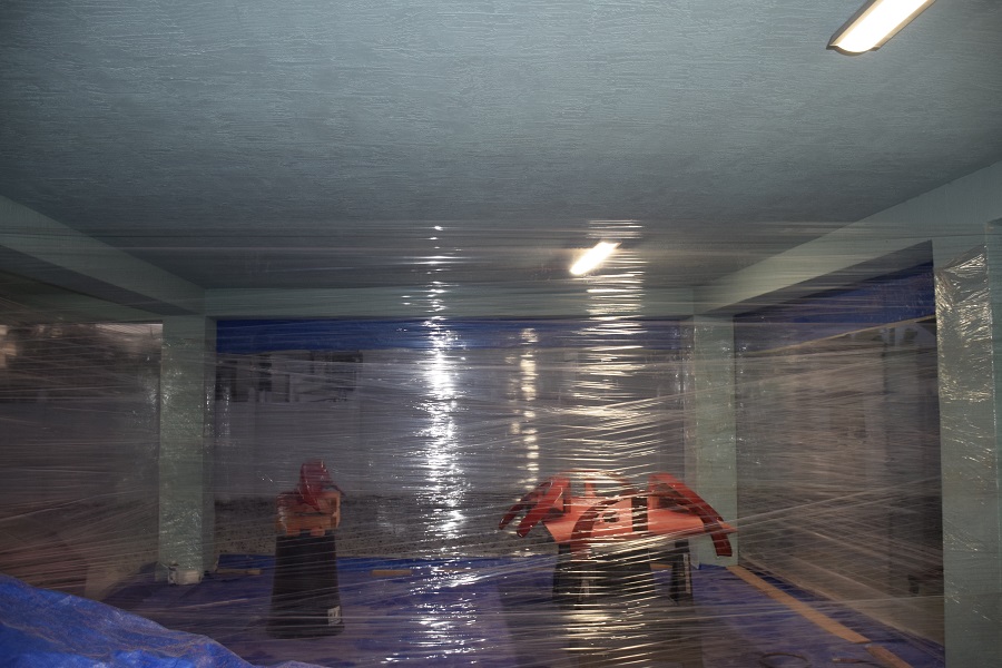

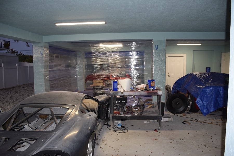

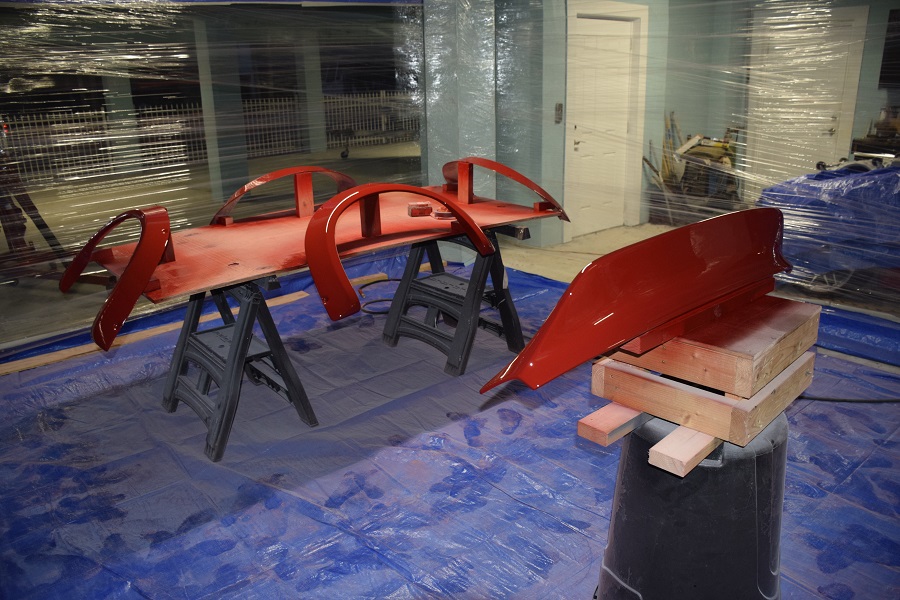

Moving forward with paint work. Made a paint booth,,, sort of. I don't have a garage as my home is on stilts. I wrapped four stilts with palate wrap to create a paint booth of sorts. Not perfect but worked quite well. As the wind was out of the north east, I totally blocked the north and east side,, left the south and west side open at the top. I had my shop fan providing air in the booth,, filtered with 4 ac filters. The bad news is I had to get on the floor and shimmy under the plastic to get in the booth,, tough when you're almost 62,, and there were 7 coats.
That said paint looks really good I'll scuff with 1500 tomorrow then buff. Next weekend I'll paint the hood and scoop.
