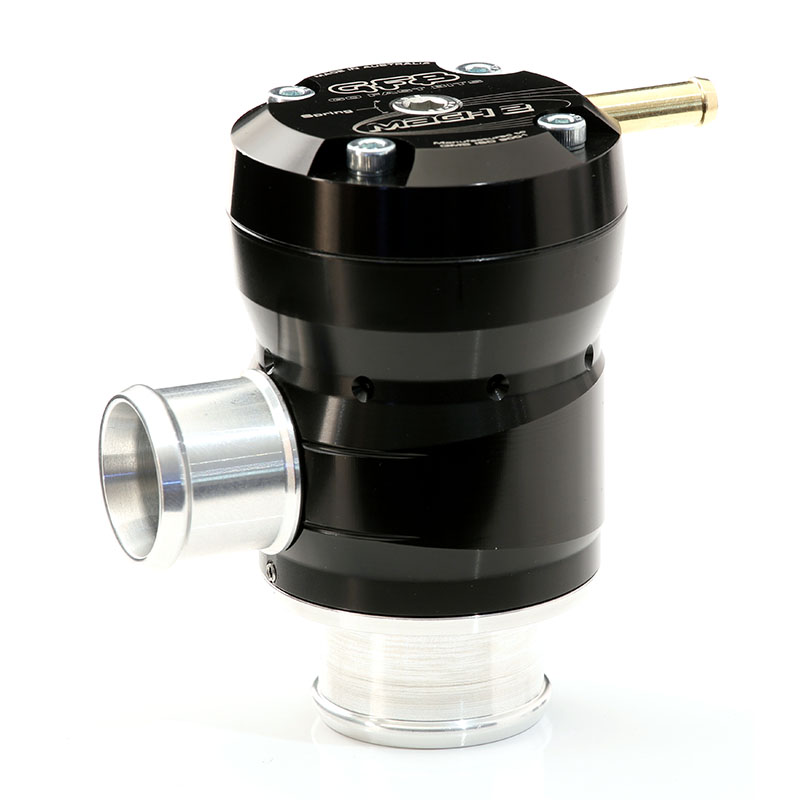

Recirc valve upgrade?
Has anyone replaced their recirc valve?
If so, what did you go with?
Looking to possibly replace it with a Mach 2 unit from GoFastBits.
Any recommendations in recirc/bypass valves?
Sent from my SM-G965W using Tapatalk
I used a cheap RKX, it works okay. Others used Turbosmart which is more expensive. JR recommends using the softest springs to ensure Rotrex unit is protected from surge. You need 25mm inlet and outlet size if I remember correctly. If you search the thread you can find more information.
Just curious; if replacing the recirc valve (with softest spring available), would a retune be needed? or recomended? thx!
Enviado desde mi SM-A730F mediante Tapatalk
Recirc valve replacement does not need retune.
