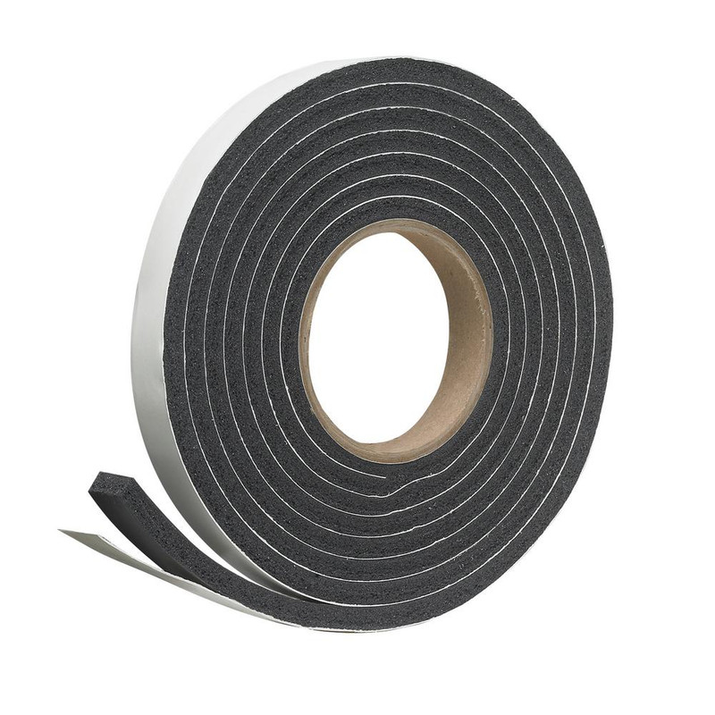

Over the weekend I picked up a roll of gap seal tape from a korean store for $2 and went ham on all the creaky and buzzy spots in the interior. It's like a different car now, completely free of all the interior noises. And it only took about 10 minutes
I see you have a 17 86 as well, i have always since new from factory had this metallic buzzing sound that seems to be coming somewhere from the steering column and only hear it cruising on the freeway at around 2600rpm, what are all the spots you had buzzing and put this to fix it?
No buzzing from the steering column, but I had creaking from the driver seat belt attachment, which I pinpointed to the cable that's there, so I basically put some padding around the cable. Then bottom of A pillar windows and along the A pillar and windshield, under the plastic transmission tunnel cover where it comes into contact with the dash, and some at the bottom outside corners of the windshield as well, where the speakers are.
