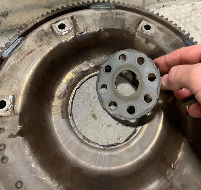

Flexplate broke, replaced that and the torque converter. Everything was great for about 3 days but unfortunately now the rattling/tick is bacl. Not as bad as before(yet?), made no sound at all for about 240-280~ or so miles(about the same as last time). Back in the shop now. Any idea's for what could cause it? Original diagnosis was the flexplate just had pre-existing damage that wasn't noticed.
video of the rattling from inside of the car after a cold start. The rattle is occuring anytime I move it out of park, but also happens on first start up.

Something is tweaked. Gotta find a shop that knows how to use a dial indicator to look for runout. Don't drive it like that because you're just killing your engine and transmission with that misalignment.
Dropped it off at the shopas soon as the noise was happening again.
Flexplate cracked again, thinks I could have a bad transmission, or unbalanced crank. Also it was noticed that dowel pins were missing. From what I can tell from my limited google-ese, they're to align the tranny to the motor, I would imagine they would also limit the play going on.
Missing guide pins are the root cause of your issue. Shame on the mechanics first for losing them, and then subsequently ignoring their absence. That's day-1 shit.
F
To be faaiiirrrr it's a really reputable and popular shop, the two dowel pins are supposed to be in the engine from my understanding and not come out. For whatever reason it seems like a crapshoot of whether they come out during the removal and stay in the transmission I guess. He didn't lose them, the motor came without them in. These aren't the pins that would go on a flywheel, they're literally pressed into the engine block.
You're being nice. Any mech with a lick of experience knows that there are always two guide pins. That's either a rookie mistake, or no fucks given.
They fall out all the time. It's a thing.

Yeah it's a toss up wether they stick to the engine or trans when you separate both. Whenever I replace an engine or trans for a used unit, there can be two, one or none at all, and yeah it's pretty important to have them in.
I'm surprised a mechanic would forget them since they make mating the engine to the trans way easier by lining everything up. You align those and the two big puzzle pieces just snap together and every bolt hole lines up perfect. Would be a pain without those.
Btw, I'm not sure if I'd be confident in that engine anymore, if the transmission was misaligned enough to break the flex plate, it probably put a lot of stress on the rear most crank bearing especially during startup with no lubrication. I wouldn't be surprised if the rear main was scored from having the crank wedged off axis.
