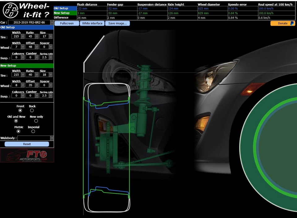

thx for the info
here is ur setup in the calculator
which is 10mm spacer
it looks like same as stock setup at space around suspension component
don't really wanna spacer
make me worried more
do u have any rubbing problem without spacer with -1.5 camber at front?
i have 10mm close to the suspension component
jayliu.jiayu@gamil.com is offline   Reply With Quote

Originally Posted by jayliu.jiayu@gamil.com View Post
Attachment 179979
thx for the info
Yes, the difference is only 0.3mm, you will want more than a 10mm.
Yes, it was too close.
I'd suggest that you get 20 or 25mm bolt on spacers. You will have plenty of room between the spring perch and tire/wheel to add camber, they will look flush, and they are easy to install.
I LIKE TIRES!
get some info on facebook gt86 local group
it looks like i will be fine!
i man sure i will back to this and post the result
next Thursday it is the day
