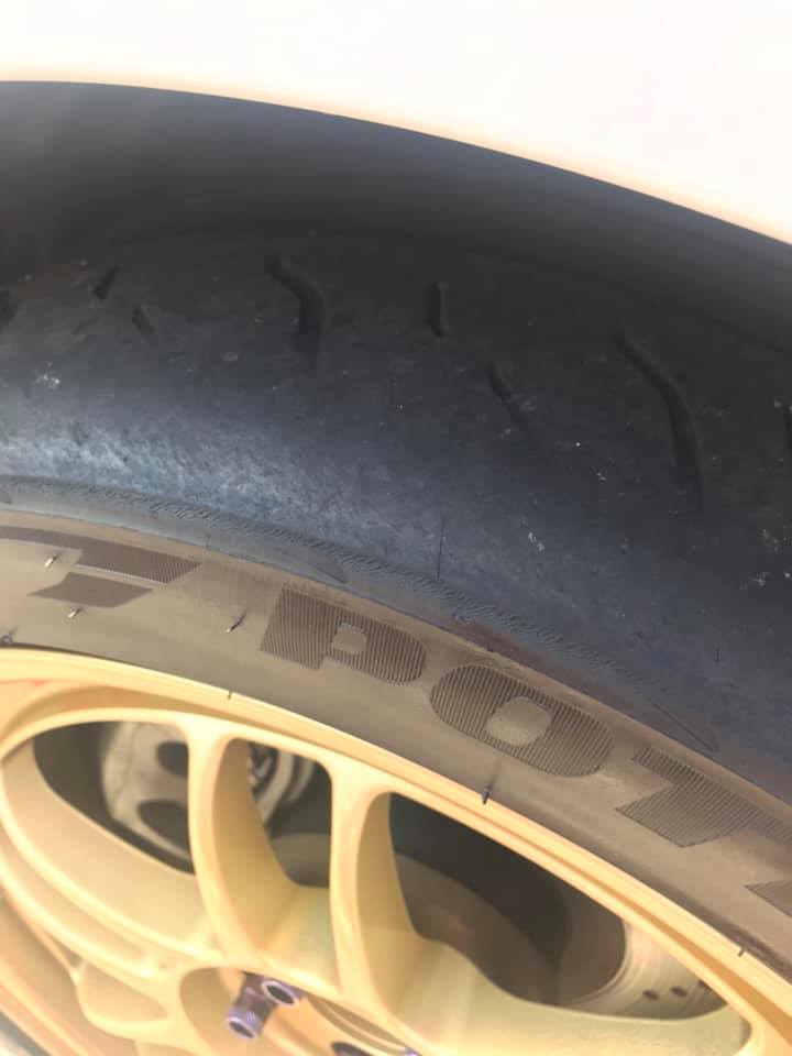

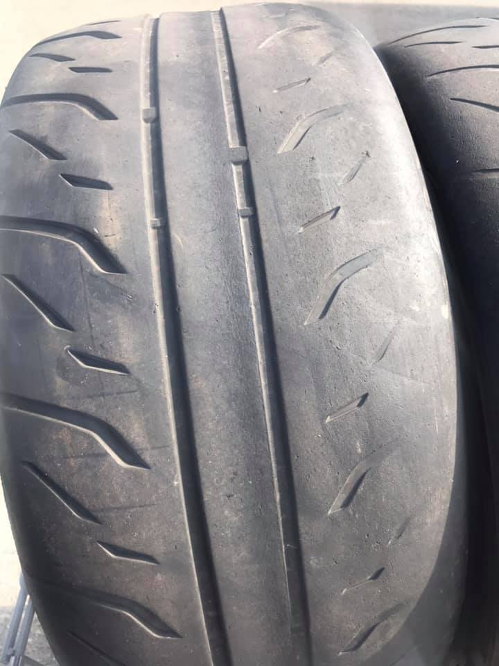

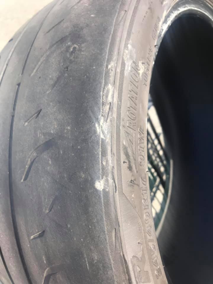

i am on the stock suspension
running on
rpf1 17x8 +45 re71r 245 40 17 both front and rear
going to install a camber blot for less tire wearing on the front on the track
here the peek for my front tire after one track day
Attachment 179955
Attachment 179956
Attachment 179957
the number i am hope on alignment
front
-1.5 camber
0 toe
rear
-1.0 camber
0 toe
anyone have the experience with this size setup and some camber
could conform no rubbing issue or anything

For track insufficient camber chosen imho. Due more front camber then stock aignment (of 0 camber front) you'll get less understeer, but insufficient camber for even -track- tire wear. In relation to track/HPDE usually i see something like -3 front/-2.5 rear camber, but of course it can be tire dependent and should be dialed right using temp readings of pyrometer.
wparsons 07-30-2019 02:16 PM
-1.5* isn't going to be anywhere near enough to fully fix that, but it will help slightly. You'll need -3* at a minimum with those tires.
