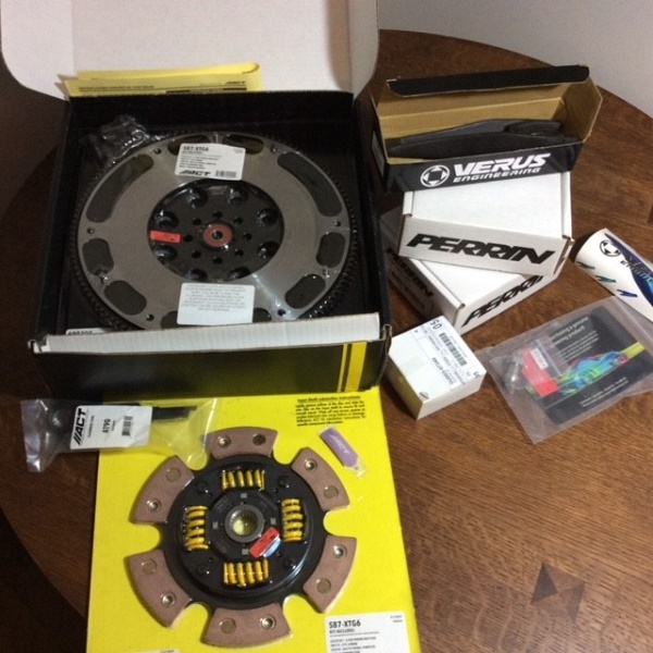

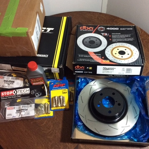

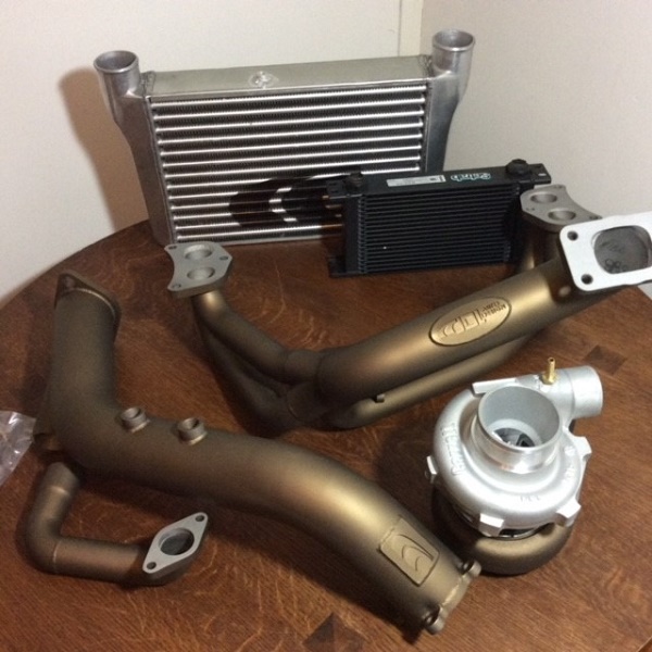

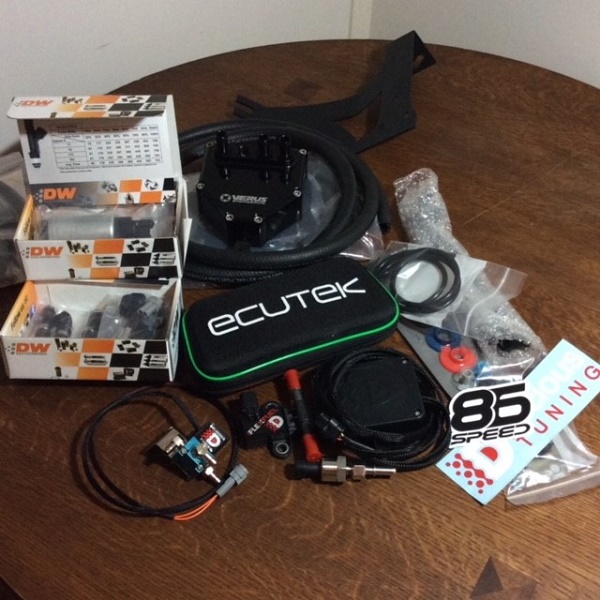

Parts have arrived.

Yeah I cant wait for that boost! I've been planning this for like a year and finally was able to pull the trigger... I'm having a local performance shop help me install everything starting next week!. Delicious E-tune. I paid for the flash-and go tune anyways, but the shop has a Dyno and says they could tune it... https://www.ft86club.com/forums/showthread.php?t=134692
