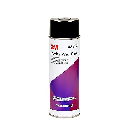

It's cavity wax. Look under/around any new car and the stuff is everywhere. We're supposed to reapply it to any bolts/nut/panel we touch.

Are you saying that NOW the OP's trunk is going to fall off?
humfrz
Wax, not glue!
3M has it in aerosol cans, we get it in a little brush-cap tin or liquid you spray in, using a fancy paint gun with a tube on it.
They paint it on everything to help with corrosion, especially on hardware and... cavities.

I had a discussion on this with my dealer some years ago. In certain geographic regions this is added by the factory. You can find it in different areas of the car and even on the engine. The instruction was to NOT REMOVE. It is used for protection.
Check an engine from a new WRX STI sold here:
(similar on the BRZ engine)
Fact is after some time it looks ugly and dirty, but I would say better to have more protection than looking nice and shiny with less protection.
