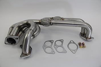

Got the header and I can post some pics. I sold off the exhaust off my car (waiting on TRD Japan parts to come in) so no on vehicle impression yet.
Some details:
1) Welds look fine. Similar to OFH. Some small parts look like pin holes but confirmed no burn through with a light.
2) Mating surface to block is not machined which is...concerning. The gaskets they include are the "thick" style ones which should hold but I dont think you could get away with stock style gaskest which are much thinner. I will still run some copper gasket maker on them.
3) Flex section is the accordion style + the braided steel on top of it. Doest look like a source of leaks.
4) O2 bungs are good. I've had issues with the OFH ones before but these ones the sensors thread in fine.
5) Collector looks fine from what I can see.
I can post some pics if people are curious but nothing too surprising. I may install it this weekend if I have time.

Do you have the UEL or long tube? My UEL flex pipes are just braided, no piping underneath, so everything leaks out of it. I owned these headers for a couple months now and i know the construction of my header. This is the exact one i have:
https://images-na.ssl-images-amazon....UL._SX355_.jpg
It leaks, you can smell it and feel the heat and air escaping through the two flex pipes.
