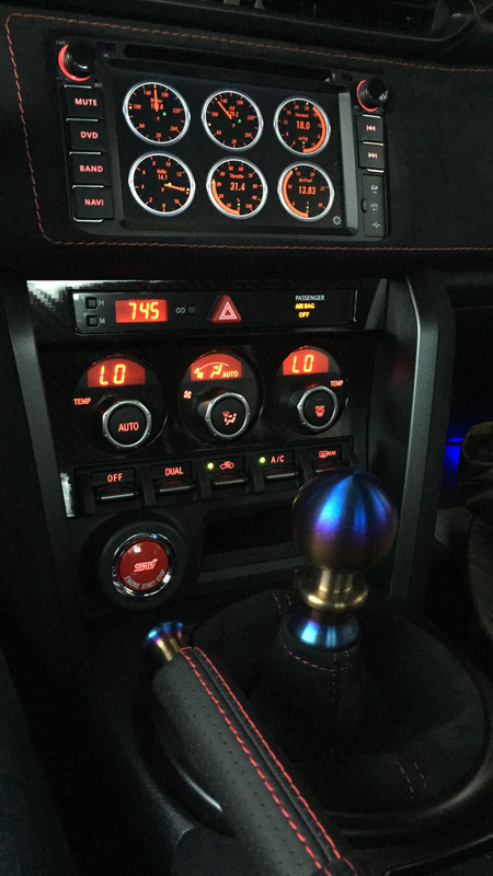

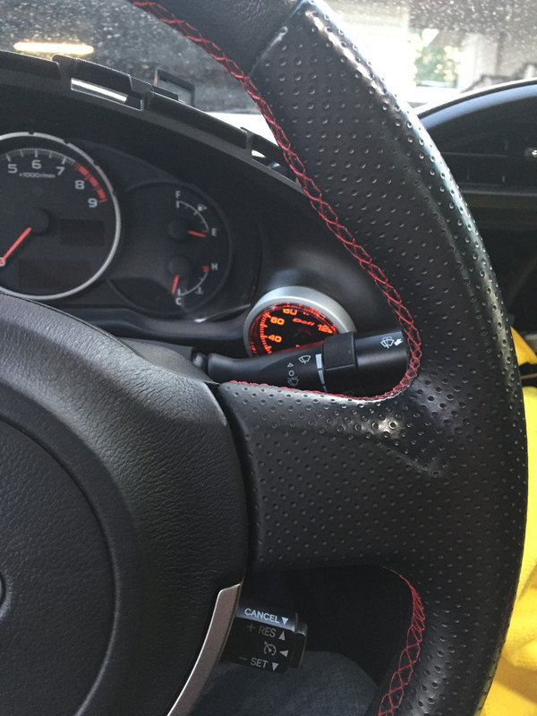

Adding gauges to the brz is something i've thought about a lot. I bought one of those crappy joying headunits from china just so I could run Torque Pro and monitor stuff straight from the ODB. Sadly, you cannot monitor oil pressure from the ODB so I am resorting to other means.
I really enoy this Gauge Pod Setup by ortizcustompods. It's very clean and OEM looking, which is what I am going for with the interior.
They offer it in a single pod version as well so I went ahead and put the order in for that! It's about a 5-6 week lead time since they are made to order so I have a little bit of time before it arrives.
I hit up the trusty autoharnesshouse to build me a jumper harness so I can easily run power to my gauge without having to cut or splice or tap my stock wiring. Something I am adamant about is not cutting into or splicing any of the stock wiring harness, so hooking up electronics takes a bit more effort but very worth while in the end to have something built right without fear of failure (or fire).
(Not the one I ordered but very very similar, will take and post a picture once I receive it)
I used Defi Racer Gauges in my 240sx and loved them, so it seemed fitting to carry that tradition over to this new car. I'll be purchasing a Defi Red Racer Oil Pressure Gauge
Simple and it will match the red interior lights well!

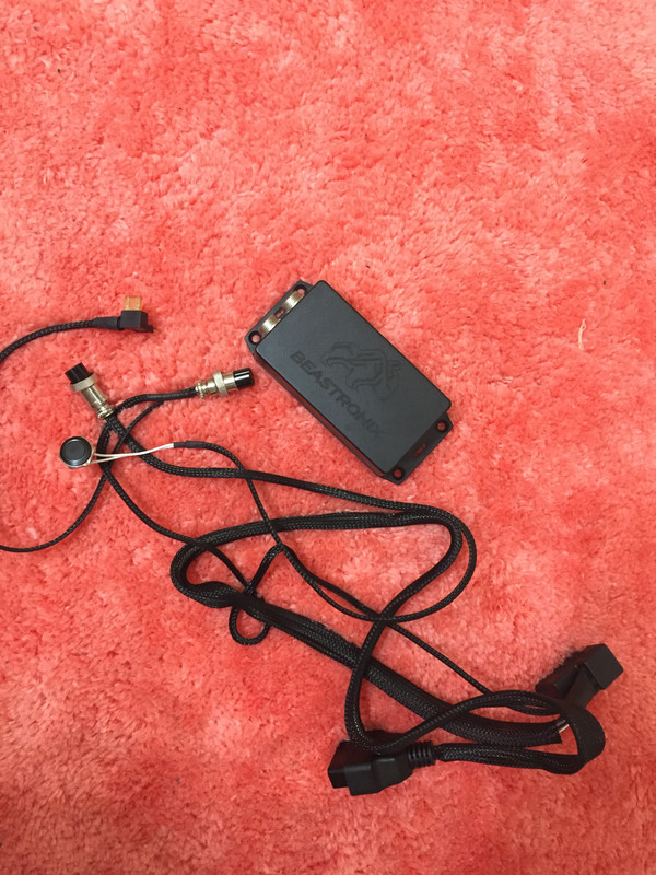

For the the 86 Nanny, this is more of a want than a need. I have been getting by with just "holding down the button for 3 seconds" but I know that doesn't fully disable the TC, nor does it affect the ABS.
I need something that could be turn off with the flick of a switch. Sadly getting an 86 Nanny seems tough these days. As luck would have it though, I came across someone on the forums who was thinking about selling theirs so I told them I would buy it when they were ready. Well I got the message I had been waiting for last week and he was ready to sell!
Originally I was planning to run a couple toggle or rocker switches to control it. I bought the the really nice Toggle Switch Insert in blank form, as I was still hashing out the plans for the Nanny. I am all about clean, functional, and oem looking interiors so this fit the bill.
However! Plans change. The owner of the 86 Nanny I was buying informed me his was a custom model that uses a single monetary push button switch to control everything instead of toggles or rockers. This is actually a huge benefit in my book! Since I own a push-to-start brz, I have a blank spot where my ignition would be! I plan to attach this button to that spot. I feel like this is the perfect place for something of this nature. It's out of the way and will not accidentally be pushed by anyone. It is programmed for: 1 press = pedal dance + TPMS disable, 2 press = PD + TPMS + ABS off, 1 hold = fans on high until held again.
Simple and easy!

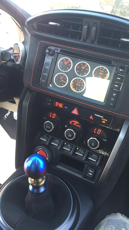

I wasn't going to upgrade the interior anymore for a while, but the way my mind works is this: I had the stereo removed already, I was also upgrading to the tS black interior bits, so I might as well install an armrest while I'm at it! I bought a alcantara armrest off ebay.. The fabric is nice but you can tell the quality is a bit lacking with the plastic. Going OEM and having it re-done would of been costly so this is a sacrifice I had to make.

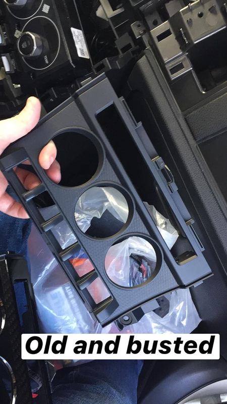

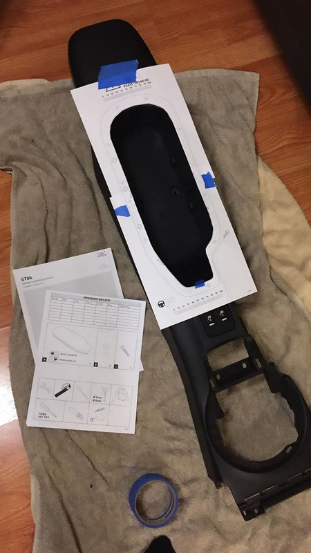

Since I had the center console out, I decided to bolt on the new armrest with hardware I got from home depot. It's a nice solid install and the armest looks and feels great!
The OEM template worked good but getting it taped on in place was tough. I didn't want the armrest to be crooked. It came out good and I did have to do some eyeballing to get it as straight as possible.
Looks great and feels good! Should of came factory.

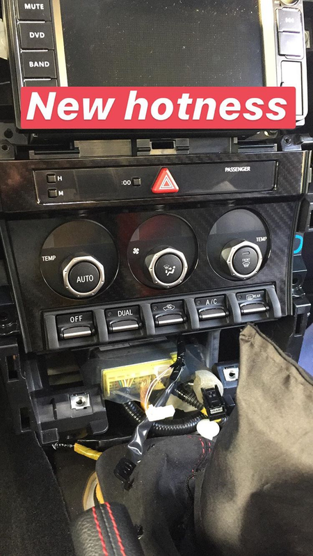

I bought a 2017+ CF style climate control panel from a guy on FB marketplace for 20 bucks! SO I swapped that in too while I had the interior ripped apart.
This looks REALLY GOOD with the tS interior bits. They are a subtle black gloss sparkle. I enjoy them more than the flat black ones I had previously. Those look good, but these look better
I damaged my ebrake handle when removing the stock button last year and it has always bothered my OCD-ness. Since I had the interior ripped apart, I figured I would send it away to SWEIDIT to have to redone.
I had it wrapped in Perforated leather to match the steering wheel!
It looks great and feels great. I have plans to get the OEM wheel re-done by them as well, so this will look awesome with it. I have had them do other interior bits for me in the past so I always love to send DIY and small independent businesses in the industry my money and support.

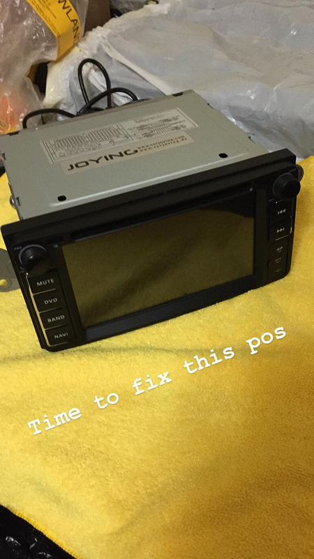

I also had the headunit out to try and see if I could fix the touchscreen issue. I fixed a couple loose pieces but nothing seemed to fix the problem. Thankfully past me set up the unit so the Torque Pro app starts on startup, so the gauges still work lol. cant use the stereo or anything so no music kind of sucks for longer drives

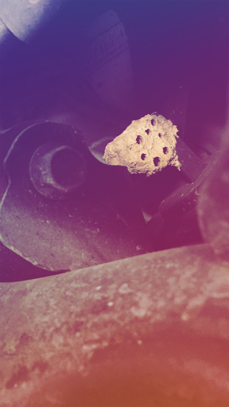

I found this bee? wasp? nest attached to the rear subframe. I am starting my own small batch honey brand so bee on the lookout

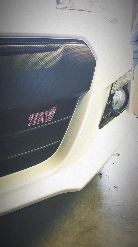

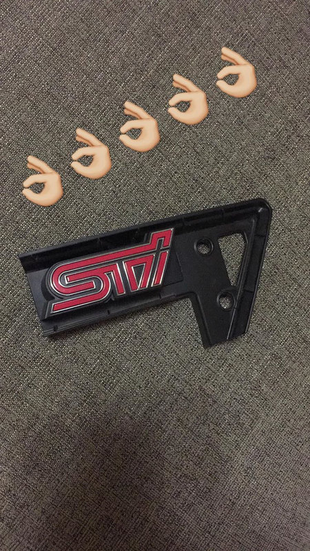

A member on here was selling a STI badge so I swooped on it. I was planning on one anyway but this one is in awesome shape so woo hoo!
Install was pretty easy with the car off the ground. I removed the two lower plastic panels to get access to the back of the bumper. It looks a little crooked but I haven't check it out on flat ground yet so more to follow on that..

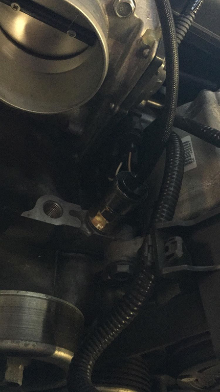

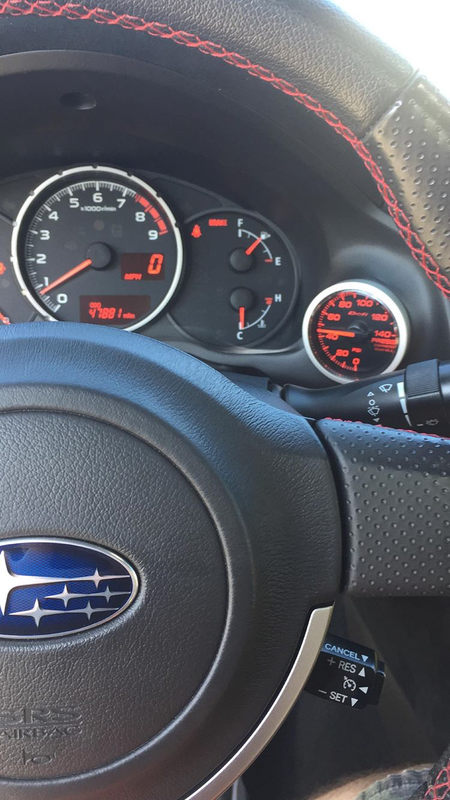

Installing the oil pressure gauge came next and that proved to be a bit tricky...

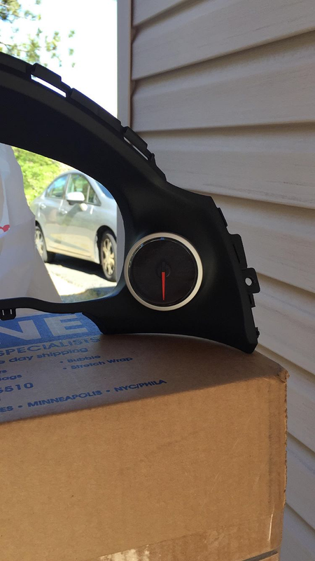

I bought a DEFI Red Racer Oil Pressure Gauge. I've used DEFI gauges in the past and they have always been a great choice. High quality parts with easy to follow instructions and come with sensors so it's a plug and play type deal.

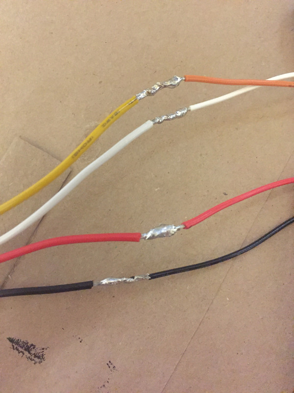

I had autoharnesshouse build me a splitter/lead/breakaway harness for the DEFI gauge. One thing I am adamant about on cars, especially newer ones, is to not cut or splice anything into the cars chassis harness. I've seen way too many poor wiring jobs that have wrecked cars and created tons of headaches in the past that I will never cut into a cars harness.
The harness came built as I requested it and it was as simple as soldering the DEFI harness into this one, and plugging it into the BRZ 10-pin harness for the stereo.

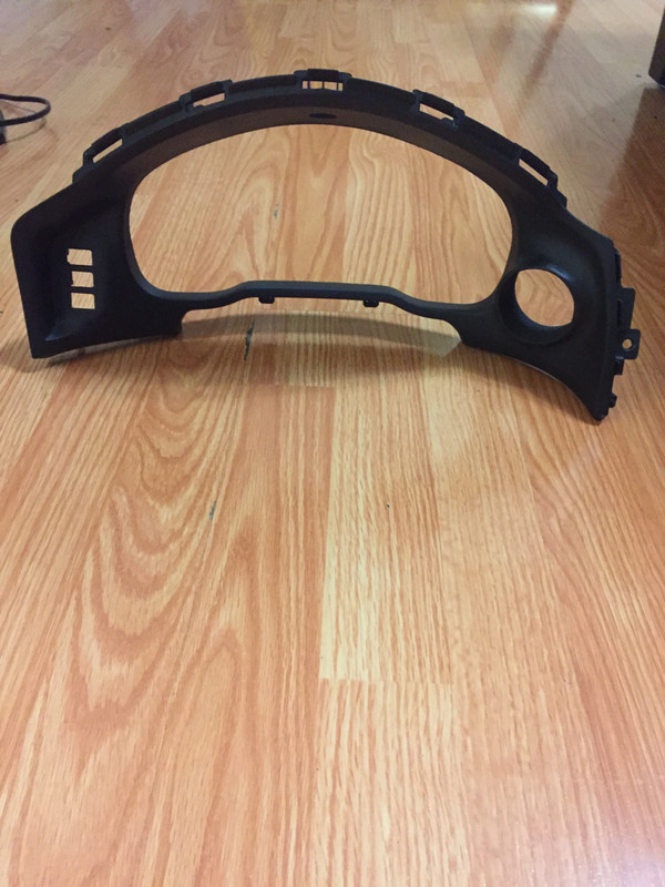

I am all for clean, oem like installs so getting the ortizcustompod to house the gauge was a no brainer
This makes great use of unused space! Plus, it keeps the oil pressure in a good sight line as well for quick glances.
The DEFI sensor plugs right into the stock oil galley plug, with an adapter purchased from rallysportdirect. Running the wire into the cabin was via the harness plug near the drivers side footwell. There is a nipple like part that you can snip off and run wires through. This sounds easy but I had a hell of a time and used a coat hanger to do it. That rubber is tough and thick!

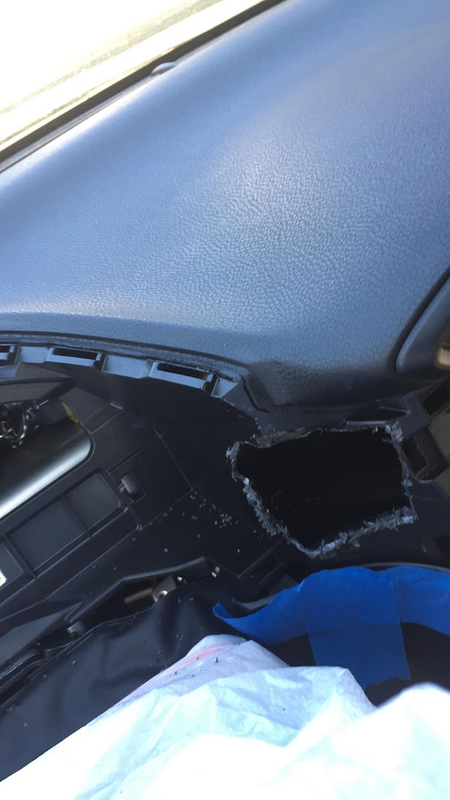

The next challenge was installing the panel/gauge itself.
This was a roadblock for sure. There is NO space for a gauge behind the panel. Maybe if I had a smaller gauge, the DEFI does stick out a ways.
The only remedy to this was cutting a hole in my dash.
Sounds sketchy, but the plastic was pretty thin and there is nothing behind it. I did have to remove the gauge cluster in order to get the hole big enough. I did some trial and error to make the hole as small as possible.
This is what we end up with. Not too bad, but kind of a bummer my dash has a hole it in. I guess you can really consider my car modified now!

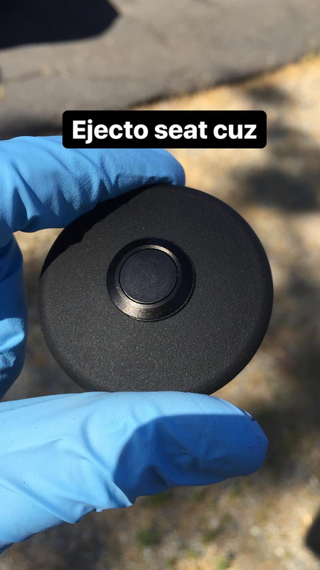

I mentioned previously that I bought the 86 Nanny used from a member here. Everything is setup with a black single push button. I was planning for toggles or switches, but this actually worked out even better, so I jumped on the seller when I saw in a thread he might be getting rid of it. It is programmed for: 1 press = pedal dance + TPMS disable, 2 press = PD + TPMS + ABS off, 1 hold = fans on high until held again.
Simple and easy!
The unit was in great shape! no visible damage and everything looked to be in working order.
I used a step bit and took my time to get the placement and size just right. It isn't dead center, I was lazy and eyeballed it. It's close enough and it's really not that noticeable at all so who cares. I did buy an extra plug just incase but I ended up not using it.
My main worry was that there wouldn't be enough space behind the plug, but this switch is really small. I feel like it was fate this particular 86Nanny went on sale, as this wasn't a standard option for them
Looks super clean! No switches or anything to accidentally touch, or for passengers to play with. Easy to use without moving your hand too far from the driving position either. I haven't road tested it yet, but I did do a function test and everything works flawlessly.

...or maybe a new stereo.. the touchscreen is unresponsive :\
