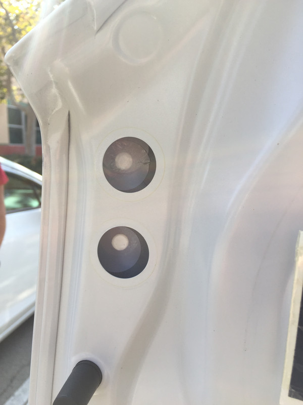

The next day, I was finally able to inspect it. And I found a few things wrong with it. There were several small paint chips on the car, some of them with surface rust already forming. Also, it appeared the front and rear bumpers had been resprayed, as they were a different (brighter) shade of white than the rest of the car. Also, it must have been a rush job, because they did a very very poor job of masking off the mustache and the trim. Disappointed, I felt I had reached a point where I did not even want the car. I quickly realized, the whole point of me buying used instead of new was so I could save some money, and have more available to modify the car, which was always my intention. The money I saved vs. buying new was more than enough to fix the small problems with the car, and still have plenty to modify it.
Waiting at the DMV for vehicle inspection on 02/10/2017:
https://s25.postimg.cc/z70wtuqkv/img_4555.jpg
Here you can get an idea of the mis-matching paint, poor masking, and overspray:
https://s25.postimg.cc/hkt1p2ihb/img_4666.jpg
https://s25.postimg.cc/rw5ehqa6n/img_4674.jpg
Rust pot on fender:
https://s25.postimg.cc/65wkkg64v/img_4600.jpg
Depending on the weather, or lighting conditions, or how clean the car is, sometimes you can't notice it at all:

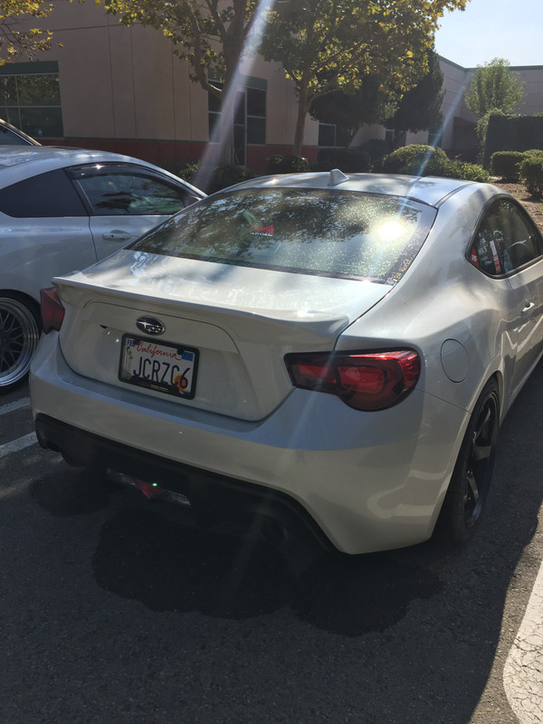

05/10/2017:
Finally got my vanity plate installed! Initials + Chassis code. :D
https://s25.postimg.cc/rfdcg7wun/img_5565.jpg
After this I decided to replace the front and rear bumpers. The mismatched paint, and over spray all over the grill/headlights/fog light housings was just annoying me. I got a great price on the parts, and a buddy of mine recommended a family friend for the paint.

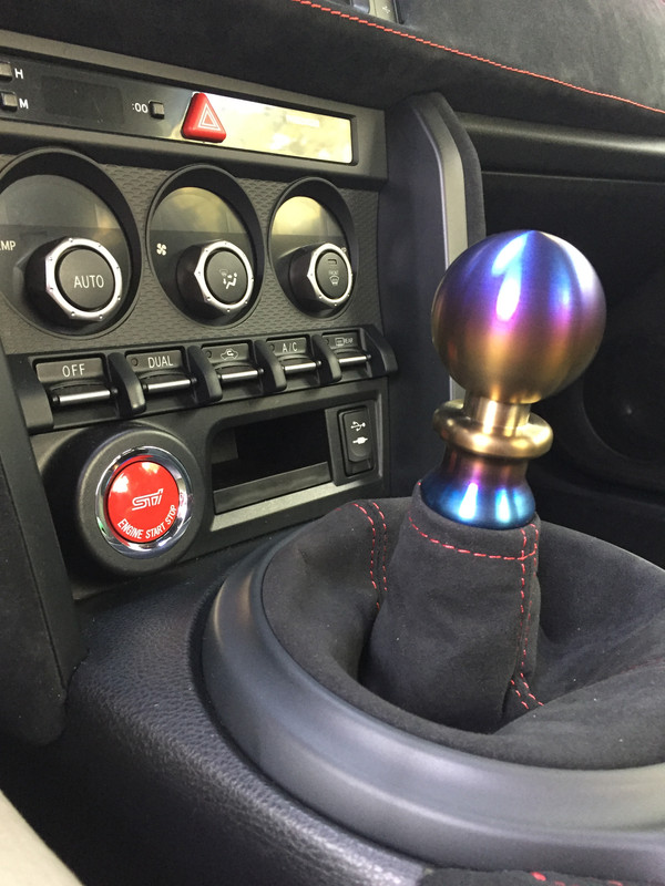

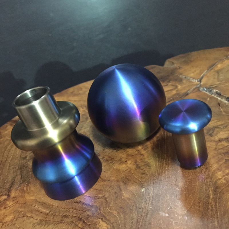

Finally got around to installing my WC Lathewerks Shift Knob, Ebrake button, and Reverse lockout. The heavier weight of the shift knob feels great!
https://i.postimg.cc/2yB18DhZ/3322.jpg
https://i.postimg.cc/ZRn923qj/3419.jpg
https://i.postimg.cc/d0qZRgPb/3421.jpg

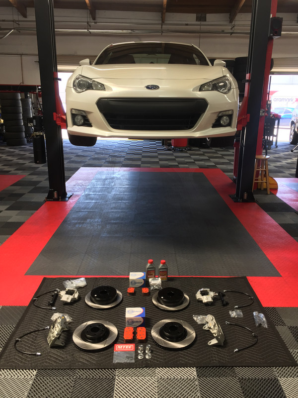

04/26/2018:

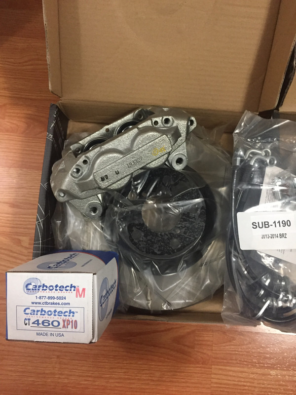

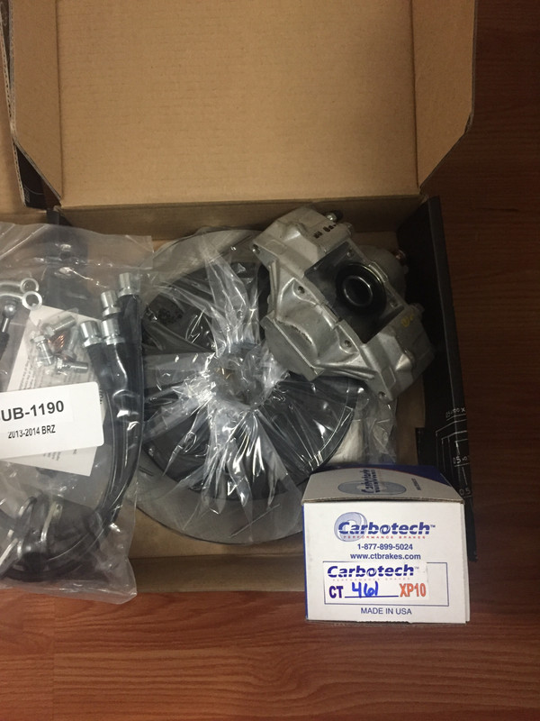

I've also ordered the following parts for the car:
A1 Cardone 2007 Subaru WRX 4 Piston Front Calipers
A1 Cardone 2007 Subaru WRX 2 Piston Rear Calipers
KNS V2 WRX Rear Caliper Brackets
Stoptech Slotted Front Rotors
Stoptech Slotted Rear Rotors
Carbotech XP10 Brake Pads
Yperion Titanium Brake Pad Shims 0.65mm F/R
Chase Bays SS Brake Lines
Battle Version Solid Steering Rack Bushings
M-Tech Shifter Springs
This should set me up with a really nice, solid car for track and mountain use. I decided to go with the "OEM" 4/2 pot setup for a few reasons. I will eventually go with an AP Racing Sprint kit for the front, which based on feedback on this forum, pairs well with the 2 piston rear calipers.
Why did I go with A1 Cardone instead of OEM Subaru? I didn't want painted calipers. After a while, the heat just ruins the finish. The AP Racing calipers are not painted, so will match much better with these once I do that upgrade down the line. A1 Cardone makes great rebuilt calipers for a good price, so it just didn't seem logical to buy brand new ones from Subaru. Plus, I could only find OEM Subaru calipers in red, which would eventually clash with the AP Racing ones.
https://i.postimg.cc/XNZLyBgw/3462.jpg
https://i.postimg.cc/sftcPfnb/3463.jpg
https://i.postimg.cc/XYWkhH68/3464.jpg
So far this setup has been amazing! I haven't gotten any break fade at all! Street driving they feel great too. Now, the XP10 pads are noisy, I won't lie. I have to be really soft on the brake pedal in order to not get a squeal. I do not daily this car, so I really don't mind the noise, but that is something to consider.
I could swap between street/track pads, but that seems silly on a car I only drive on the streets occasionally.
Braking confidence is much improved and the fade I was getting before is totally eliminated. This isn't the prettiest brake setup, but it works!

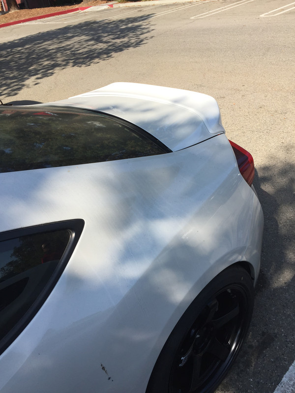

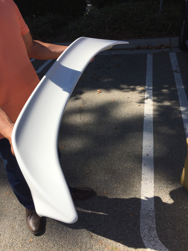

Haven't done too much work on the car lately! Just been driving it and enjoying it. The brake upgrade has made the car so much more fun in the mountains. One of my goals for next year is to have the exterior finished so I can enter the car in Wekfest. I've been going to Wekfest since it started in SF, so having a car in that show has always been a dream. I recently purchased a couple exterior parts that will help set the car part, and will compliment the aero package that I will be purchasing come tax season!

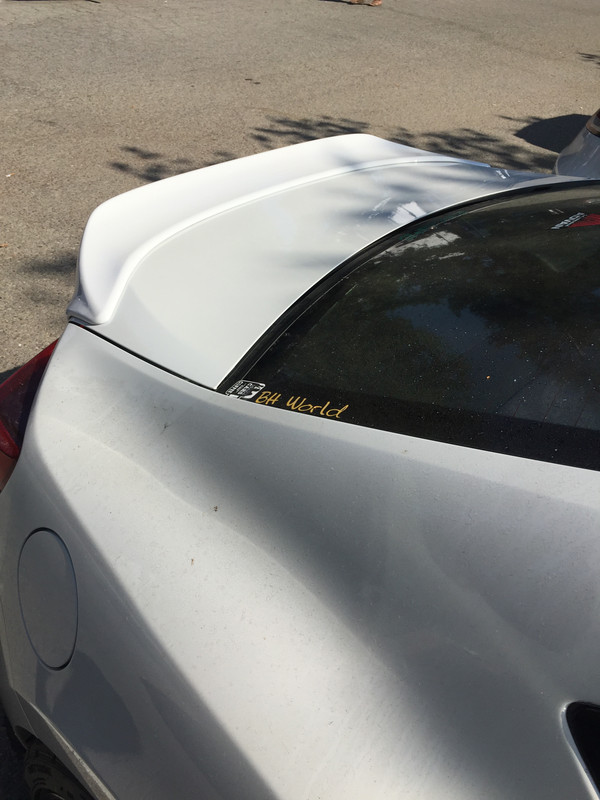

I decided to go with a TRD Style rear wing. This wing is really only temporary until I get the truck holes properly filled. I will be purchasing a Voltex wing down the line once my skill level at the track warrants it. But for now, this will be a nice addition and a huge improvement over the stock limited wing, which I hate with a passion.
I bought this wing off ebay for 140 shipped! Painted K1X. The color match is pretty spot on, and the wing is ABS plastic. It has nuts recessed into it, so if you wanted to drill your trunk and screw it on, you can! The only thing its missing is the trim around the edges the real TRD version has. I can live without that, as this wing is just a temporary solution. The install is pretty straight forward. I did take precautions on sealing the truck holes as best I could. I used a 1" vinyl spoiler plug sticker I found on ebay, and put one on the bottom, and one on the top in order to seal it nicely. I also followed up with some painters tape underneath just to be safe. It probably doesn't need it, but gives me some peace of mind.
https://i.postimg.cc/zftwyqbt/3904.jpg
https://i.postimg.cc/NMK6TZRg/3928.jpg

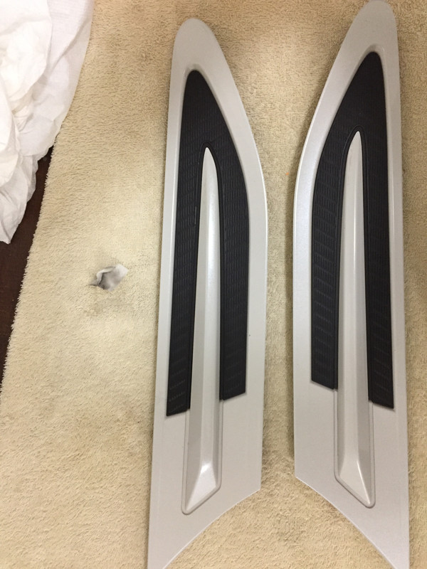

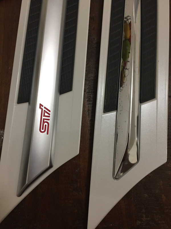

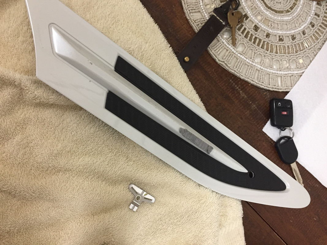

STI Fender Garnish

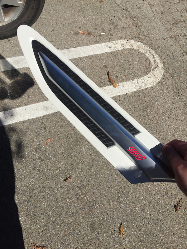

09/19/2018:
I've always wanted the STI fender garnish, but was upset it didn't come in the K1X color. I really don't like the new tS version that came out, so I looked into other options. After doing some research on this forum, it turns out that you can totally disassemble the fender garnishes! A member on here did the same with with WRB vents and it came out great, so I figured I would do the same. There was no write-up available, so I took lots of pics during the progress to create one for anyone else who wants to do this mod.
I couldn't justify spending 300+ on a part I would need to modify, so I waited until someone had a used set for sale.
Tools needed:
Heat gun
Fishing Line
Screwdriver
Drill + Drill Bits
3M Tape
Here's the STI Garnish. The color code is the Satin White, and not the Crystal White that I have. Too bad! These were in much better shape than my mine are.
https://i.postimg.cc/pTj9PvDn/4043.jpg
First step is to remove your stock garnish. They are attached with 3M tape right near the door, and then clips for the rest. I did not document this step, as I just followed a youtube video. Use the fishing line to brake the tape, then full off the panel. Be careful not to lose or damage the clips!
[ame="https://www.youtube.com/watch?v=yMkT1a_qY34"]youtube[/ame]
Side by side comparisons:
https://i.postimg.cc/qMx3tpWs/4045.jpg
https://i.postimg.cc/yNtgqxSH/4047.jpg
https://i.postimg.cc/bw6ST3yd/4048.jpg
https://i.postimg.cc/KYRksBjf/4049.jpg
https://i.postimg.cc/rsCKt9ZV/4051.jpg
https://i.postimg.cc/prtmTSZc/4052.jpg
https://i.postimg.cc/kMxVZnJ0/4053.jpg

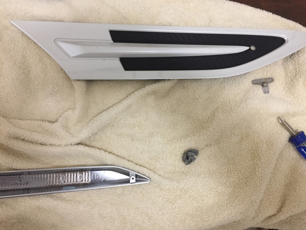

As you can see they are identical! even the part numbers are the same. The STI garnish is attached with a screw near the front, and 3M tape. The Chrome on the stock garnish is attached with just 3M tape.

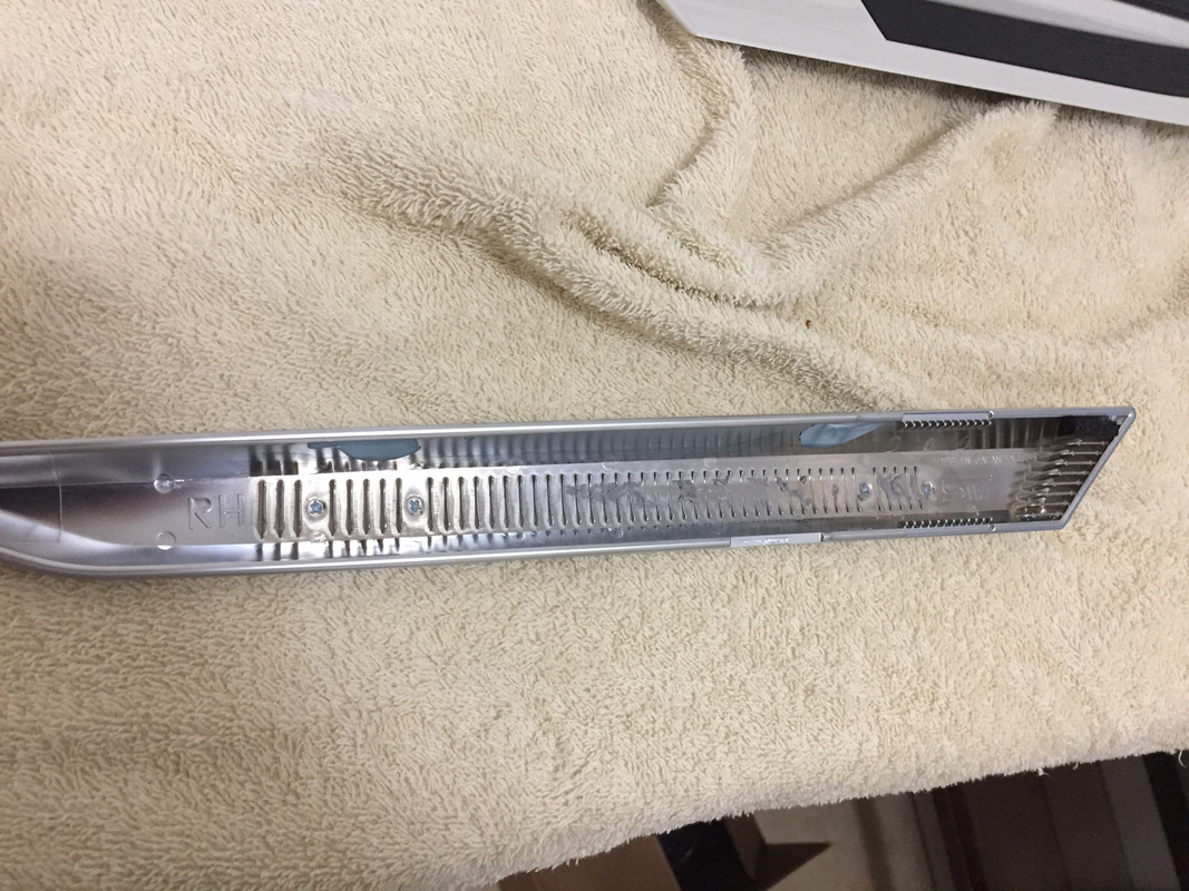

Now to disassemble. On the STI Garnish, remove the screw. Use a heat gun on the back side of the garnish in the weird valley thing. Heat it up nice and good and then use the fishing line to help separate the silver STI piece from the garnish. You will need to do this on all 4 garnishes. Go slow and take your time, that tape is on there good!
https://i.postimg.cc/zX7yz0Rp/4054.jpg
https://i.postimg.cc/yYsJCwWk/4055.jpg
https://i.postimg.cc/HkLVVXwm/4056.jpg
https://i.postimg.cc/dVSDd36y/4057.jpg
https://i.postimg.cc/6Qk3jPD6/4058.jpg
https://i.postimg.cc/9fR0B2gN/4059.jpg
https://i.postimg.cc/Y9QSJ3H6/4060.jpg
Use alcohol or goo gone or whatever else you need to clean off the residue from the garnishes. You will need to apply 3M tape to these surfaces so make sure they are nice and clean! You will also need to drill a hole in your original garnishes, but luckily it's already marked from the factory! and the weird Y shaped washer does a great job of centering your drill bit. I didn't bother to record the size of the hole. I have a drill bit set so just found whatever bit fit the STI garnish hole, and then started with a smaller one to pilot it. It's really easy since the hole is "marked".

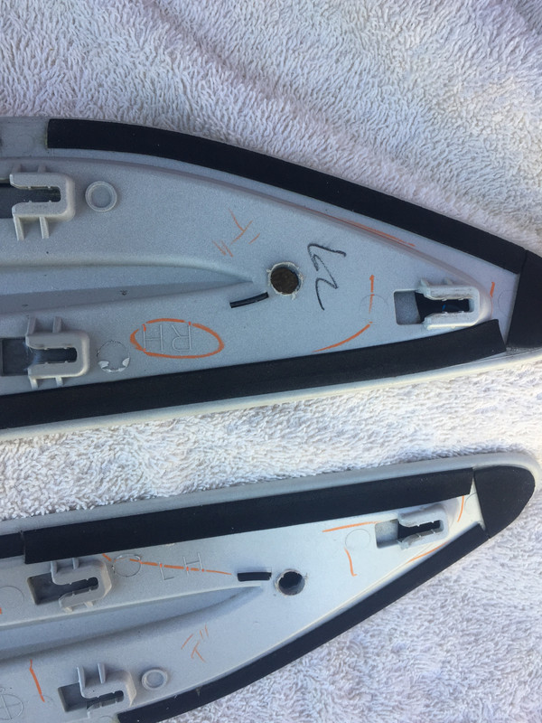

Reapply the 3M tape to the backside of the STI garnish in the same place. I had to cut my 3M tape into strips to match how it was from the factory.
https://i.postimg.cc/pX5nZD9B/IMG_0399.jpg

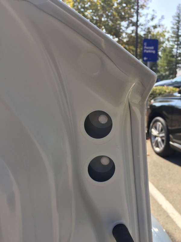

Use the newly drilled hole as a guide when laying the STI Garnish down. Make sure you put it on straight! Put ample pressure on the garnish for a few minutes, then reattach the screw.
https://i.postimg.cc/v8NVfPmB/IMG_0400.jpg
And there you have it! You're newly built color matched STI garnishes. Make sure to re-attach these to your car afterwards! Cut up some more 3M tape to match the weird triangle piece that the factory used. If you wanted to be extra, you can buy these 3M pieces from the dealer, but the price was like 9 bucks each. Not worth it!

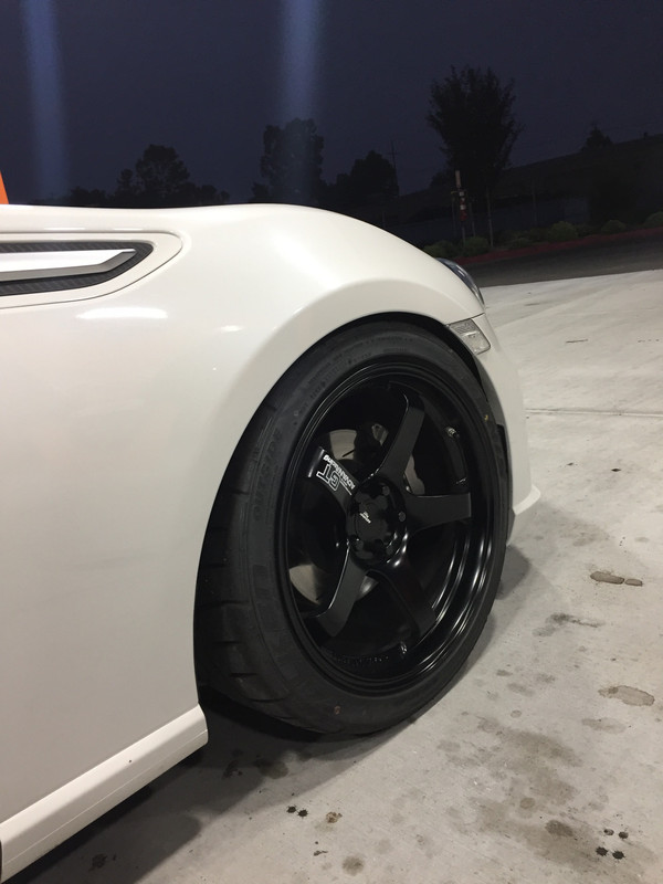

Elliotw 06-13-2018 12:02 PM
These Advan wheels are so money!! looking great.
TylerLieberman 06-13-2018 12:33 PM
Very cool. Advance GTs with meaty tires is such a good combo for these cars
JeremyR 06-13-2018 05:59 PM
Thanks guys I appreciate it!

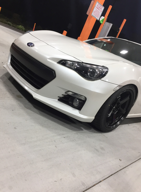

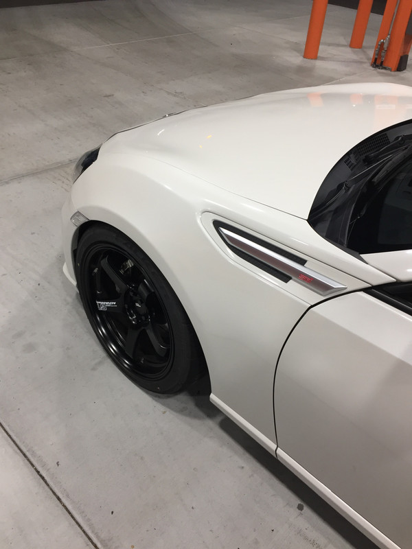

Advan GT's are probably my favorite wheel behind blitz 03s and TE37s.
I'm enjoying the grip from the 265s but I do get some rubbing up front at full lock, enough to rub through the undercoat/paint to bare metal on the inner fenders/rails. I've got some rack spacers from Verus that will reduce the turning radius a bit. (The drifter in my is crying, although i'm building this car for grip so it's not a total set back)
I'll be installing those and touching up the underside of the car by the end of the month so i'll have more updates in a couple weeks or so.
Clipdat 06-13-2018 06:05 PM
HHNNNGGGHHHHHHHHHHH!!!!!!
http://oi303.photobucket.com/albums/...tz03wheels.jpg
Originally Posted by JeremyR (Post 3098605)
blitz 03s
JeremyR 06-13-2018 07:32 PM
UGH yes!! so good hahahhaa.. honestly they look good on everything.. such a clean look without being overly flashy. Not great for a grip setup, but for a nice street style car or even a drift car they are great. I would say stance too but I really hate that scene so I wont.
i remember that guy from my zilvia days! pwrmves14 on IG :party0030:
spike021 06-13-2018 07:38 PM
I'd say out of all the twins I've seen IRL so far, yours with the Advan GT's is the best. Those wheels are awesome.
Sometimes I wouldn't mind having a set, but then I remember I'd never be able to keep them clean/unblemished though. :sigh:
JeremyR 06-13-2018 07:43 PM
that's my biggest fear.. i'm crazy careful around curbs and driveways, but even that isnt enough some times.
it does help that I don't daily the car, if I did that yeah they'd probably be wrecked by now :/
