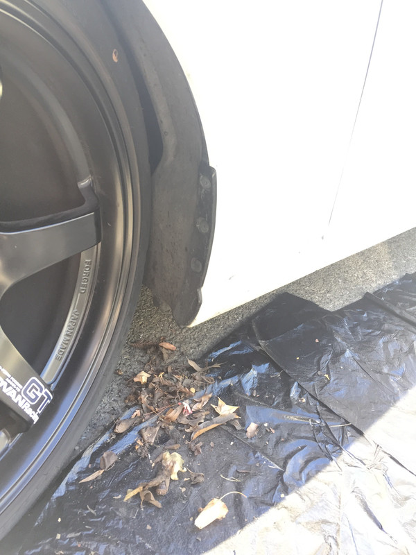

Side note: cleaned all this out of the bottom of the fender/fender liner
I'm hoping this was the cause so i don't have to pull the door panel off.

Went on a drive yesterday. Dirt in fender was not cause.

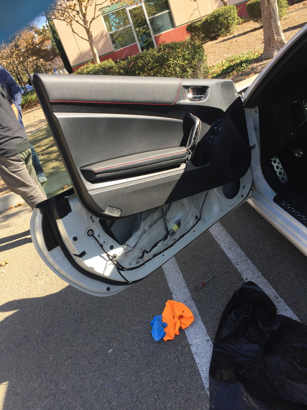

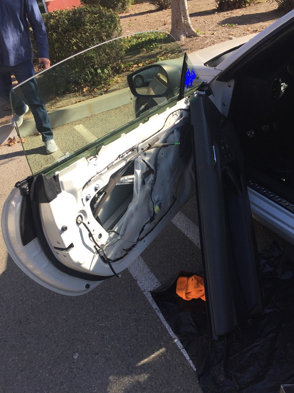

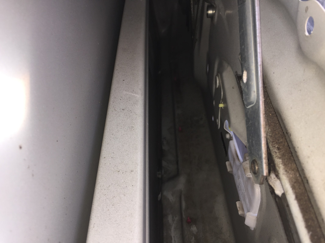

Ripped off the door panel today. Couldn't find anything in the bottom of the door, even took the speaker out to reach the front.
Only thing I ended up with are cuts scrapes and that nasty black glue that holds the plastic in place. I hate messing with doors.
Took off the bottom panel to see if there was a way to reach the floor board, but the carpet is stapled to the plastic. I'm not about to rip up the entire interior looking for this damn noise so I think I am defeated.
Maybe the noise is something trapped under the black paneling underneath the car? but I really doubt I would be able to hear that driving the car with the windows up as clear as I can hear this noise.
Something must be rolling around in the rocker panel, but how do you even access that?
