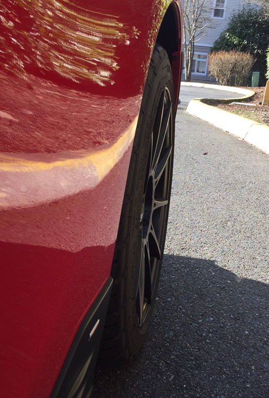

@86TOYO2k17 Would you be that kind a post some photos of that setup? I want them in 17x8+45 in black but I am hesitant since I never seen them. The OPs photos due to angles does not look as good as I hoped.
Sorry, never notified me of post.
This is an older pic, if weather and time permits I might be able to take another at different angle if you like.

Thanks. Do you have 225/45 tires? Do the rims have a bit of concavity or are they totally flat face? Can you make a photo in aligement from front the car to see the poke/inset? Thank you again ))
Yes 17x8 +35 offset 225/45r17 wheels.
They have very slight concave maybe 1/4” at the very center but not much. Few more pics I just took.

Looks good! Thinking of going with the same setup this year. Wheels are on closeout right now at Tire rack FYI
