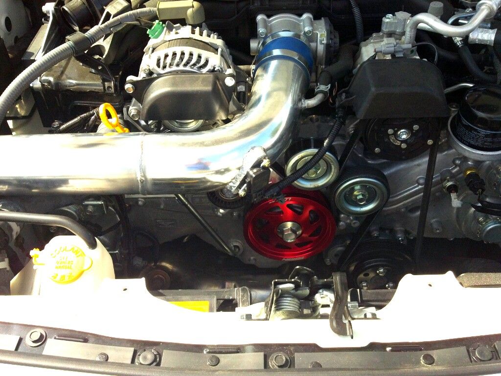

Installed. Company23 tool helped greatly. $50 shipped directly from web site. Took a little more than 30 minutes on the 6AT because I took pictures. Was 'VERY' easy in my opinion.
Top notch quality Perrin!
Here's the pix:
Awesome thanks for doing that!
Company23 tools are super helpful for installing these and a must have for shops. At the same time, for a manual car, they are not necessary.
For the auto customers it would be a good idea to have these tools, but I have installed them before using the small port on the engine (behind the manifold) and a pry bar. That is an easy way to do it for those who do not have the tools.
Thanks again for the awesome post and pics!

Buy the tool, don't scratch up the pulley.
